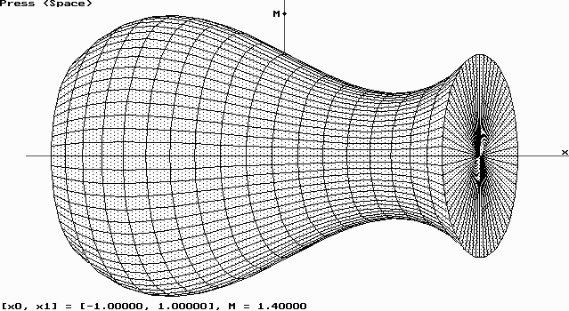

and btw it isnt that hard to find areas and volumes folks, go look up BASIC MATH on google. the only reason you should ask how to find a volume in an internet post (and still not a reason) is if the object looks like this or something...
cus then it's time for your *** to go back to calculus class..
