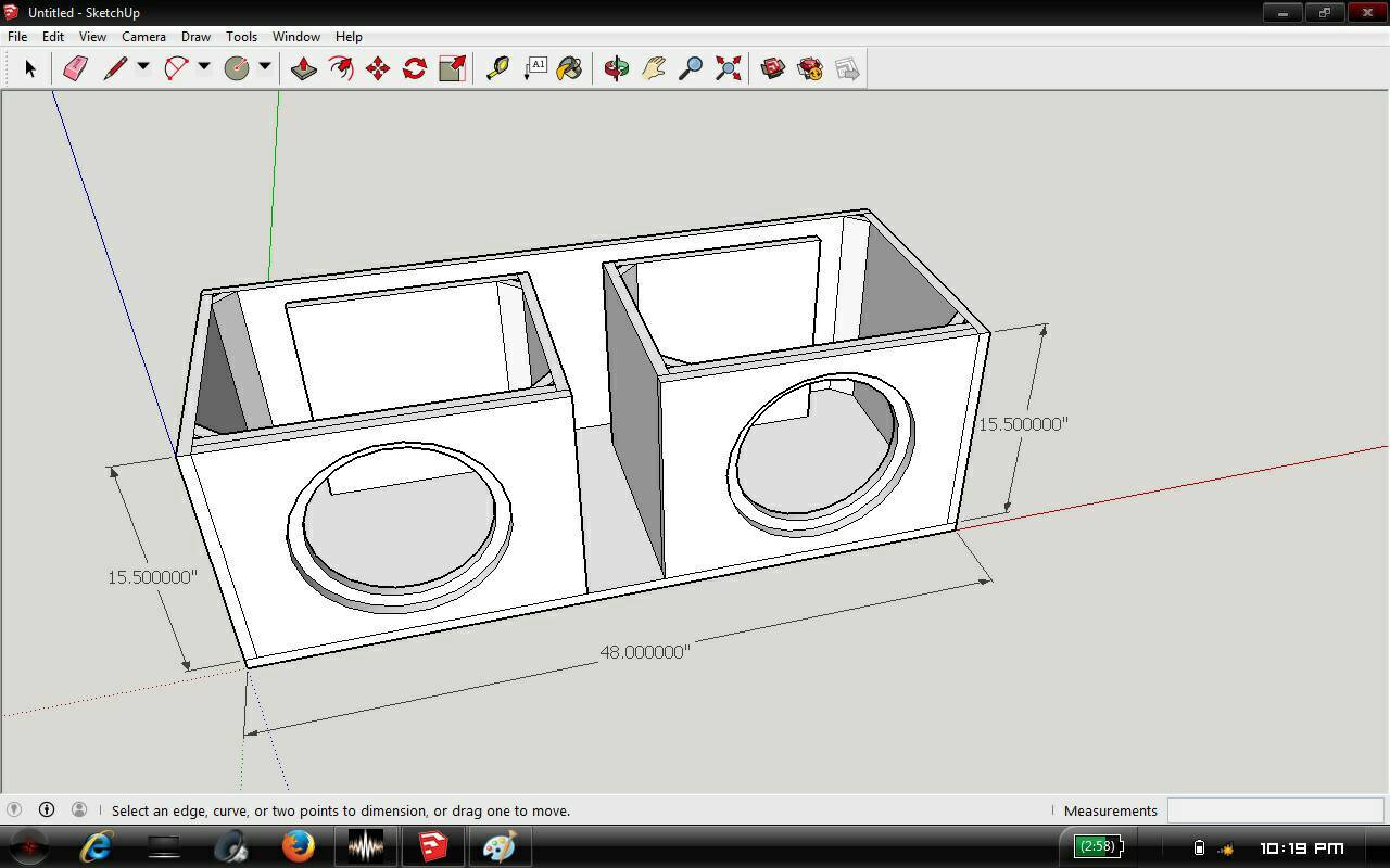

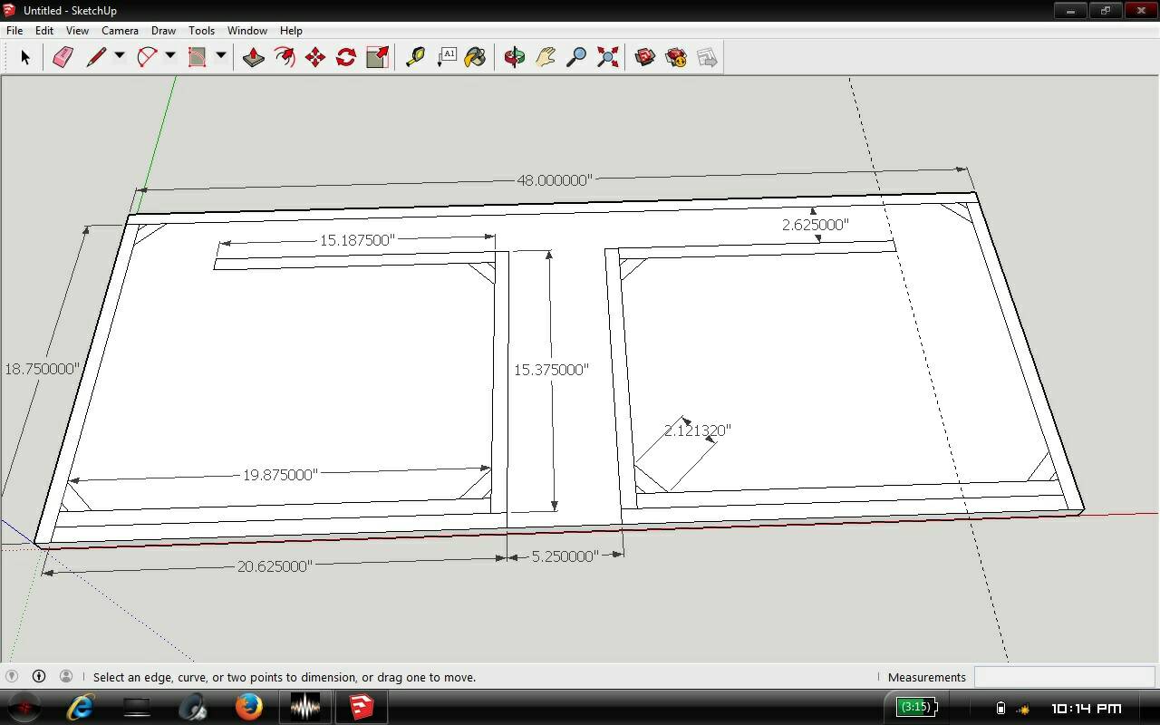

Post your max dimensions and I'll hook you up with a design. I ran a gcon 12 for awhile and it really impressed me.
Sent from my SM-G925T using Tapatalk
Hey thanks man. I have 48" wide and 17" high that I'd like to use all of. Then I have 36" deep to work with. What do you think about a 4th order box?
I would just do a regular slot ported box for them, they're going to get loud af in an suv
5cuft@30hz with 16.75sqin port per cube. It's gonna get down.
