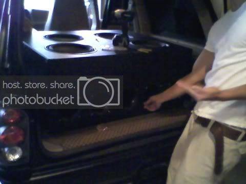

here was my 4 12'' type r setup. powered by 4 bxi2607ds.

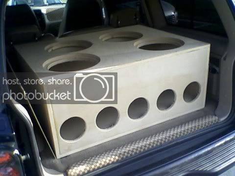

here is one of my friends setup with 4 12'' rs. powered by 2 bxi2006d's. 7.5 cubes net @ 35hz.
your going to want something like the second setup for daily. you need another amp also. run each amp at 1 ohm nominal. 7 cubes net. 5 4'' aeros seems to work good for daily setups like this.

Thanks, Im looking to run all 4 off one AQ2200D @ 1ohm....550RMS each
