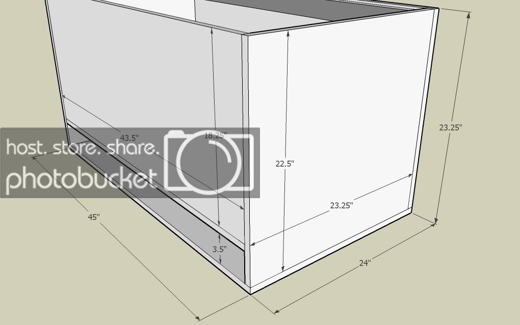

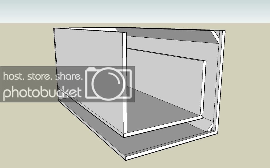

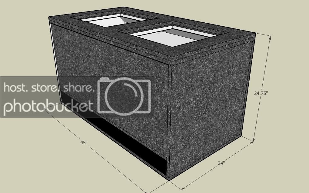

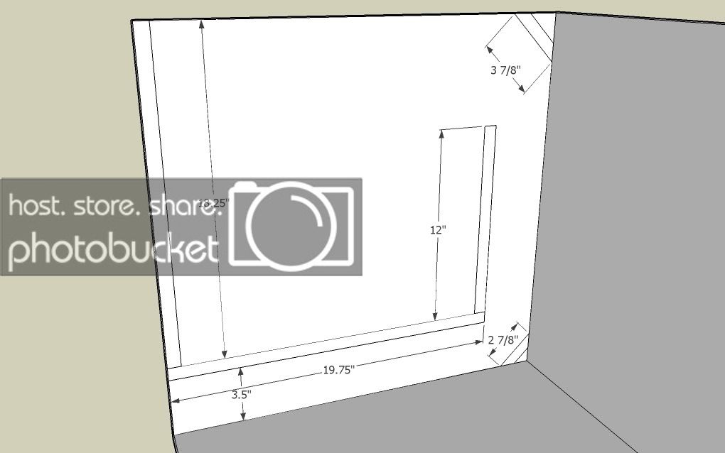

Just practicing some sketchup
Bam...//content.invisioncic.com/y282845/emoticons/smile.gif.1ebc41e1811405b213edfc4622c41e27.gif
Specs come to:
8.393675 net
32Hz tuning
152.25 sq inches of port area
Any Q's just let me know //content.invisioncic.com/y282845/emoticons/smile.gif.1ebc41e1811405b213edfc4622c41e27.gif
Yea, you could rotate the box etc. to see if you gain but I would stick with port back...and you could send me some money if you feel like it (djrpioneer@sbcglobal.net = paypal) but it isnt needed //content.invisioncic.com/y282845/emoticons/smile.gif.1ebc41e1811405b213edfc4622c41e27.gif
That enclosure should get things quite loud I would think //content.invisioncic.com/y282845/emoticons/smile.gif.1ebc41e1811405b213edfc4622c41e27.gif...d@mn you people with all of this beautiful space to work with //content.invisioncic.com/y282845/emoticons/biggrin.gif.d71a5d36fcbab170f2364c9f2e3946cb.gif
