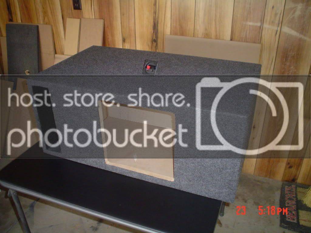

i built a box for one of those before for another member here.
