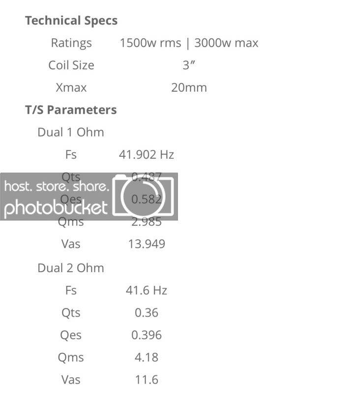

4 10" CT Sound Meso
The box will be in a blow thru in an Avalanche. So subs & port (would ideally like a center slot port) would be on the same face forward. That must be 49" x 20" to fill the blow thru area. LOW tuning please. Right now I have 2 15" in 10.5 cubes @28Hz. 30Hz is the highest id like to go with them please.

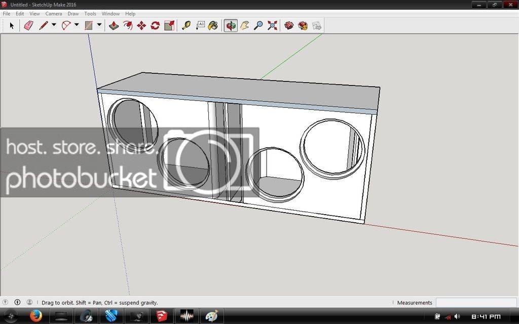

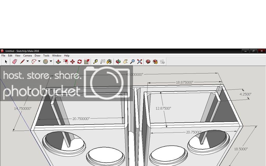

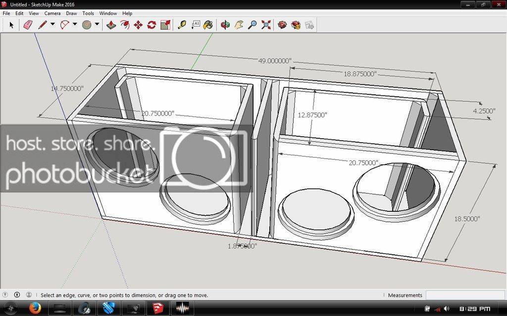

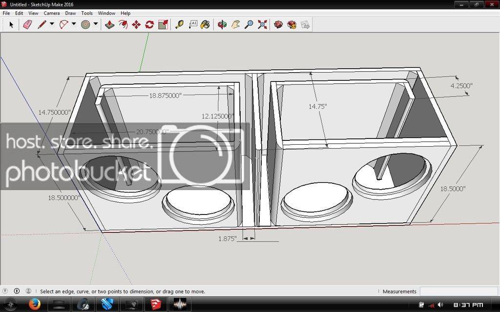

I can do a much better design by using a beauty panel and making the box shorter. I'm not too crazy about the port width/height ratio
Sent from my SM-G900A using Tapatalk
That looks great, thank you. A lot shorter depth wise than I thought it would be. That's pretty much what I was looking for. I'll be putting a beauty panel on it to secure it to the truck & locks when all is said and done. What was the final cubes & tuning by chance?? What do I owe you for this??
Sorry, I thought I listed it. 2.06cuft@30.16hz with 16.82sqin of port per cube. Should do pretty well. BTW, that's after all displacements.
I've had a long week. That was per side/chamber, so each sub will see just over a cube each. I can make it a little larger of you'd like, but will work **** good as is. You don't owe me anything, just post pictures of the build lol.

It's completely install dependant. The 4 10's would have a s**t ton more motor force than the 15's, and should handle more power.
