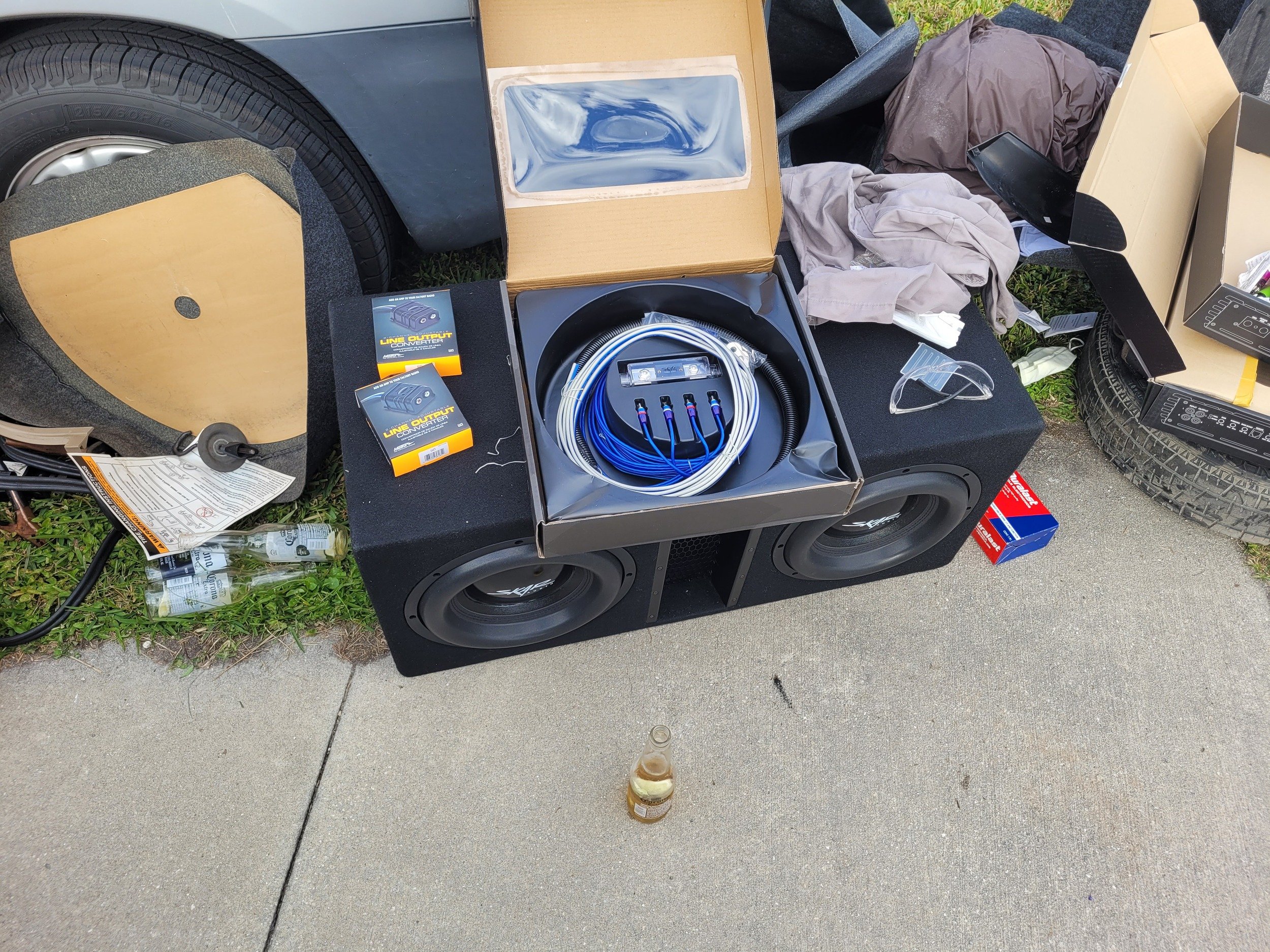

Hello, I recently purchased an audio system for my 2001 Mercury Grand Marquis.
This is what I have:
SKV2-2500.1D | 2,500 WATT MONOBLOCK CAR AMPLIFIER
SKV2-100.4AB | 800 WATT 4-CHANNEL CAR AMPLIFIER
DUAL 12" 5,000 WATT EVL SERIES LOADED VENTED SUBWOOFER ENCLOSURE

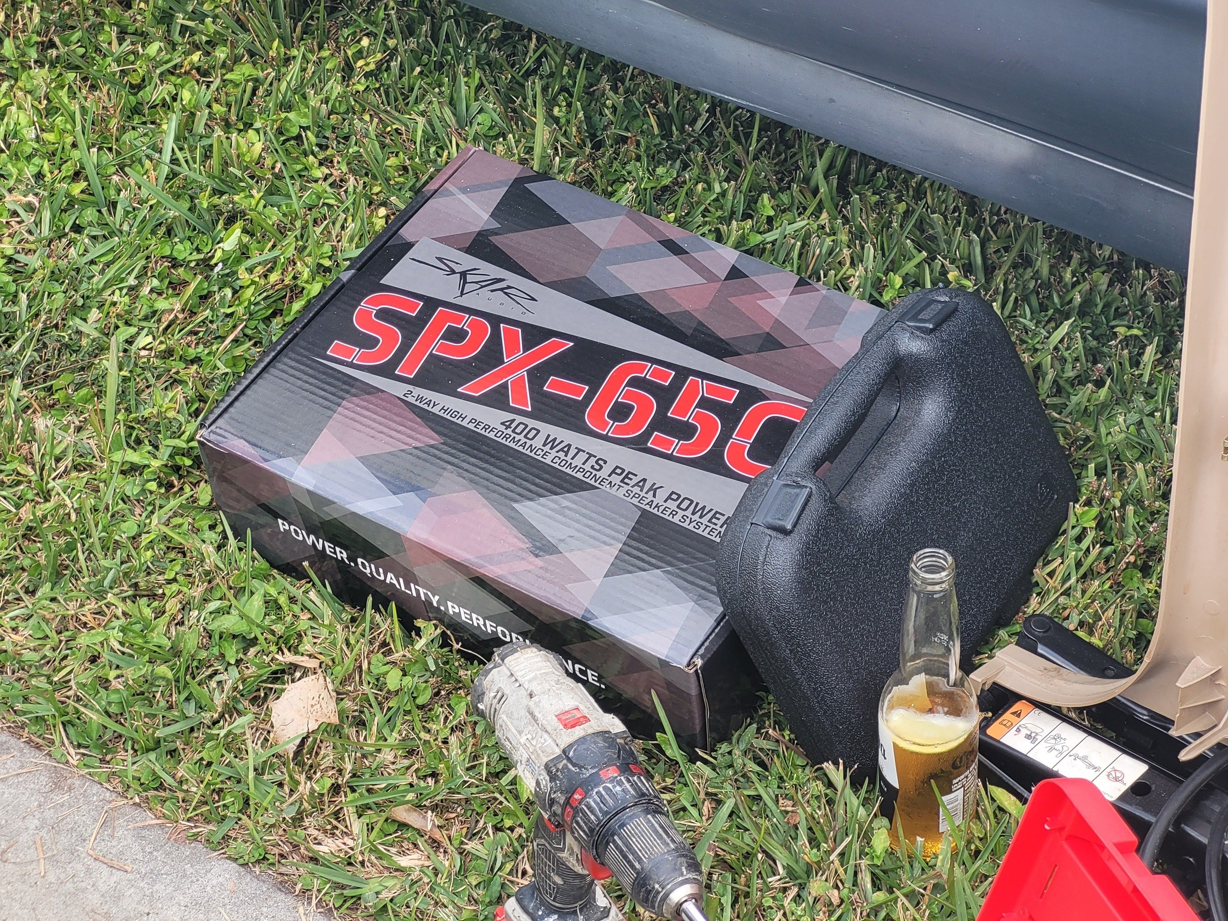

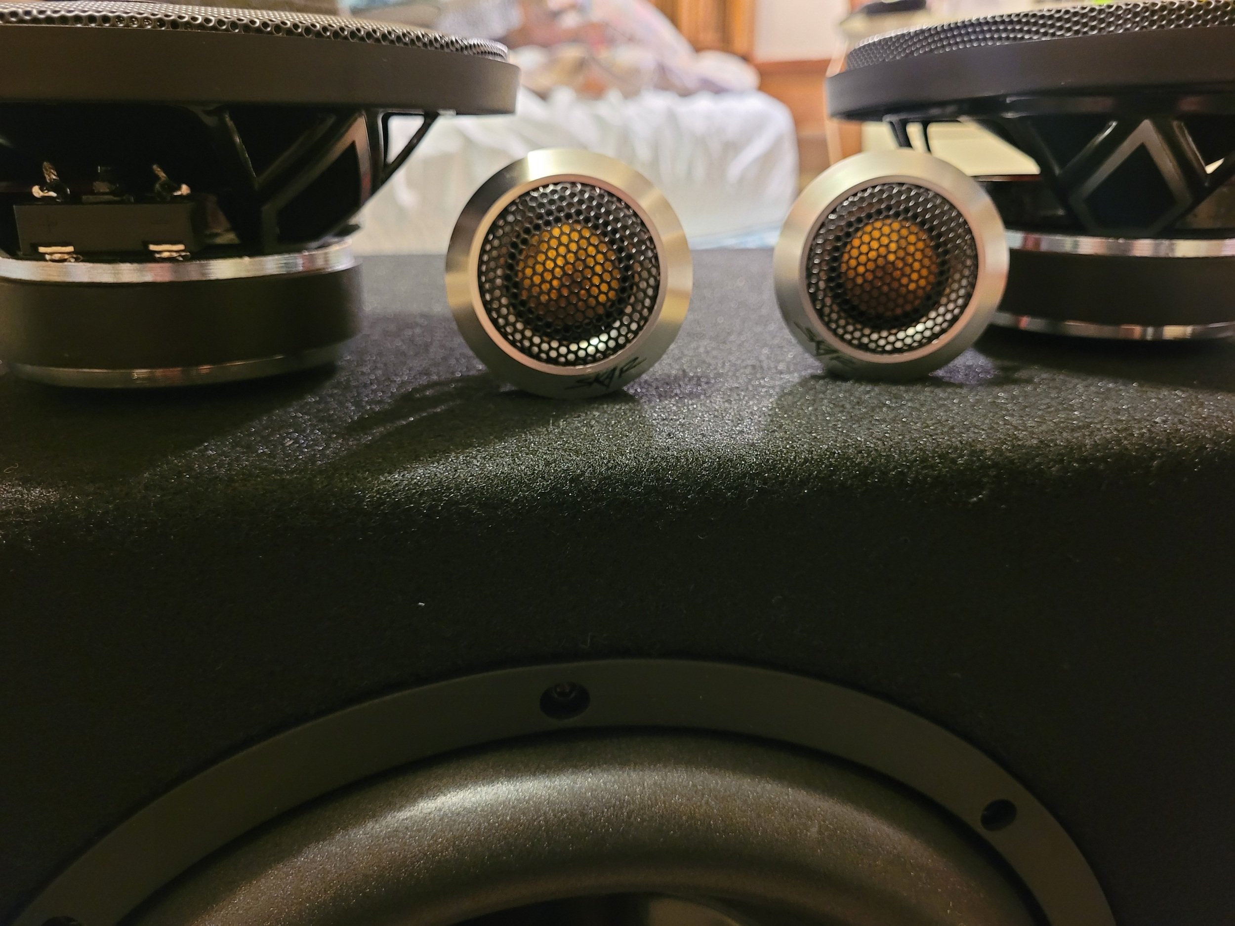

SPX-65C | 6.5" 400 WATT 2-WAY COMPONENT SPEAKER SYSTEM

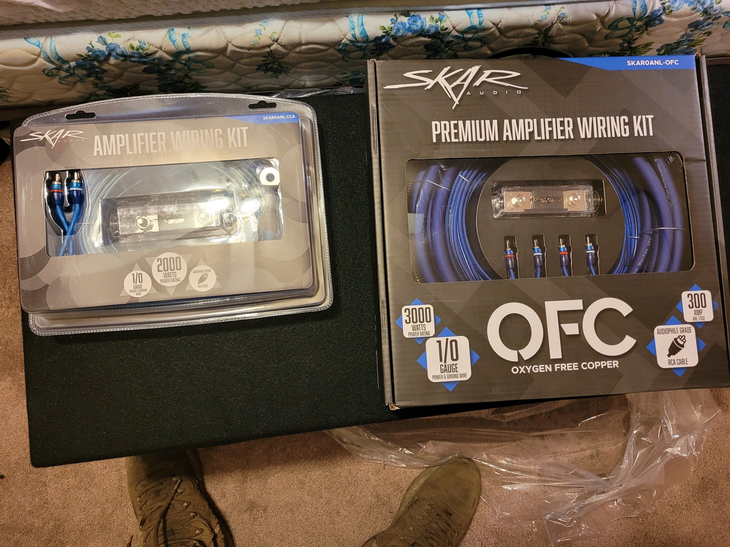

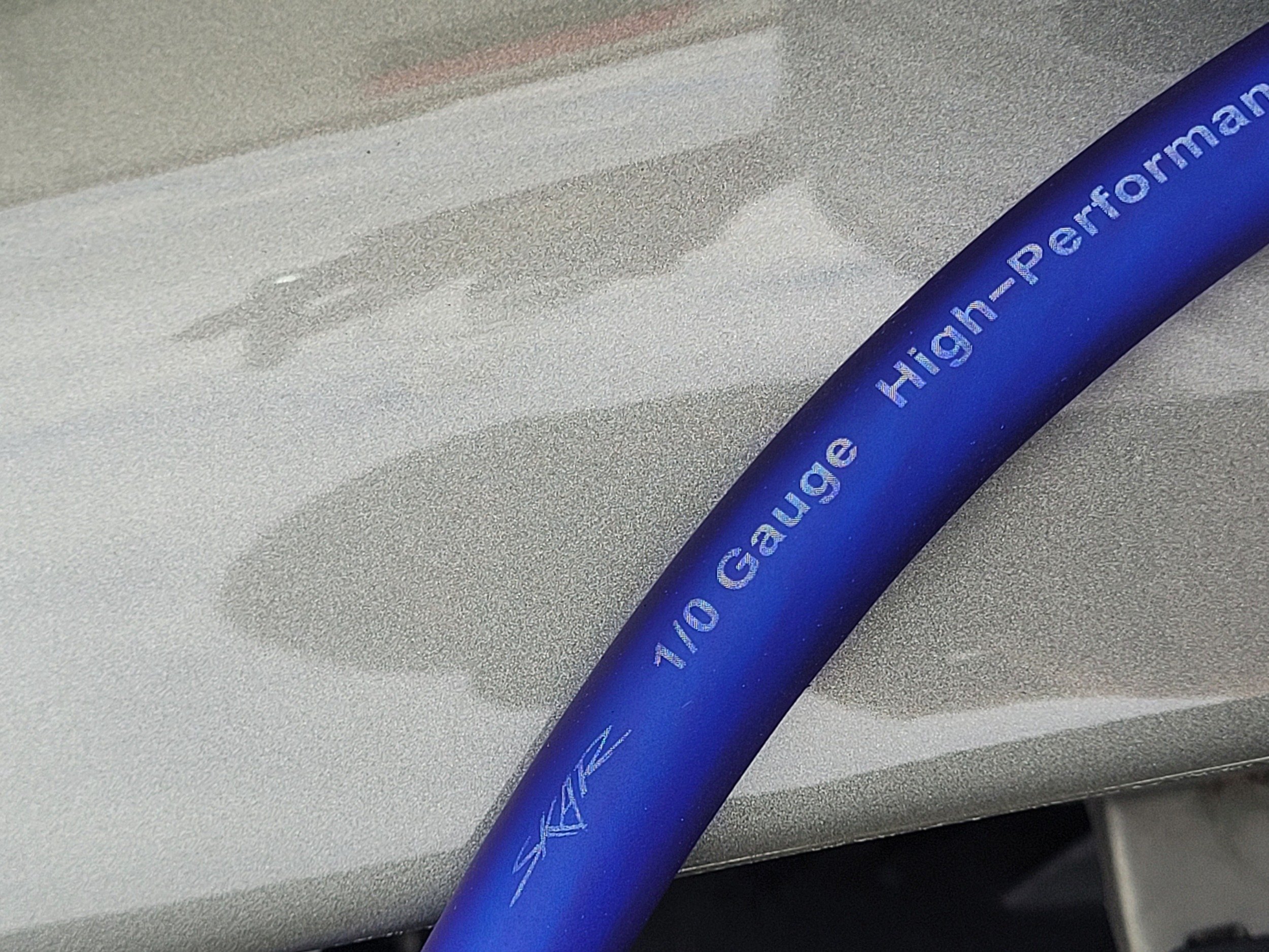

I also have 2 amp wiring kits. 1/0 Guage. One is 3000k watts and the other is 2000k watts

I would just use the 3000 watt wiring kit and split the power wire to both amps. The 2000 watt kit is cca. Copper clad aluminum.

Yes, there are. but regular wire works fine if you just crimp some ends on.

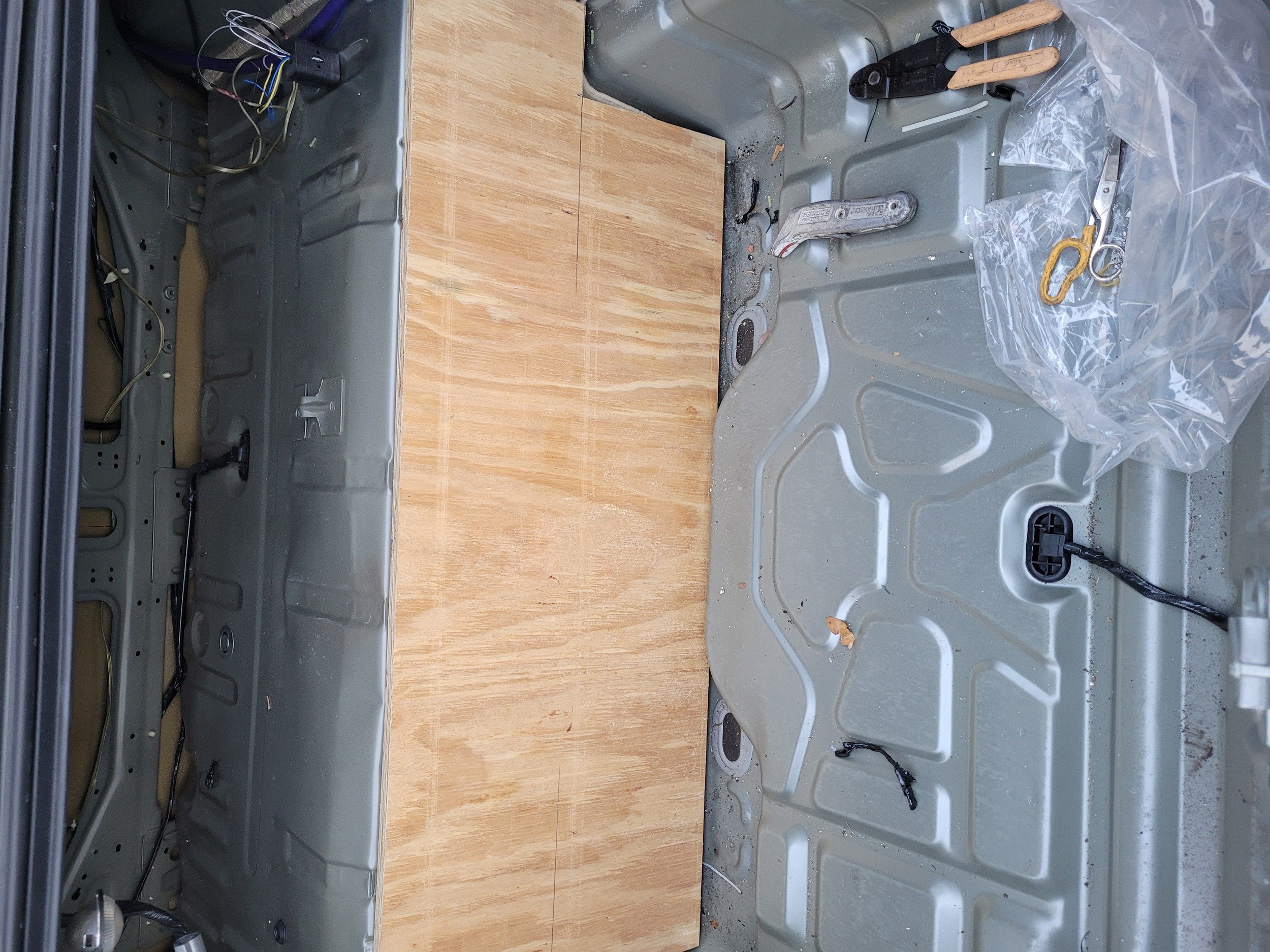

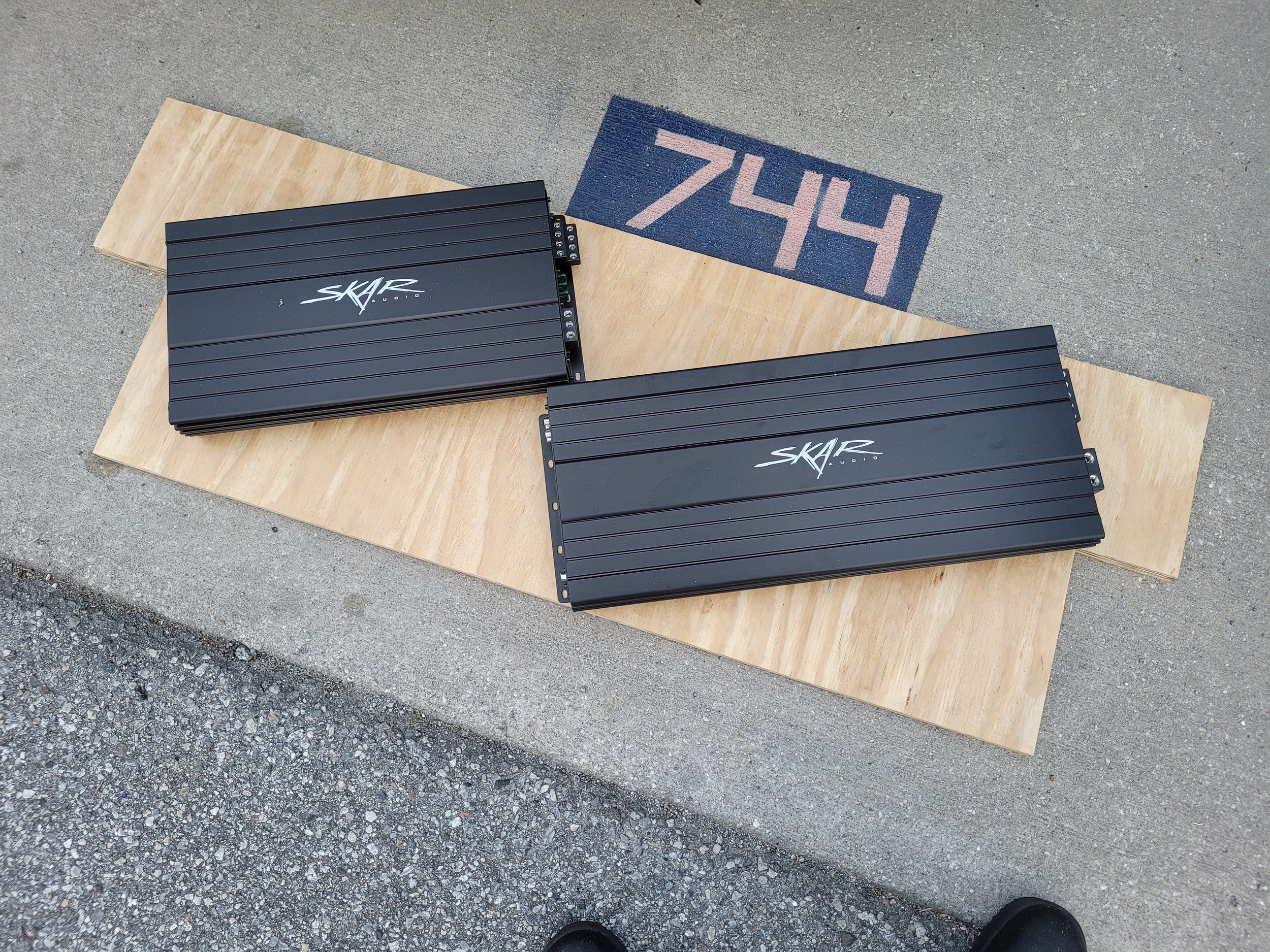

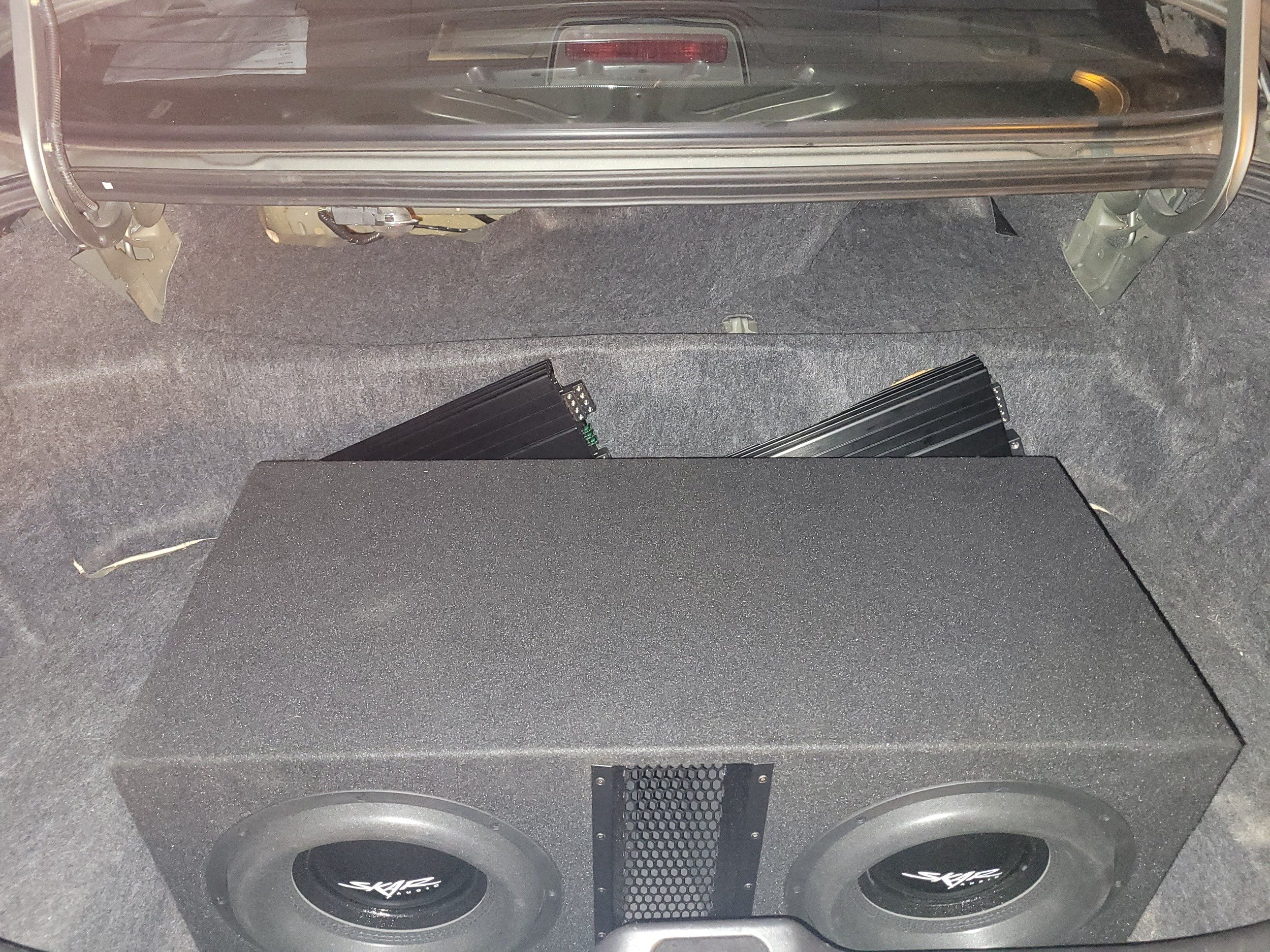

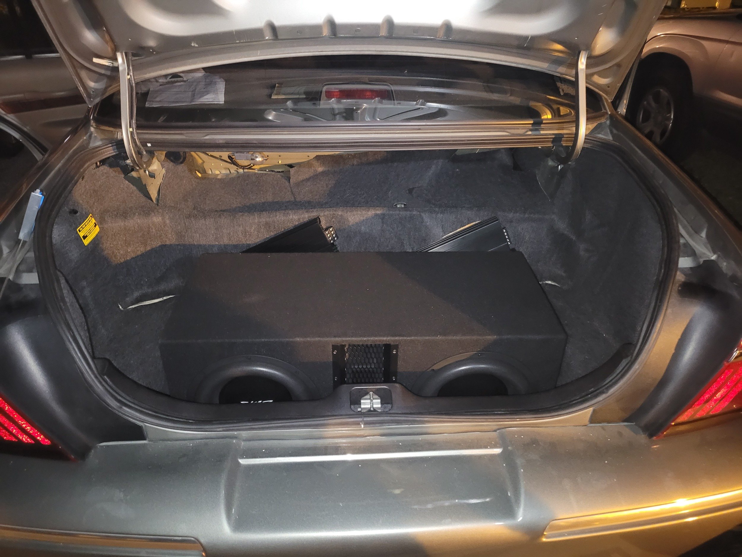

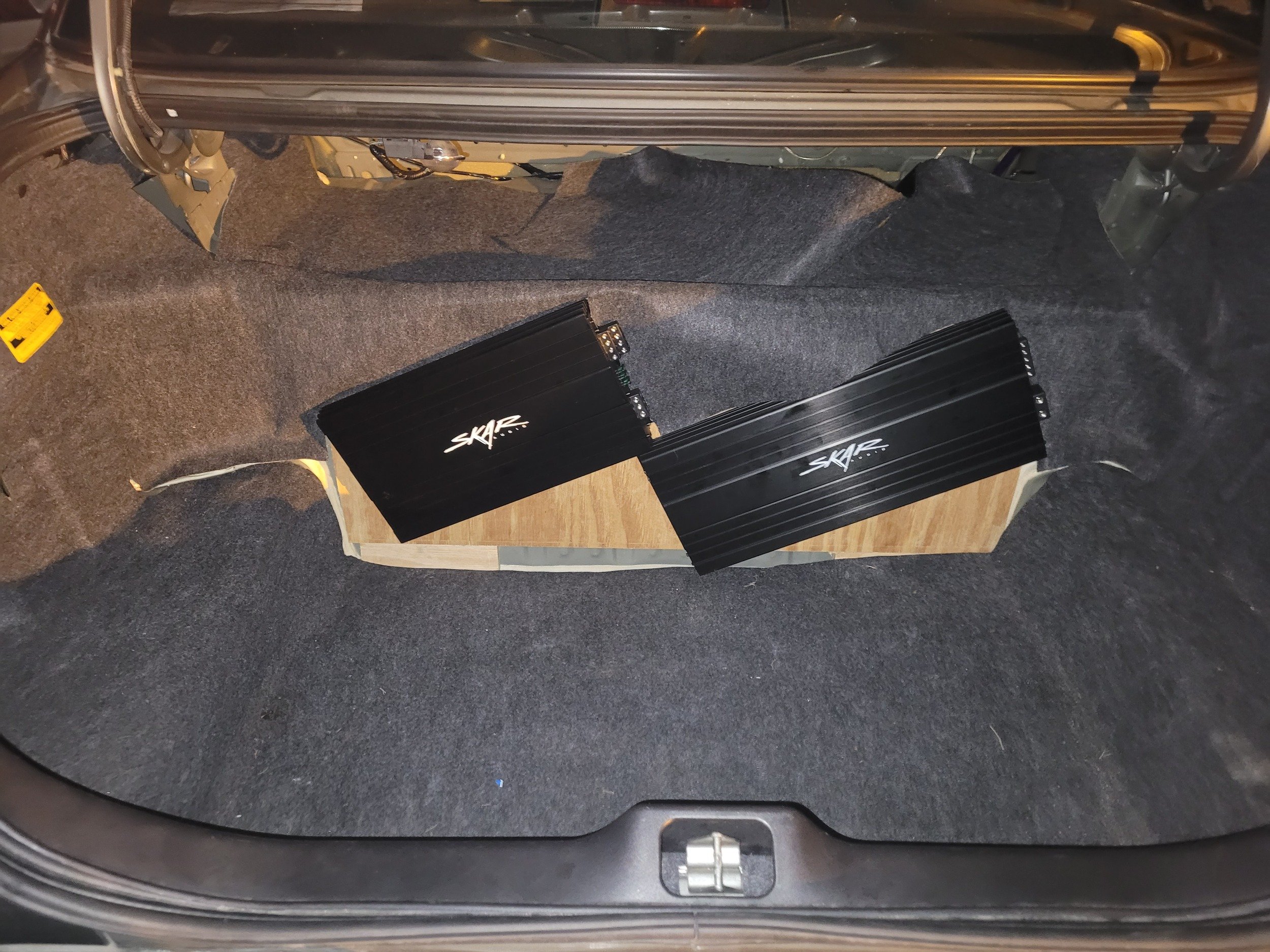

I have not upgraded my battery or purchased a second one just yet. Yesterday I had my wires ran. The 3000w 1/0 Guage amp kit from scar. I had some plywood cut to somewhat match the wall in my trunk. And mounted both of my amps to it. I have my woofers in the trunk as well. I'm actually hooking my subs up completely stock. No headunit, no battery, no upgraded alternator.
I decided to do what you mentioned and just see where I'm at. I have to do some modifications because the 6.5 component speakers system I have won't fit as is so my 400 watt amp won't be hooked up.
I think my subs are too close to the front, but the way my amps are mounted and the wedge of the bottom of my box I can't push it back anymore. Hopefully it isn't that big of an impact but I feel like I've lost some breathing room. Not sure.
I know I definitely need to get a headunit, I'm trying to find the right one. I know I will need to get another battery, but I think I'll be okay for now. Until I can get it all done right I won't give the system much play time.
also, I am going to do the big 3 upgrade at the same time. I'm probably jus going to use the 1/0 Guage power wire I got in my.other amp wiring kit.
so I'll be stock with the exception of my big 3 upgrade. For now anyways.
