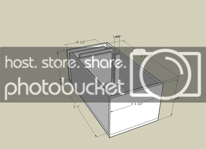

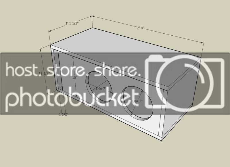

need a quick design for 2 8"S
Normally i wouldnt fold the port like i did but itd be **** near impossible to get that port in a straight piece.
Here it is.
1 cube at 32 htz.
Cuts:
Top and Bottom: 13.5x28"
Sides: 10x13.5"
Baffle: 10x25
Back: 26.5x10
Port Pieces: 10.5x10" x3 10.5x1.5" x1
