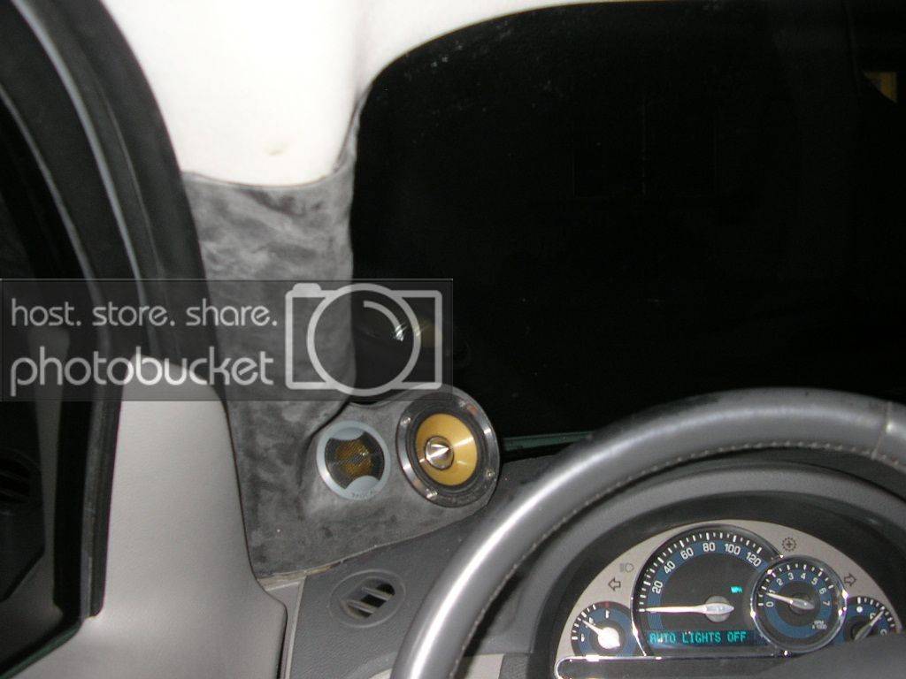

i love this (sorry i take your picture)
and for midrange,i want put below the tweeters

i want liket that picture.

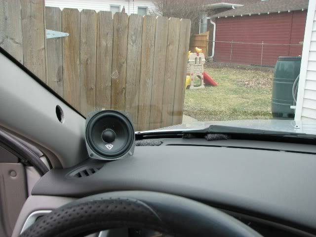

this is what i wanted to do for 4" mid placement
this was pretty easy to make

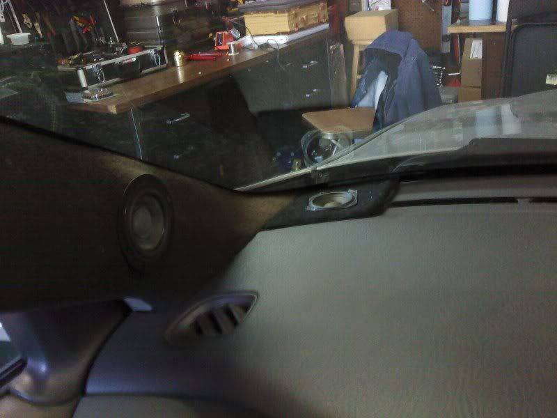

i've tested both apillar mid and dash mid
apillar mid with dash tweeter worked out decent - apillar tweeter off-axis results in a loss of high frequency detail unless you have the right tweeters so you want to aim them back

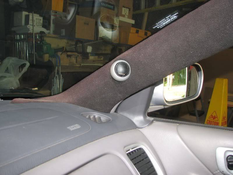

this is that i want..mid in the a pillar
because my mid only 2.5 inch
then i want put the tweeter above the midrange..
