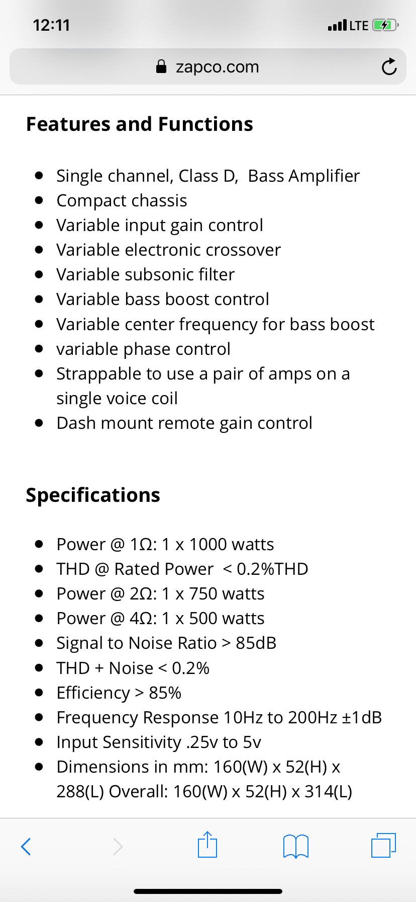

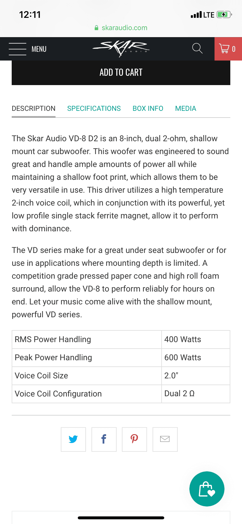

Hey, I currently have a zapco st-1000xm II amp from my old car build that I had two 10”s on. I now have a 2016 f150 and am looking at making a custom under the rear seat box and need a little help finding good subs to match with my current amp. Would if work for me to run four dual 4 ohm SKAR VD-8 8” subs (600W max power) wired in series parallel with my zapco amp that does 750W at 2ohms? Any help works thanks -mike
