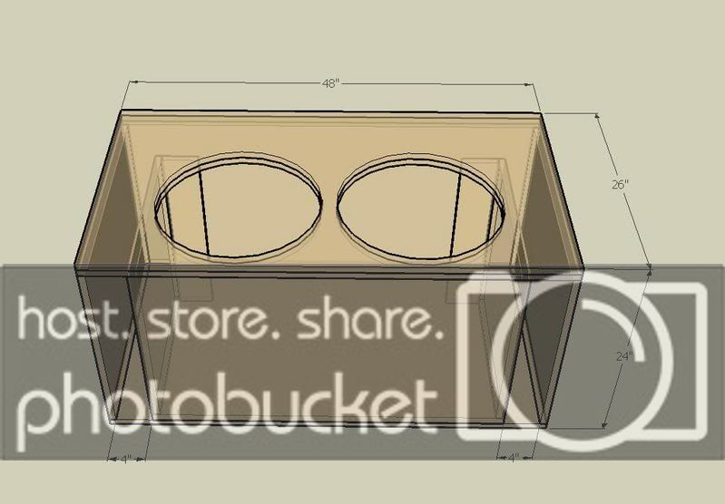

I drive a 2002 ford expediton. I have 2 18" BTLS, 2 RF 30001bd amps. Im need a sweet box designed for me that has a slot port on each side of the box for cool looks and so i can install my batts between the ports. My Max Dimensions are 24H x49W x 27D. Looking to tune to around 33hz or so. Please acount for 2 2x4 from the top to the bottom for bracing and 2 2x4 from front to the back for bracing. Subs up and port back.Also the top to be double baffled and flush mounted for the sub to flush mount.

No problem man, I think that you will be able to work with what I have put together.
It's HUGH, but has room for you to do your thing;)
mr_kebo
This is based on the upper end of the specs for Fi
10 cu/ft @ 32.50 - 33.50 Hz w/ 180 sq/in port !!( I gave .30 cu/ft for bracing, which is not included in the drawing)
Let me know if this is what your looking for...
thats going to be tight with your dimensions, like I stated, the best your going to do per single chamber:
Net Volume: 5.45 cu/ft
Tuning Freq: 33.12 Hz
Port Area: 88.13 sq/in
