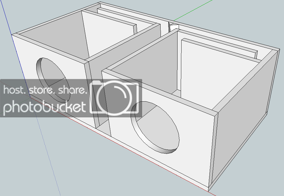

one i did a while ago. .75 each at 33. not trying to steal business, but figured i would show ya.
Y U TRY TO TAKE MY CUSTOMERS?!
i didn't want any money, I wasn't doing anything important so i drew it up

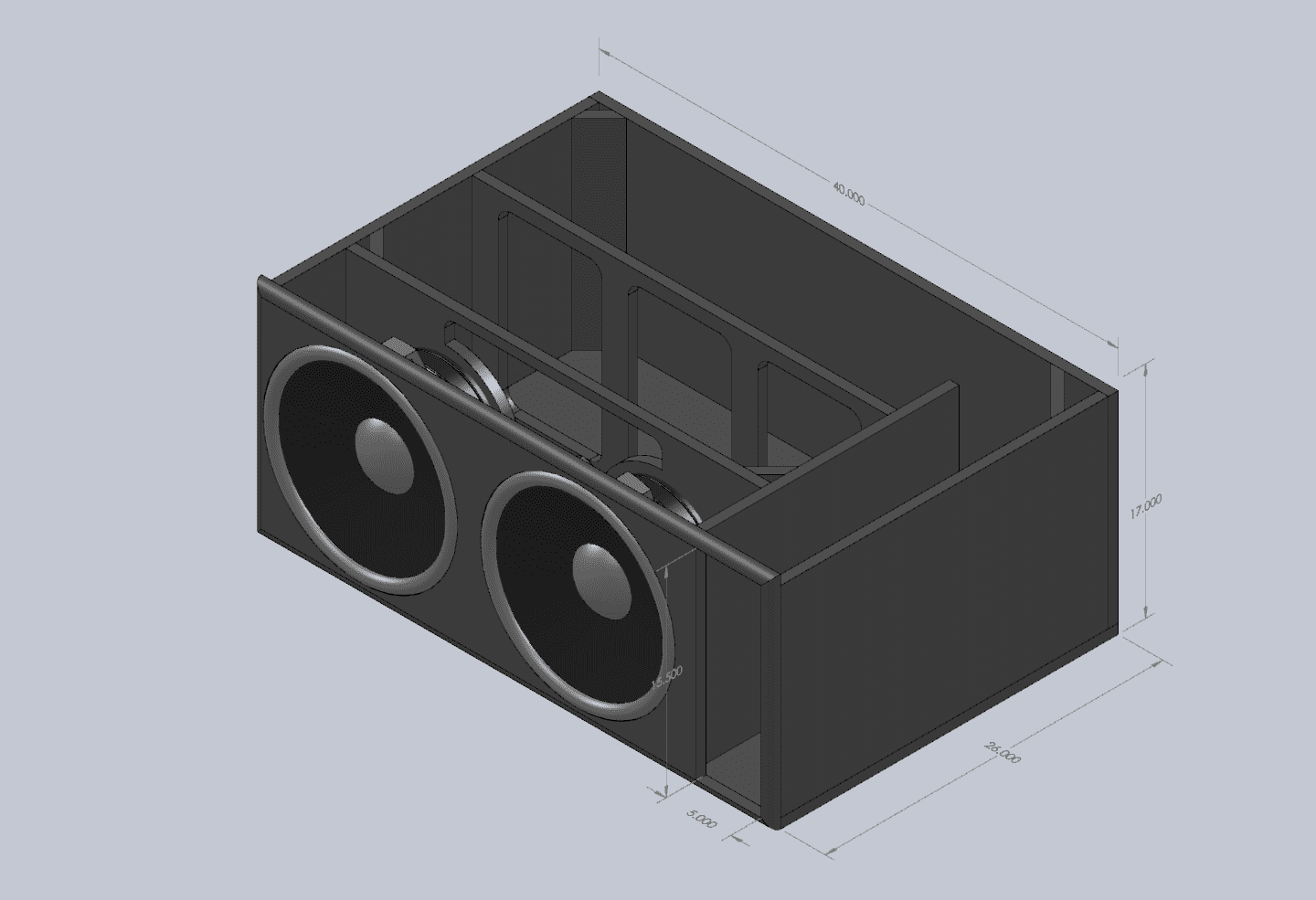

i love center port boxes but they look like they're a little harder to make //content.invisioncic.com/y282845/emoticons/frown.gif.a3531fa0534503350665a1e957861287.gif
its not too bad. you just have to split the port width in half and finish the length that the center run didnt cover on both sides.
you also have to remember to account for wood displacement, especially when tuning low with long ports.
What I always do is I figure out the cubes, draw that box, and add the port on behind the box, then all you have to account for is driver displacement and and bracing you choose to add.
I've done a few in the 1.25-1.5ft^3 range with a 32-35hz tuning...seems to work well.

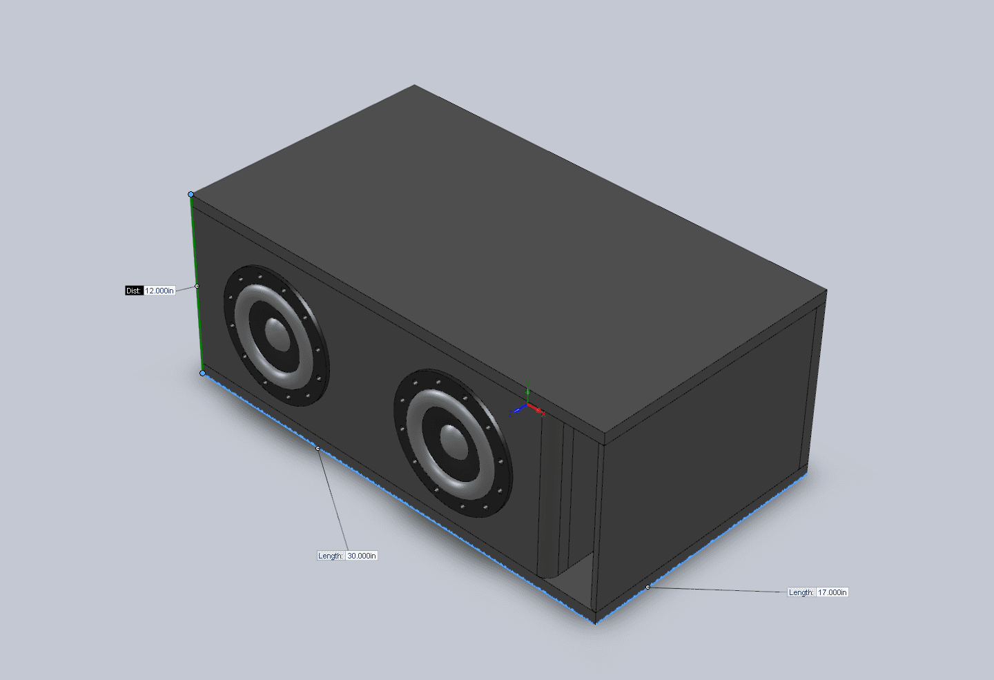

It's 30x12x17, btw
