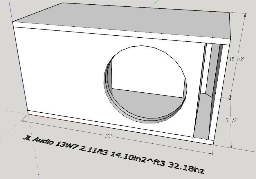

Need a box design fo a jl 13w7 ported

What's the best sounding box for a jl 13w7 ported with a jl 1000/1 amo
Want it the sub and amp to do what they do best. Get low bass nice sound quality. Not a ton of box space. Something that will hit hard and be punchy in a 2008 jeep grand Cherokee. I listened to 9ps r and b , rap , country, jazz , blues

I'm not really designing at this point as I've got less time to spare as of late... I do have a 13W7 box already designed but it's not really a space saver at 2.11ft2 net around 3.2ft3 gross 15.5h x 30w x 15.5d ... it's tuned at 32hz so If interested PM me.

This the thing... (had to dig it up and put it in Sketchup)... it was for a 1000/1 amp as well... not a lil' box either... but should get low and still be punchy as well.
