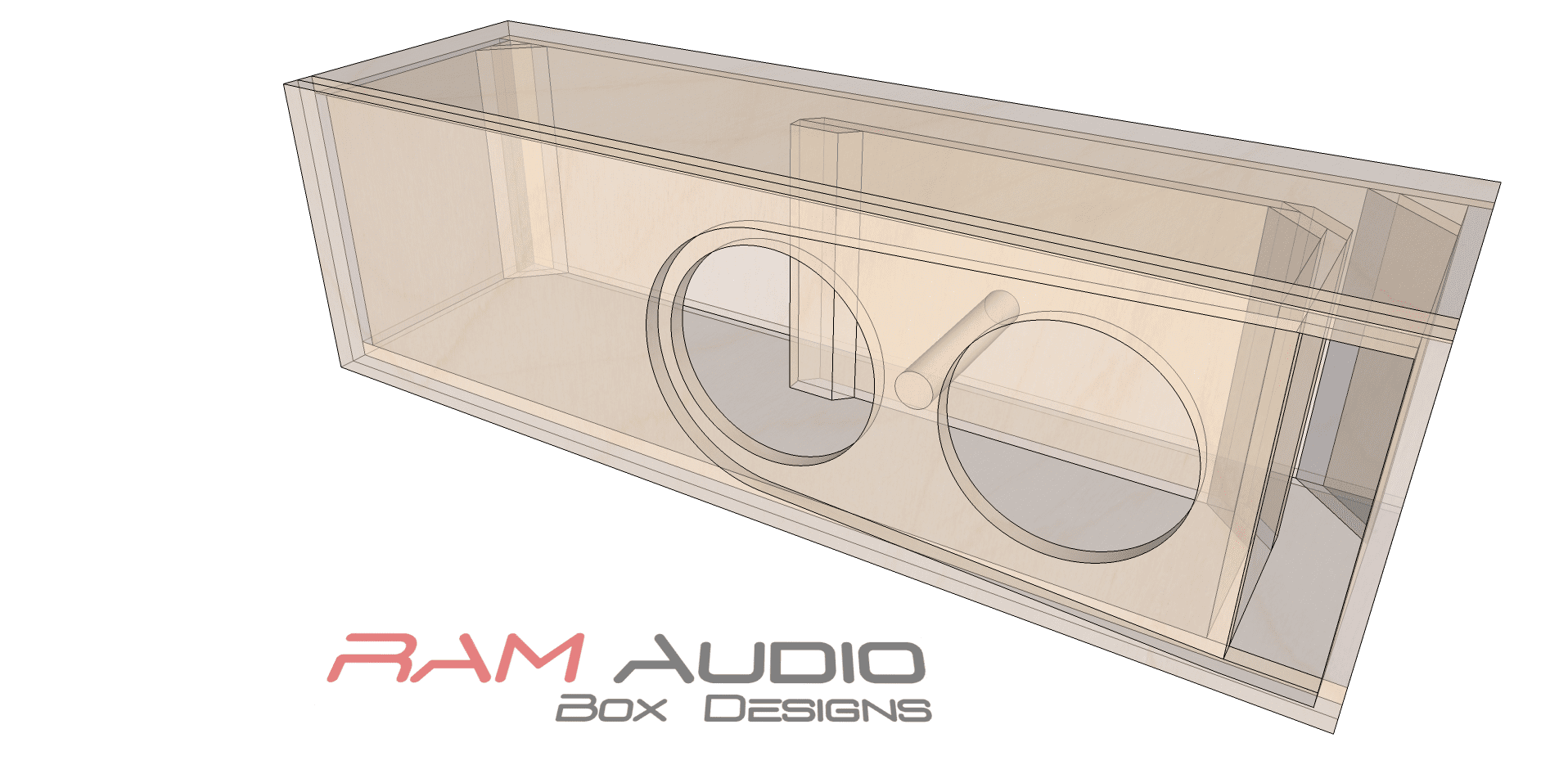

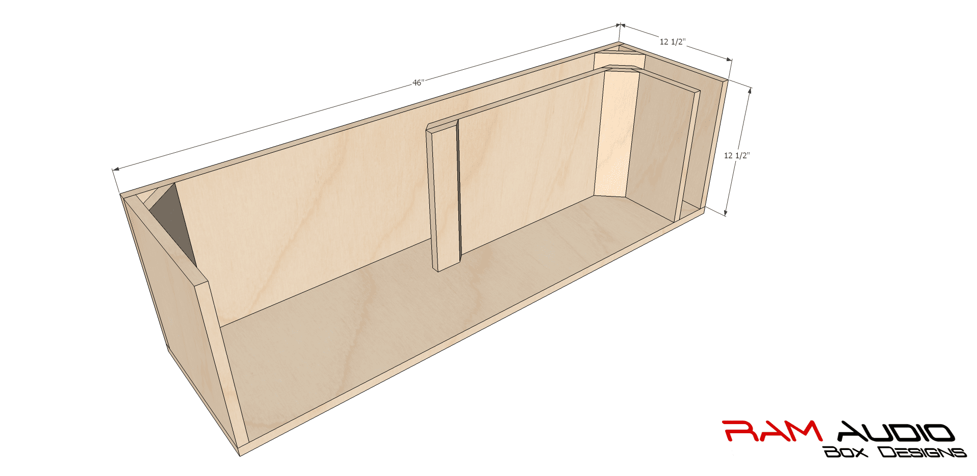

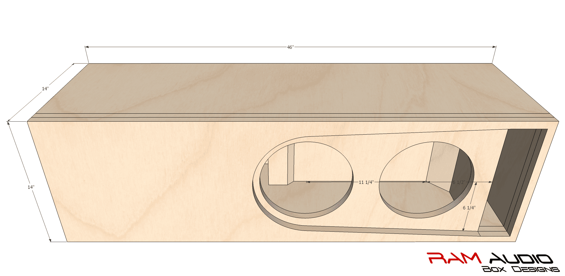

I had a pair of W3V2's that did very well ported, My favorite 10's I've had to date..
A dude named Ryan on this forum designed the box 11 or 12 years ago..
