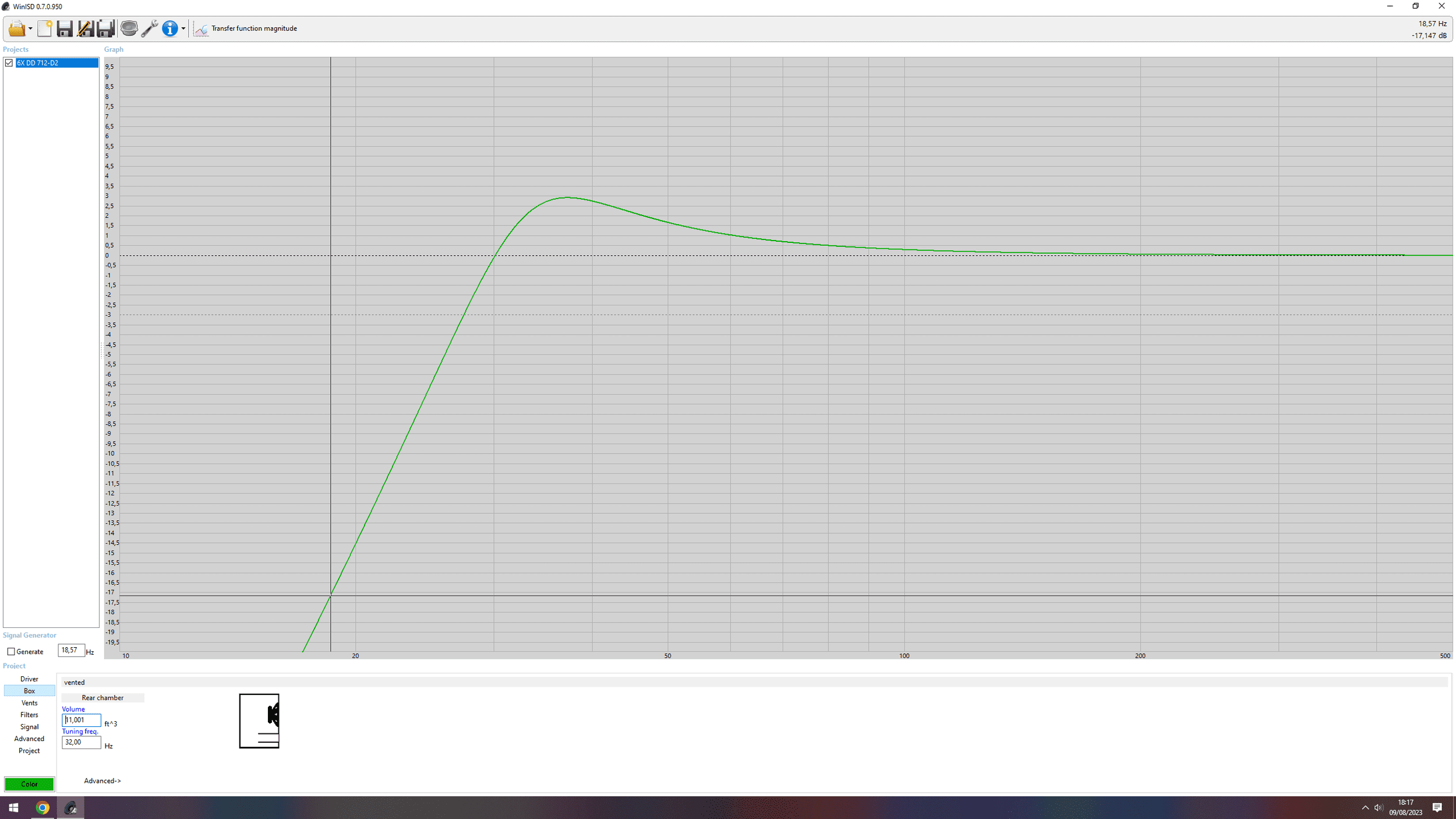

Ok i go for 310 liters (11 ft3) tuned at 32.
This should give me the right bass from 40 to 55 where EDM bass is and the F3 is at 27hz so it can go decently low
That should be good for you. I think even tuning down to 32 is not going to be necessary to handle any of that sort of music you'll use, but tuning higher is going to be very peaky. Ideally I'd try to aim for a way to test 36-38hz tuning then try 42, then try 32 and see which one suits you best over a variety of your favorite tracks. You will be able to play a fair bit below your tuning frequency so 32hz tuning will play down to around 27 right fine and 42 will handle 37 comfortably.

Ok then 11 cubes will be fine. Keep in mind the f/s of those woofers is about 28 hz, so you if you tune really high above that, the woofers can be more likely to loose control/bottom out the closer you play down to the Fs. Make sure to check your cone excursion in winisd, but realize that’s not always accurate, either. Just play around with it. You can check the Cms too to help determine that.
