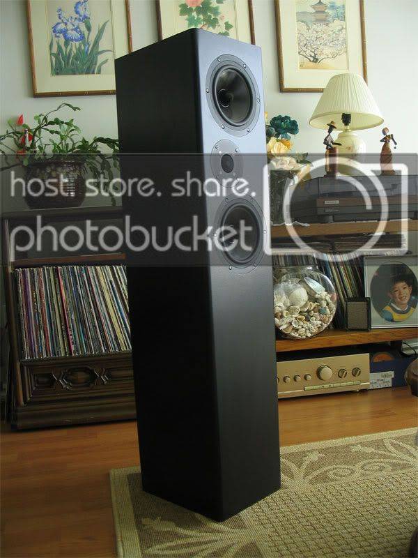

Just got my PE order today to build a pair of Nat P's and an RS150 center. Both MTM setups using Dayton components. EP2500 amp will drive 2 12" w6v2's sealed. Ordered an onkyo 706 yesterday and should be here within a week or so. Now I need to start building the cabinets and hopefully get these all done before we move into our house. Gonna start the xo's probably tomorrow.

Built the crossovers for the mains already. Hopefully get to HD tomorrow and get some mdf and start building.
It was pretty easy since I just followed diagrams and pics. They aren't 100% finished but pretty close. Just got back from HD with some mdf. Hopefully the rain/snow holds off for a bit so I can get started on the cabinets. Oh and they are dayton drivers.
