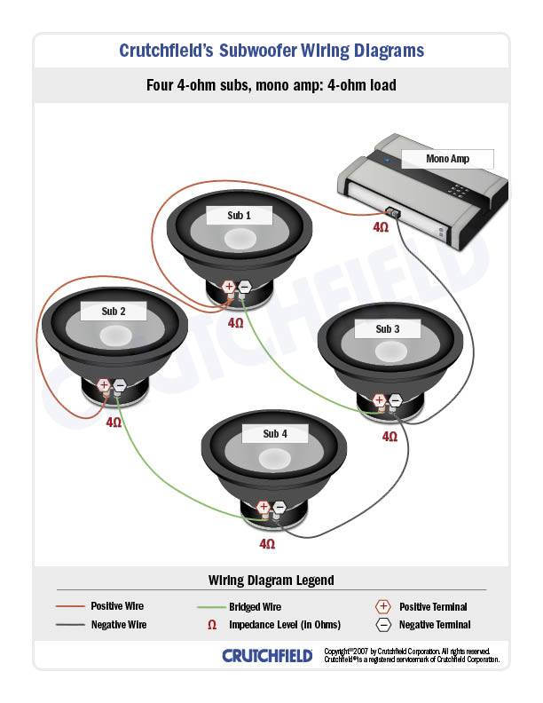

//content.invisioncic.com/y282845/emoticons/laugh.gif.48439b2acf2cfca21620f01e7f77d1e4.gif wtf. im bout to go get baked. good luck on the choice of amp OP. that old school US 2000 or 2000x is a nice one, jsut old school so u would have to gander for that one. im sure these guys will throw some more suggestions your way. but just so we are on the right path........these are 4 ohm dual voice coils correct? if so, maybe even an audiopipe 3000 at 2 ohms bridged?? it would meet your budget and is a decent amp
My bad in the first post. //content.invisioncic.com/y282845/emoticons/frown.gif.a3531fa0534503350665a1e957861287.gif The 10W3V3's are single voice coil drivers. Should have written -4 instead of -D4.

so u are gonna have to run 2 ohms a channel with a 2 channel amp or 1 ohm which u didnt want
jbl bpx2200.1 //content.invisioncic.com/y282845/emoticons/fyi.gif.9f1f679348da7204ce960cfc74bca8e0.gif
Thing is amazing
this is a nice suggestion. my uncle has a 700 watt jbl and the thing sounds amazing for only 700. that jbl definately puts out rated power and it sounds like it will work with that u need. if im not mistaken, that 2200 does full power at 4 ohms bridged or 2 ohms a channel correct?
Are you saying you would not suggest this wiring scenario?
The JBL is rated at 1100W x1 at 2 ohms. Your suggestion leads me to believe the rating is accurate and the 275W per sub would be adequate.

Back to my original post....at 250w per sub at 4 ohms, is the JL 1000/1 a realistic option? The damping factor is over 500 with that amp, so I'm told the SQ should be very good. Again, I'm an admitted noob and always trying to separate fact from fiction in the car audio world.

Your mistaken. look at post above^
Thanks. Took a closer look at the specs and, of course, you were right.
650W x 2 at 4 ohms
2450w x 1 at 4 ohms
Sounds like a monster of an amp. Probably too much power wired into 1 channel. The 650Wx2 option looks very good.
Oh and also to the OP, I wouldn't send 500 RMS to those w3v3's
400each in sealed should be more then enough

You can do 4 or 1 ohm mono. There are plenty of good
1500-2000w 1 ohm mono amps out there. Sundown SAZ 1500
used is a good choice. Assuming these are actually four single 4
ohm woofers.
