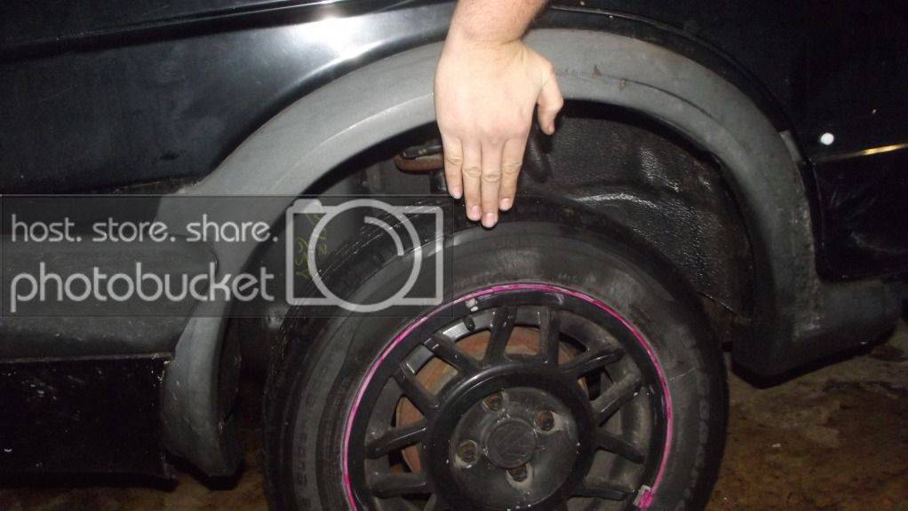

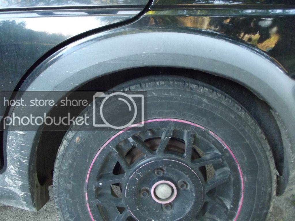

I have a jetta. I bought a set of rear springs off a passat and swapped them out for my factory springs. Even with 550 of people in the rear seat. The rear end dropped maybe 1/2 an inch.
