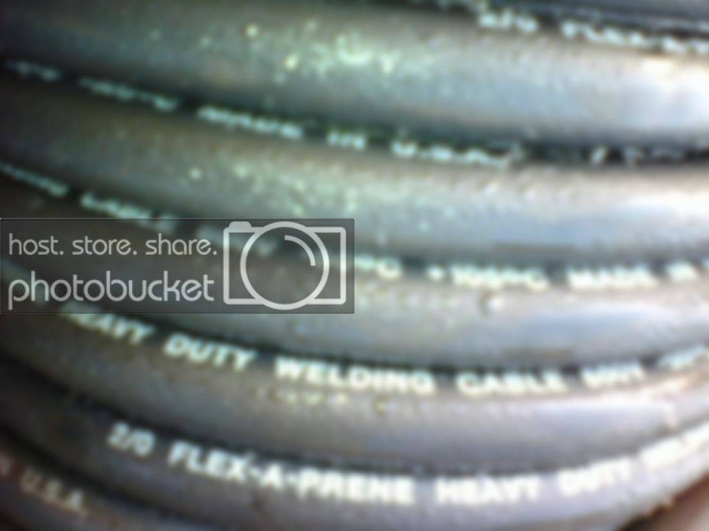

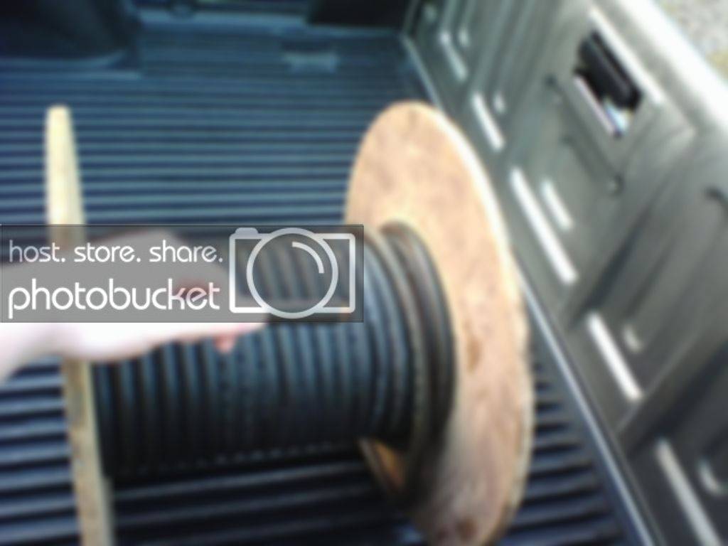

I plan on running 1 sundown 1500 and a medium sized 4-channel. Im wondering if this wire is going to be enough:
I got a killer deal on this stuff!//content.invisioncic.com/y282845/emoticons/yumyum.gif.0556df42231b304b9c995aefd13928a8.gif and no it wasnt stolen...
Im using 2/0 cause I might upgrade to dual sundown 1500's or one very big amp in the future. Oh I'll be running 2 15" Fi SSD's for right now.

Also, Im having a hard time finding battery terminals and distrobution blocks that can handle wire of this size. any suggestions on where to find these accessories??
I just placed an order with them. Easiest way to go about doing so is to browse their ebay store and make a list of what you want. Email them the list and say you would like to place this order.

will this wire be ok for powering my whole system? Ive heard it is good to use for the Big 3, but havent seen anything about running it back to amps and stuff. It doesnt have a really high strand count like stinger and others, but I hope it will be ok. any opinions on this?

high strand count is for flexibility. You will get the same current through that wire.
Rockford has some 2/0 stuff available. Or, you could look up welding suppliers in your area and go there. It works fine, it just isn't as "pretty" as the car-specific stuff.
