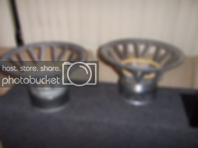

this is what $467 worth of raamaudio gets ya

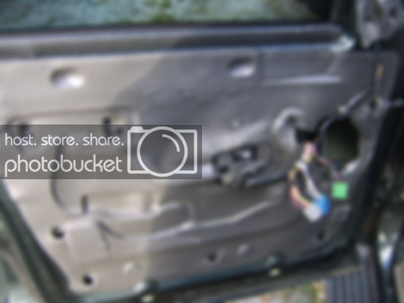

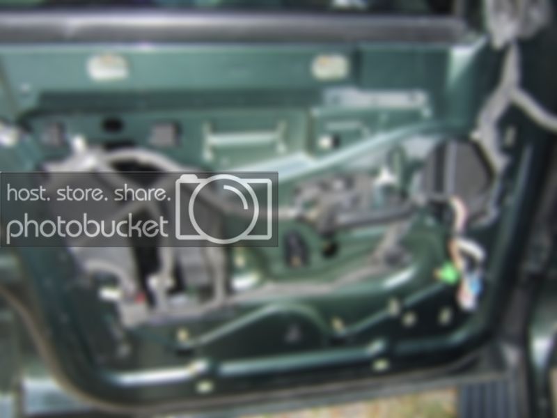

Door panel removed

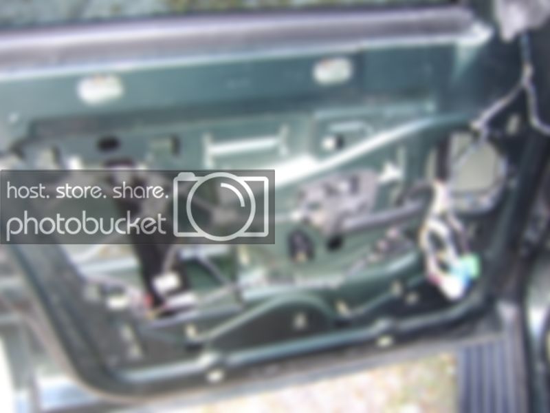

Stock foam removed.. once i saw this i said OMG

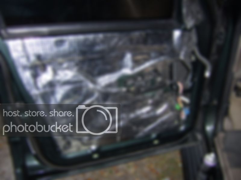

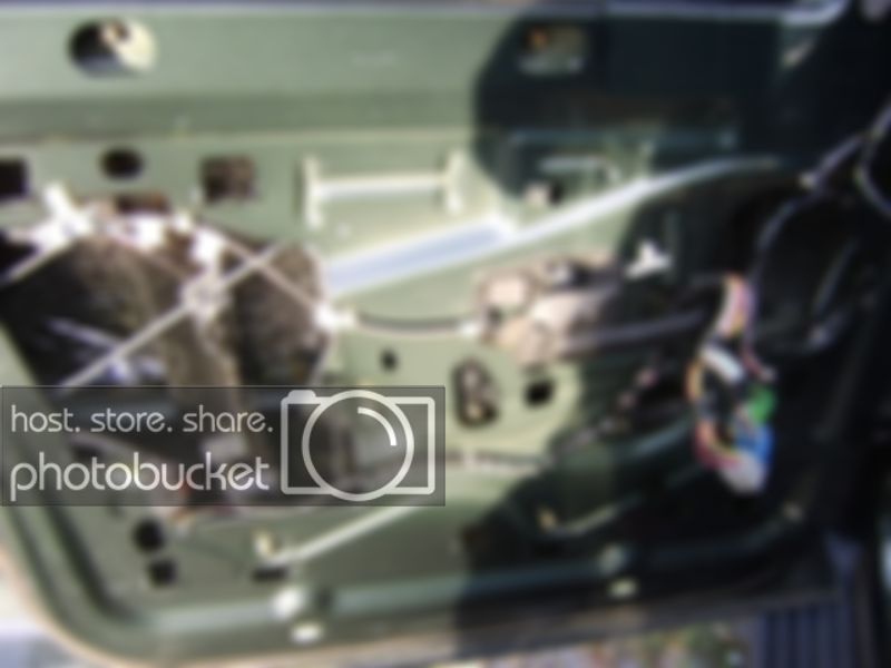

raamat inside the door

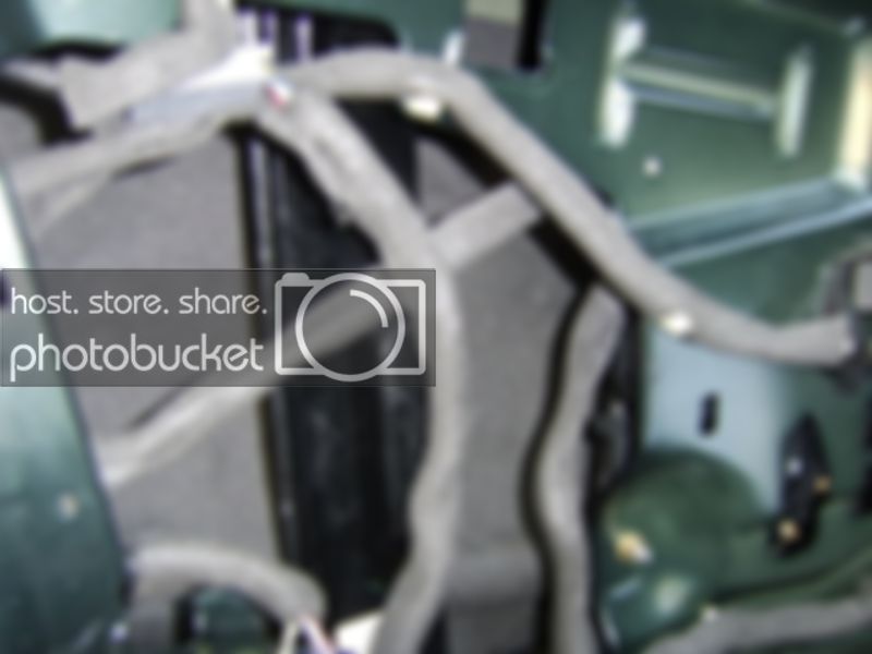

ensolited all the wires and bars and inside door
layer of raamat on the outside

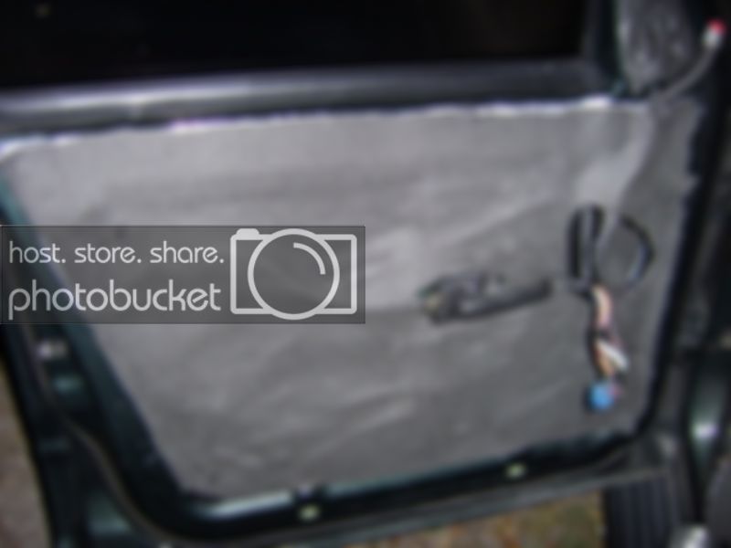

and a layer of ensolite to finish it off
