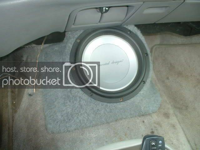

Alright currently this is what I have
Now I want to take this out...and get XXX mids...I have kickpanels, with my mid range speakers in them...and the XXX Mids are to deep for my doors...so now I want to replace that 8 inch with a pair of XXX mids in a fiberglass enclosure, right in the middle of my car like that.... Heres some questions....
1. Should I seperate them into their own chambers?
2. should I have them tilted up and side ways so it they're facing the drivers and passengers heads? or just straight up at the dome light?
3. how much do XXX mids go for usually?
i really doubt that it would be an improvement on what you have now. i would x over the subs at 50 x over that at from 40-180 then let your mid/tweet combo kick in at 170 on up
You want to change from a single mono midbass, to stereo midbass (good idea) but then mount them together in the center of your car? That's a good idea gone wrong. //content.invisioncic.com/y282845/emoticons/wink.gif.608e3ea05f1a9f98611af0861652f8fb.gif Midbass should be to your left and right as you sit in your car, not just from the center.
mid bass doesnt start going stereo until about 200 hz thats why i suggested keepig it x over low and have the midrange come in to pull out the higher freq between right and left. some people say when you cross over at 125 hz it starts going stereo but thats based on the slope so allow the mid to play into where the midbass does a tad

What are you trying to argue? midbass IS directional and should be at either front side of the listener for a proper soundstage end of story.
