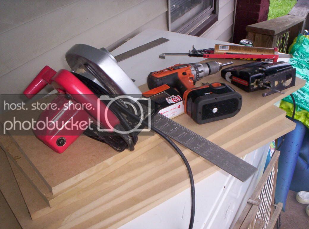

The tools

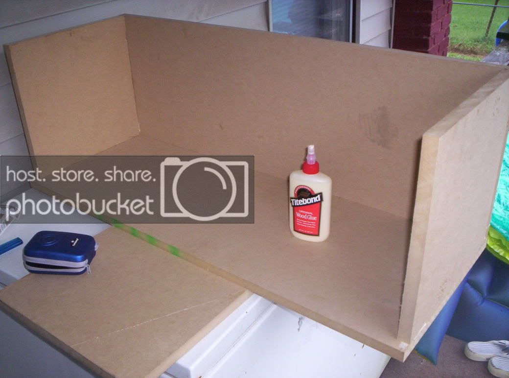

Some construction

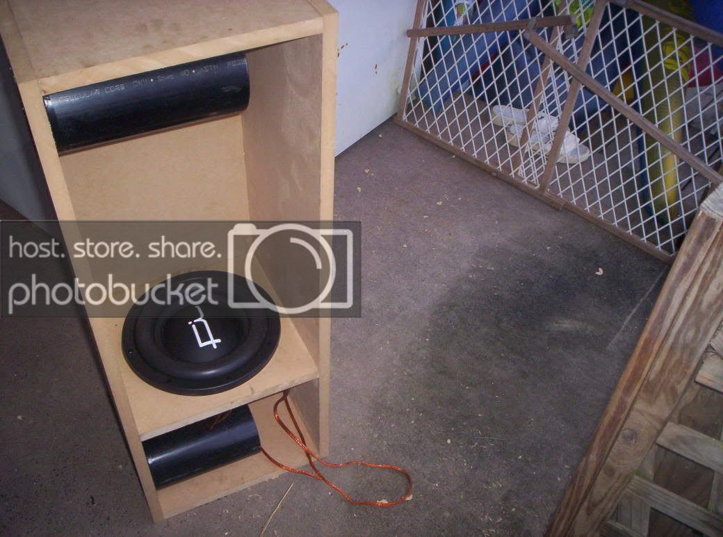

The guts

Well, I don't know. I thought I had it hooked to 1 ohm to a opti2000d (The T/s's said Dual 1.4 ). nThere was no bass boost and almost 1/4 of the gain set getting ready to set it with a DMM to 1000 watts. I figured what the hey and go ahead and give it a listen. I turned some test tones on and listened to a few. Then I put music in....I played Late Night Tip and I started to increase the volume. I got to about 24/40 and the amp shut off. I was like WTF. I open the trunk and its in protect mode. I unhook the sub and test the final ohm load and it's .5 on my DMM. I have the sub wired parallel-parralel.
Because anything above 40 hz is almost non-existent in this box.
I'm not sure ask 80 it's his design.
one of the good things about a properly designed bandpass box...it leaves off where your midbass suppose to pick up..//content.invisioncic.com/y282845/emoticons/up2something.gif.dd110ecf3ae4b76050d87598f2f8de7c.gif
i would set the lowpass xover at 80hz ..cuz it sounds like u have it set too low
but that box looks really good....i'm impressed with your building skills...and i'm sure it wasnt that hard to build either
