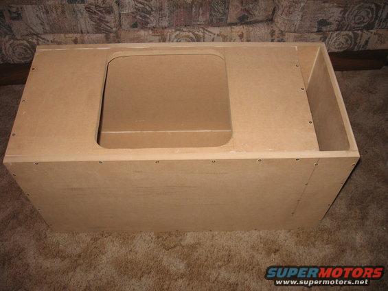

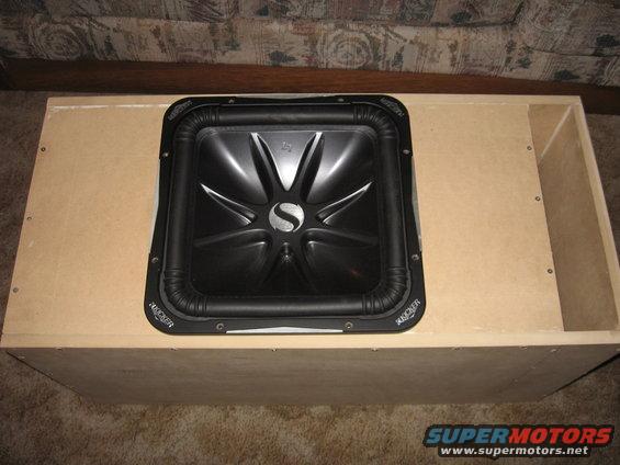

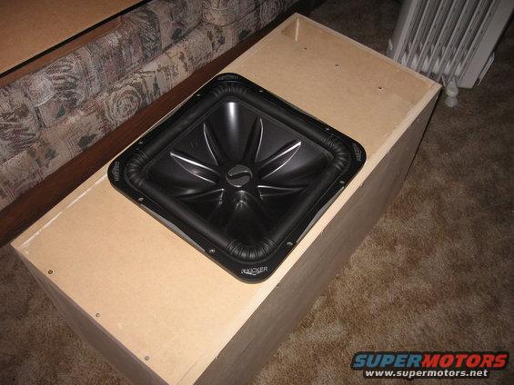

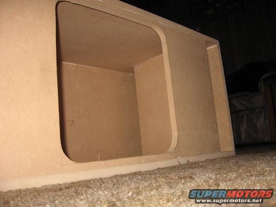

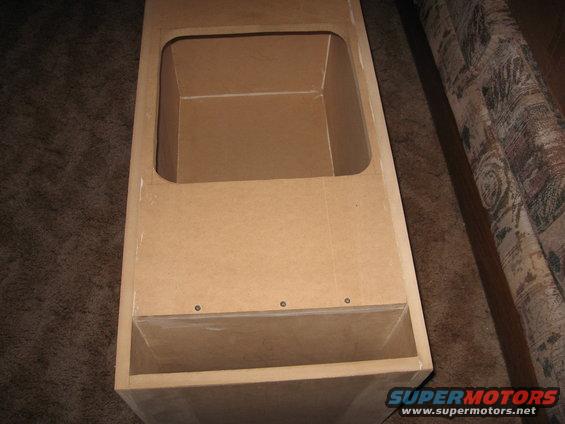

But, here is my first box. It is 4.5^3FT tuned to 34Hz. 50sq. in. of port. Let me know whats you think.
BTW, it's going to be covered in bedliner.

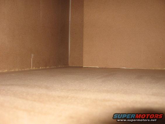

You should put some kinda sealant in there, it looks like you have a place in the 4th picture where some air could get through.

Well, I heard 50sq. in. would be sufficient, but I guess I could have heard wrong. I should have noted in my first pos that it is not 100% done, and that I still need to add some sealer. Install pics will have to wait until I can afford my amp.
Thanks for the comments.
What do you guys recommend for a good sealant? I have heard silicone, but want to double check.
go to wal mart/lowes/home depot and pick up GE 100% Silicone II Sealant. you can use the kitchen and bath, or the door and window version. same shit really.
just make sure you pick up the II version and not the I. im sure the I will work, but on the back they have a 1-10 rating for adhesion and the I gets a 7 for wood, while the II gets a 10.
