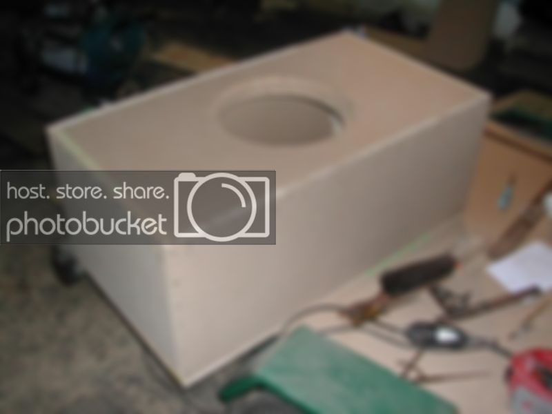

This one is made with 3/4 MDF, all cuts made with a circular saw (first time i used it for cutting important lines, vs just 2x4's) So I think it came out pretty good.
It's a 4.4^3 sealed that I tested out for a .707 QTC alignment on my Eclipse SW8200. For the love of god, in that enclosure, it was the loudest I had ever heard (actually, felt) between 15 and 20 hz. If I opened the door of my Jeep a crack, I would bounce quarters off the roof 3-4" @ 20hz with only 250 watts of power.

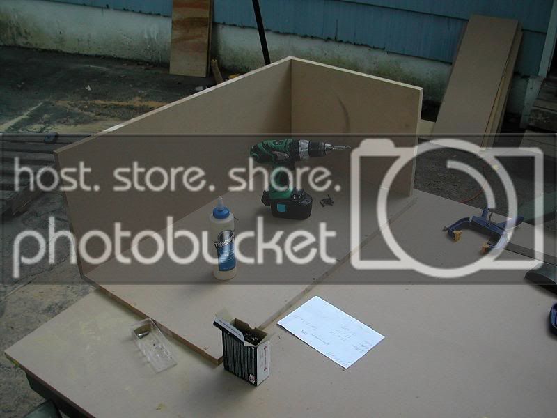

How they all begin:

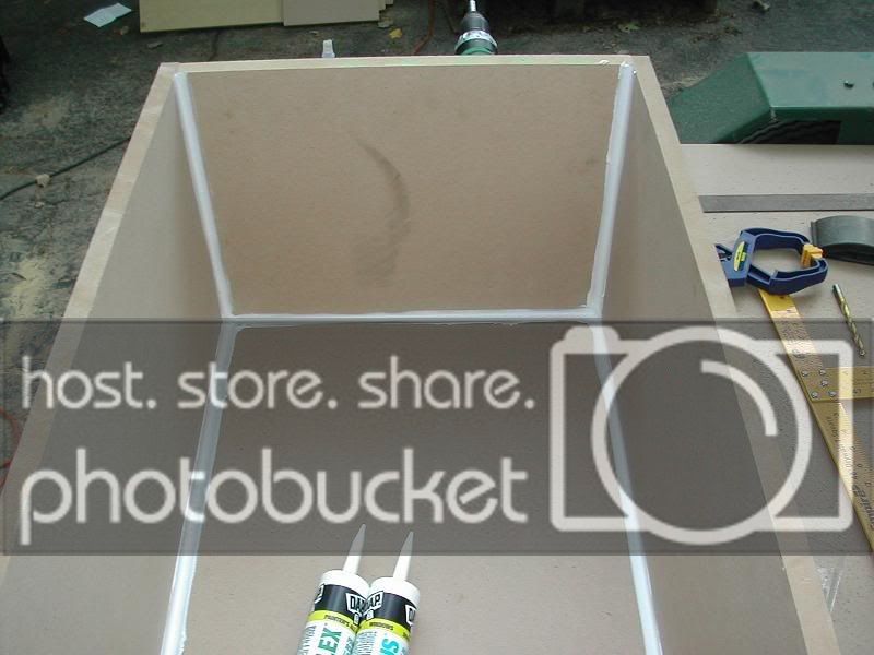

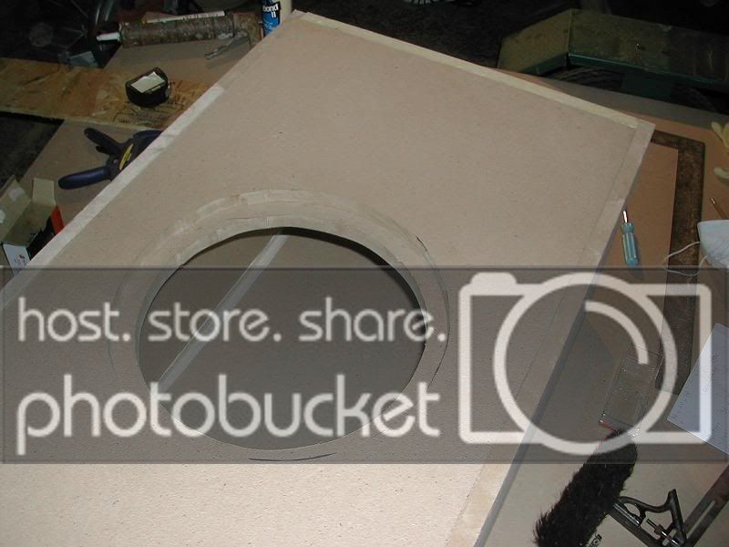

God i love the look of a recessed front baffle. All my boxes from now on are going to be built around this //content.invisioncic.com/y282845/emoticons/wink.gif.608e3ea05f1a9f98611af0861652f8fb.gif
I realize a lot of you build boxes without screws, but I can't stand that for some reason. I'm not saying you guys build bad boxes or anything, I just like the security of having screws in there along with the Titebond II.
I'm probably going to make this into a ported box later on. I can remove the front two baffles because I didn't glue them in ( I knew I would probably change the design)
Looks nice, just need to dress it up //content.invisioncic.com/y282845/emoticons/wink.gif.608e3ea05f1a9f98611af0861652f8fb.gif

With that big a box you should really port it and try it out for the hell of it and tune it low like 25-28hz with a few 4 " pvc pieces Id bet you'd be surprised and keep it in there.
x2, never get as much output in a sealed vs. properly ported.
Yeah, that is a good looking box, it just needs to be covered in something IMO
I have never done a ported box before. Right now its 4.4 cubes as it sits. Can someone tell me the dimensions of port's i'd need? Right now the box is doing nothing in my garage...
