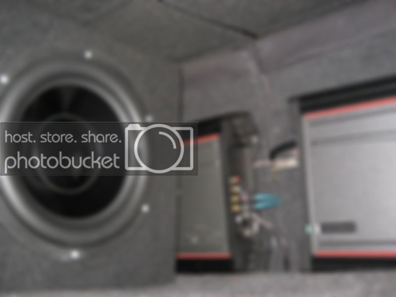

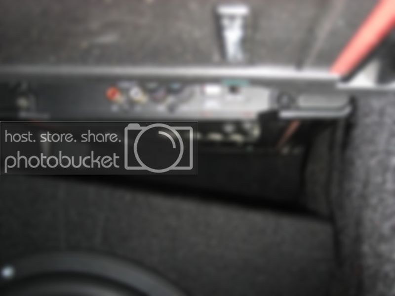

i have new pics of my new sub/enclosure and hatch setup. the new sub/enclosure is a Dayton Reference 10 HO in a .72 cubic foot (net) enclosure ported tuned to roughly 29-30hz. it's getting 400watts rms.
Sawdust in your pole vent = possibly sawdust in your voice coil = bad. //content.invisioncic.com/y282845/emoticons/frown.gif.a3531fa0534503350665a1e957861287.gif An enclosure should always be wiped out thoroughly before mounting the speaker.
Awesome install, nice and clean.
I have a set of RSD's to install, hopefully next week when I have time off for Xmas/New Years. How do the tweeters sound down low like that in your kicks?
they sound great down there. the stage is not low like you might expect. on most music the stage is pretty high.
this whole setup amazes me in terms of SQ and also in output. the RSD's sound great and get loud, and the same goes for the new Dayton H.O. sub as well. the Dayton can blend with my front stage very well but also it can have a lot of output when called upon.
