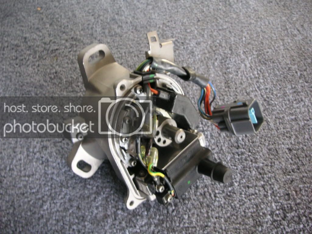

I'm going to start taking apart the b16 block tonight or tomorrow. Also got these finally
B16 Distributor

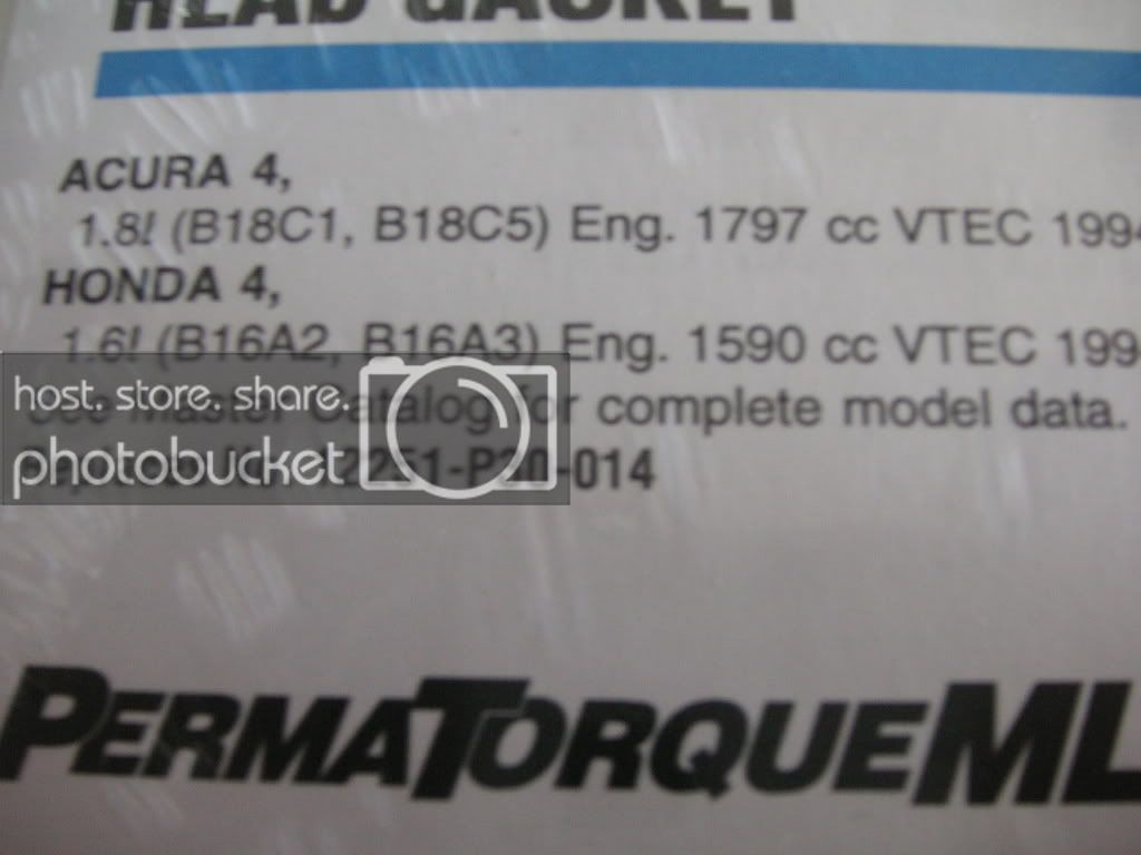

And a steel head gasket but leaving it in packaging.

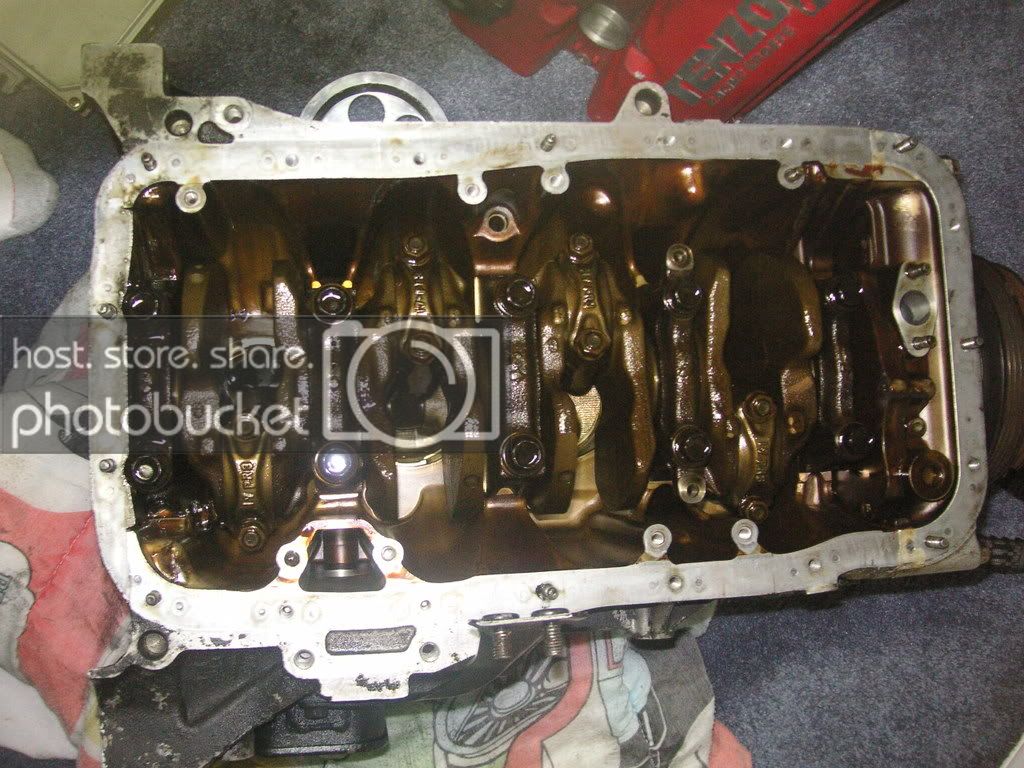

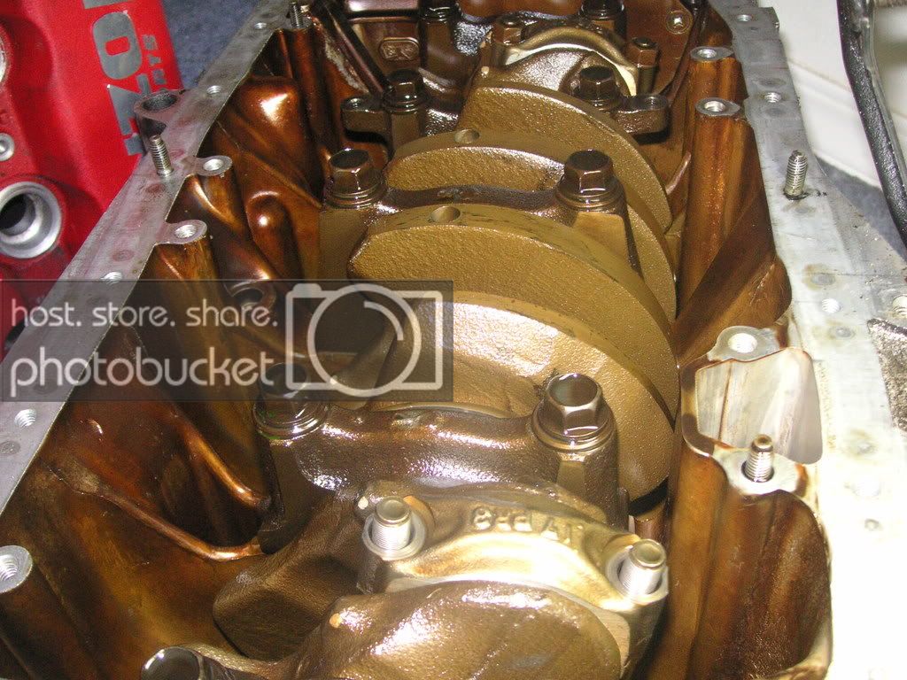

Well I was expecting to have this done by now but am just now starting //content.invisioncic.com/y282845/emoticons/frown.gif.a3531fa0534503350665a1e957861287.gif. Should be done by november since I am saving up for a few more parts and am busy a lot. Today though I am taking the pistons out of the b16 and have a few pics.
Some internal are usdm because I saw it says pr3 on the rods. Unless the japanese motors say pr3 on them because I know the only thing changed from the us and the japan version are the p30 pistons
