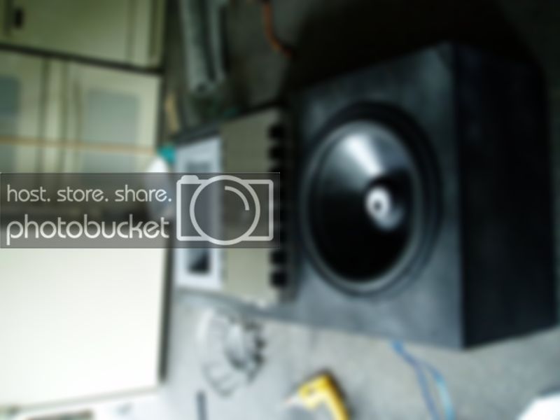

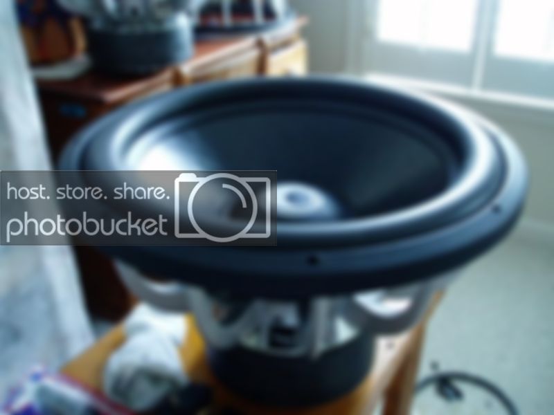

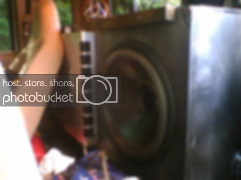

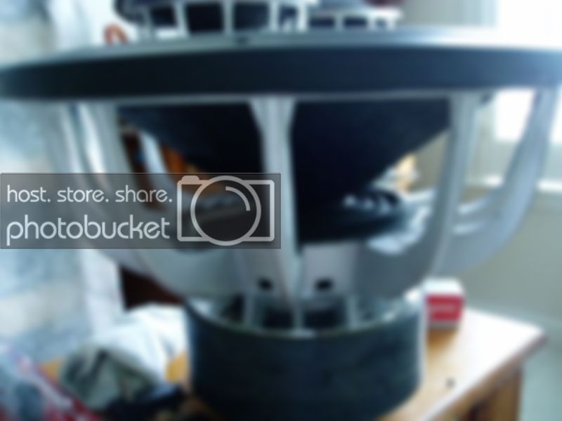

here's some pics...
and now with epoxy all over the cone and no dust cap //content.invisioncic.com/y282845/emoticons/redface.gif.62fdbfe1a101588a808c4cff71bcb942.gif
oh and it plays just fine without a dust cap i've noticed... the only real purpose to one is to keep shit out of the gap and to channel airflow over the coils right? it did seem to heat up quicker and get smelly when it was blown off...
