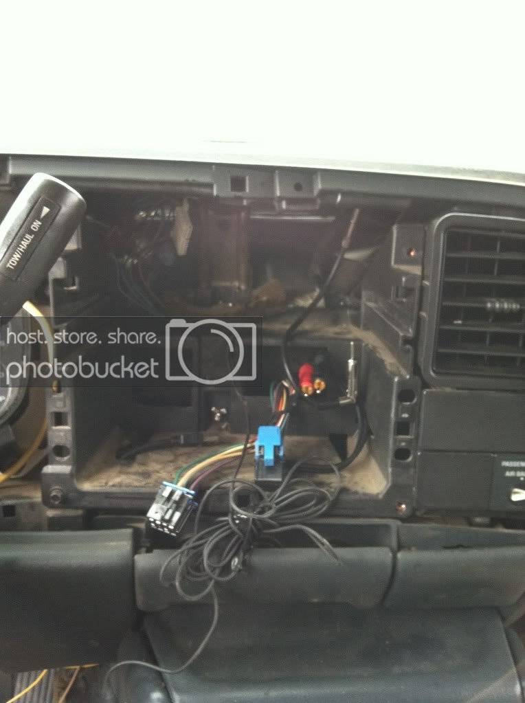

this is what it looked like when i started... best pioneer ive ever had pioneer 710bt

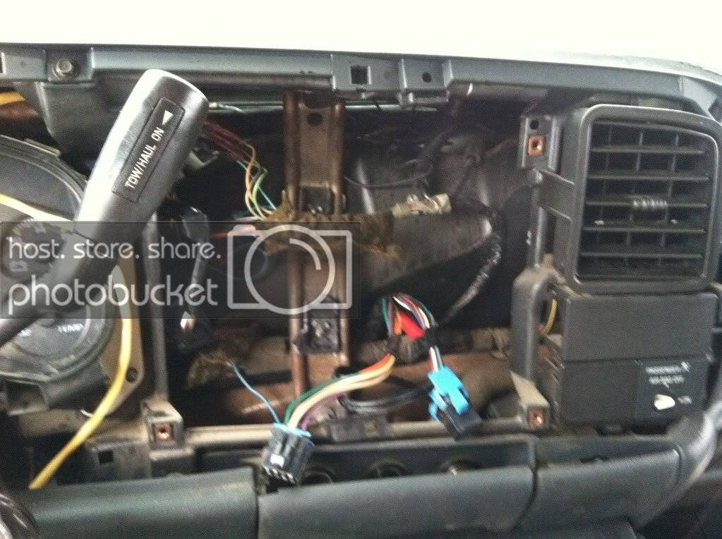

then you remove the radio and the AC controls

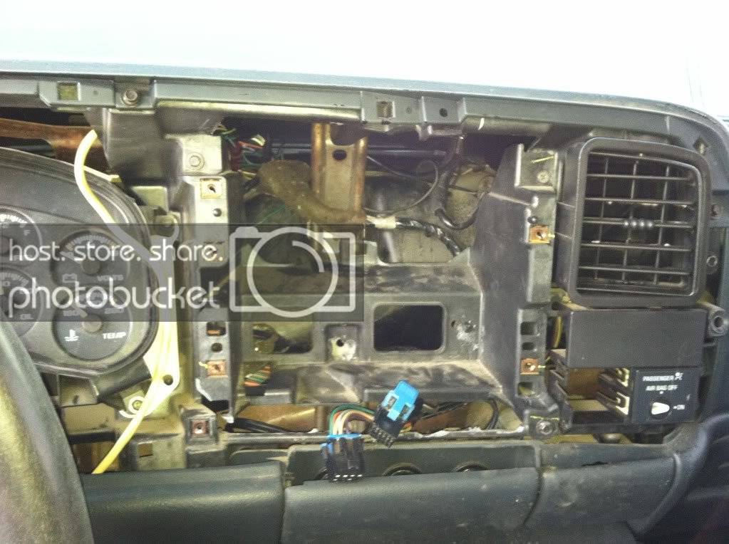

the next step is to remove the radio bucket... it kinda ***** because there are 2 pins in the back that have to be drilled out
and TA DA! got it out but i ended up just breaking the bucket out and then later ripping the plastic off the metal brace lol
then install the 03+ radio bucket from a silverado tahoe suburban regular 1500 .
its not too hard just had to break the bottom right screw hole to make it fit then secured it by puttin 3 screws where they go and a couple extra in different places.

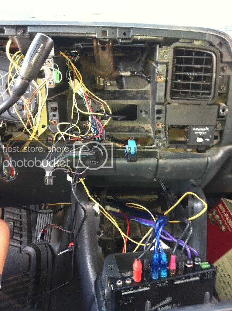

do all your wiring... hated this part lol
after this then its just a regular install... double din dash kit wiring harness..

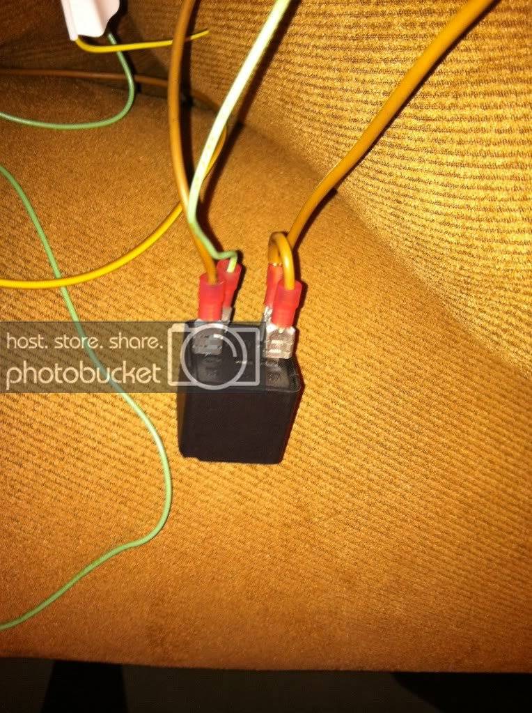

but the parking brake bypass was fairly easy. all you need is a 12v relay because in order to bypass it the parking brake has to be grounded AFTER the radio turns on

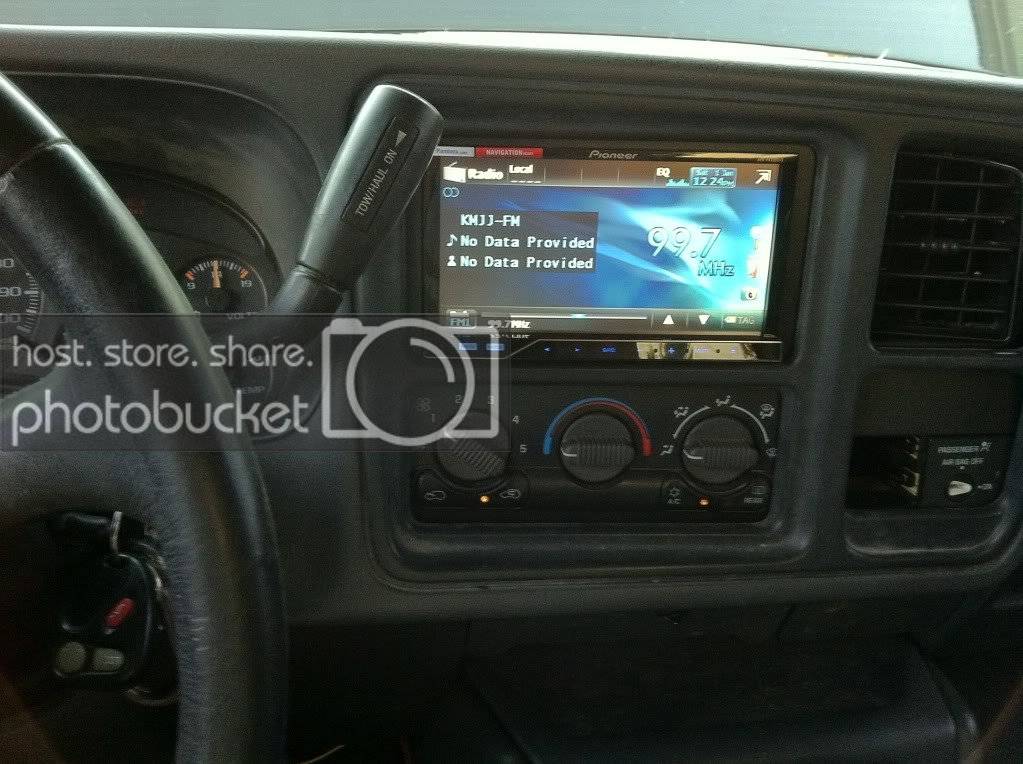

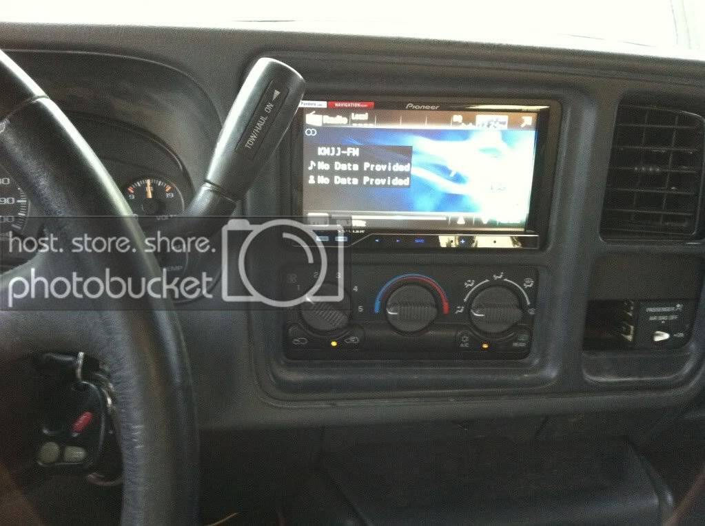

and TA DA! all done i chose the pioneer AVH-P4300dvd GREAT RADIO!
Looks great. I love my 3200 just as much as you guys seem to love your 4300's. The 3200's faces layout was more appealing to me and i don't like mechanical faces..But are both great units for the price.
And not to be a **** but i doubt they'll sticky this as it's model specific.
Quick question, what did you do for the dash? The hole in the stock dash is for a 1.5din, but I see in the last pic you haven't cut the dash. Also did you have to cut the metal support in the back of the bay? I have a cheep Boyo AVN700A, it is rather deep so I suspect I will have to. I am about to do this mod following another tutorial (cardomain.com/ride/825435/1999-chevrolet-silverado-1500-extended-cab-short-bed/page-3) but I am trying to get together as much information as possible. If there is an easier Dash mod than what he did I am ALL IN!
