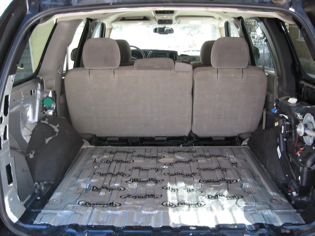

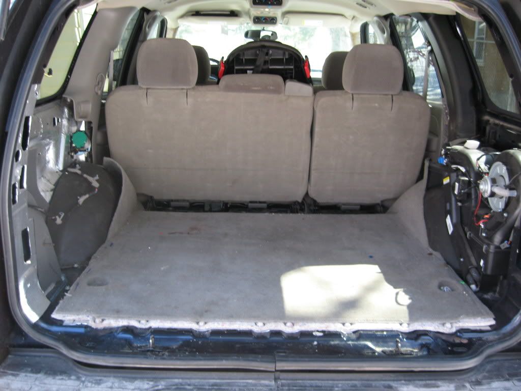

I think I'm gonna start on my sub floor tomorrow. A pain in the *** to do by myself but I've gotten the dang carpet out before. I had previously deadened the floor area a while back.
I took the rear carpet out. The V1 I tried stayed put everywhere I put it. Its not thick though but stays. I'll give it that. I also had a Dynamat Door kit laying around so I stabbed that over top of it in the floor. Its all good. I'm just using BXT everywhere else...lol
I may run down to Bay City to my uncles and put her on the lift. I wanna get under there and bolt the sub floor down. If I have to drop the fuel tank it will be a hell of a lot easier on a lift....lol

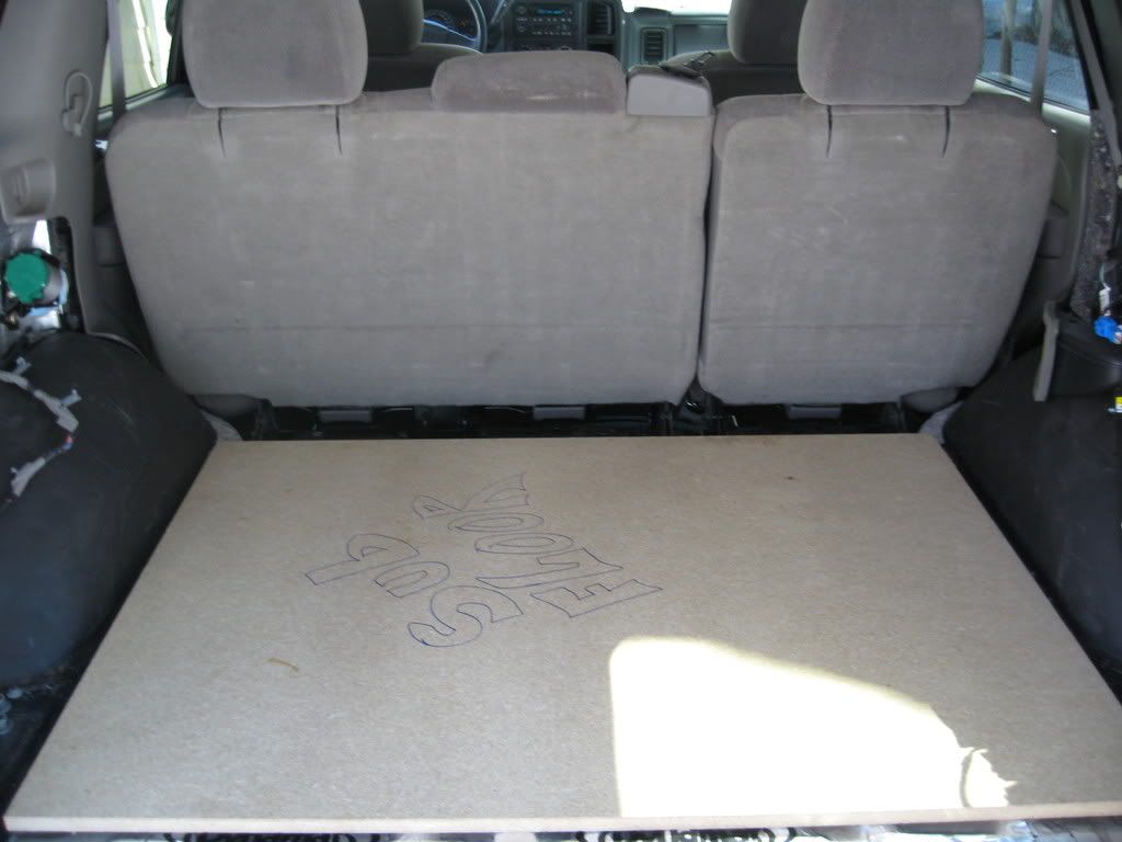

The sub floor is as big as the box will be, joy!

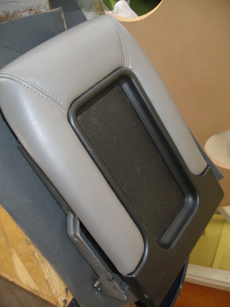

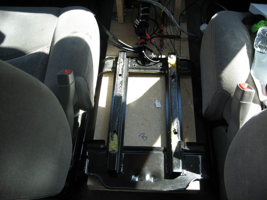

I took the tray from the stock seat and I gotta form that into it.
I also used the mount bracket from the stock seat also to bolt the whole console down. hence the moving of the crossover.

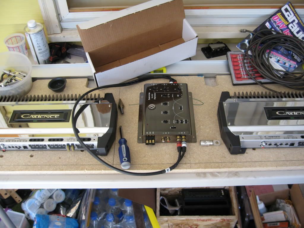

Now the crossover will be in the amp rack under the second row kinda like this...

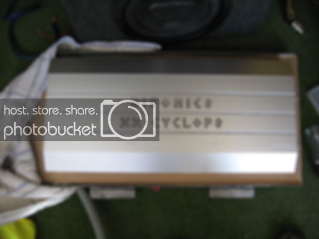

I don't recall posting Cyclops pics...

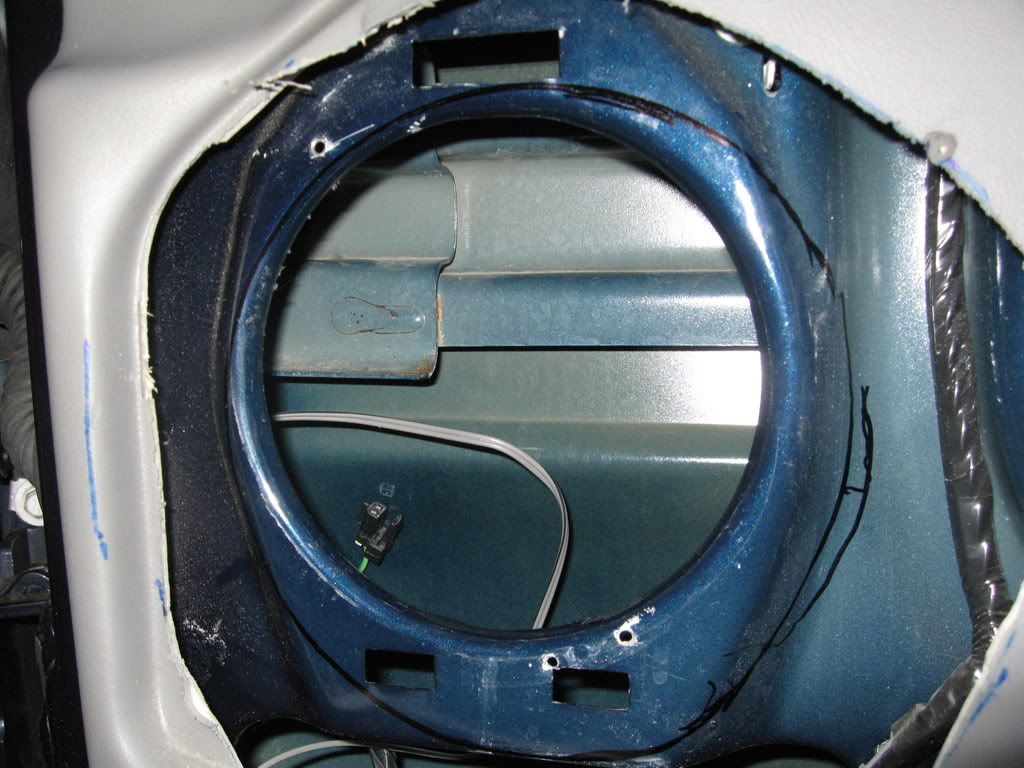

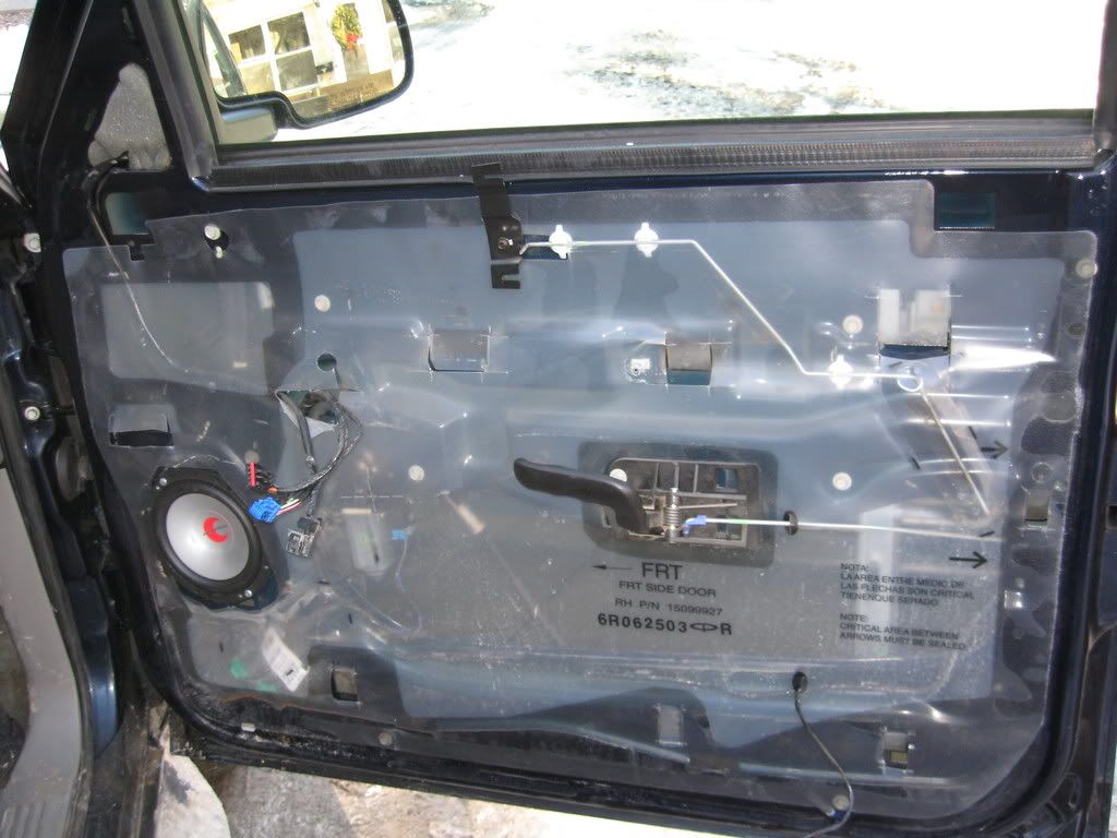

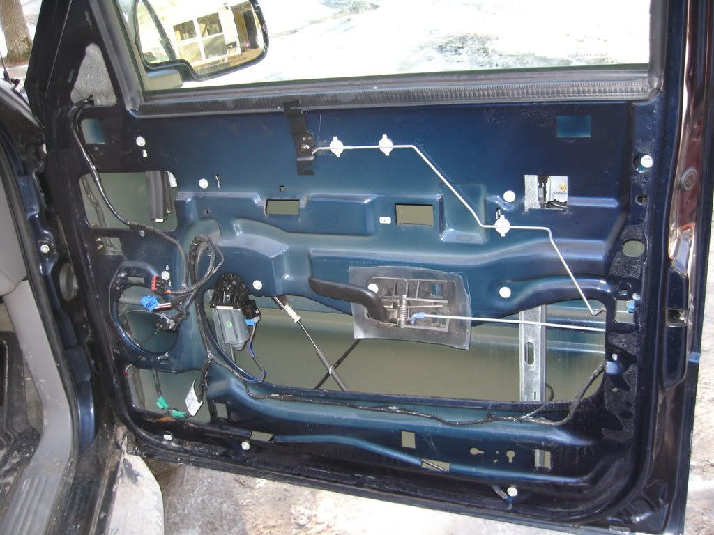

Well I was bored and I figured before the day got over with I would pull my passenger door panel off and see what I have to deal with. Not bad! I'm gonna get the jet engine cleaner out and wash the door down. Give it an Acetone rinse and deaden it.

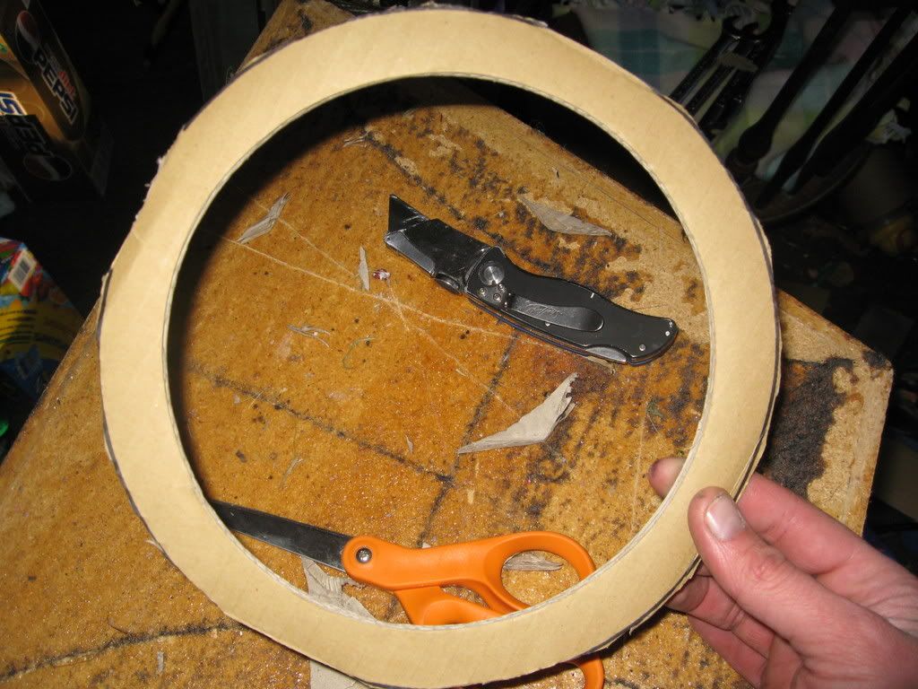

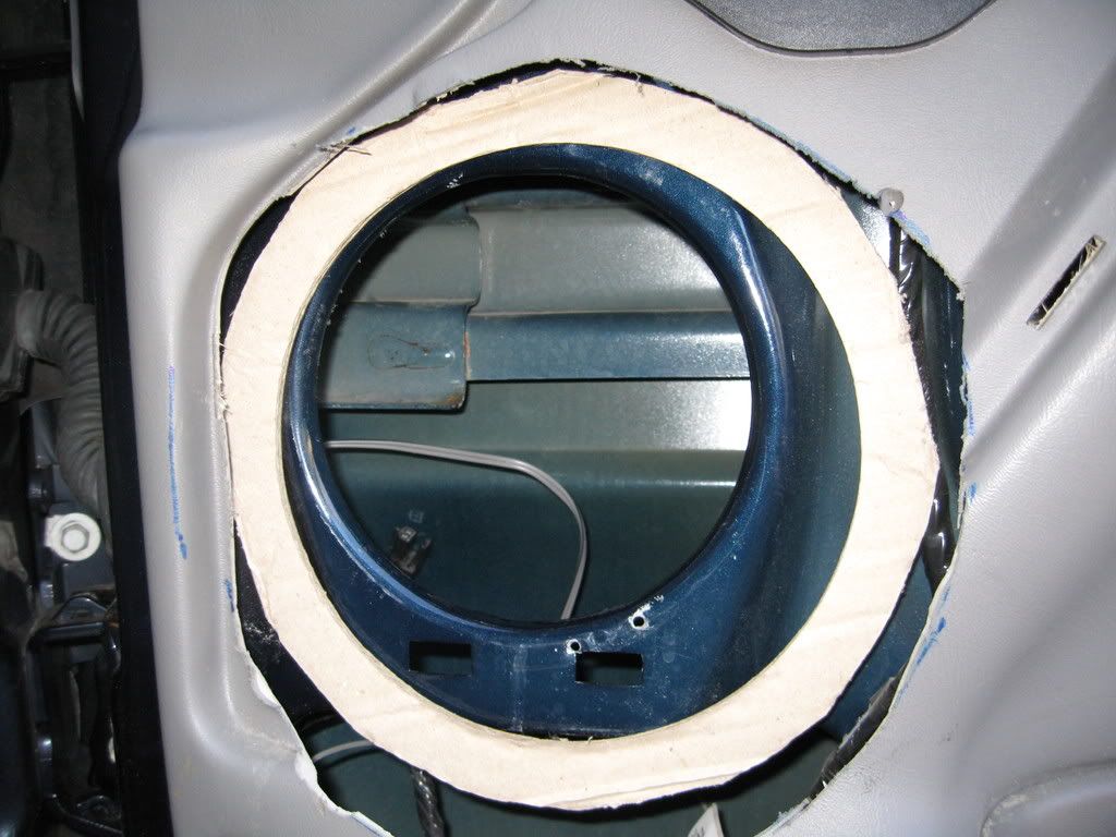

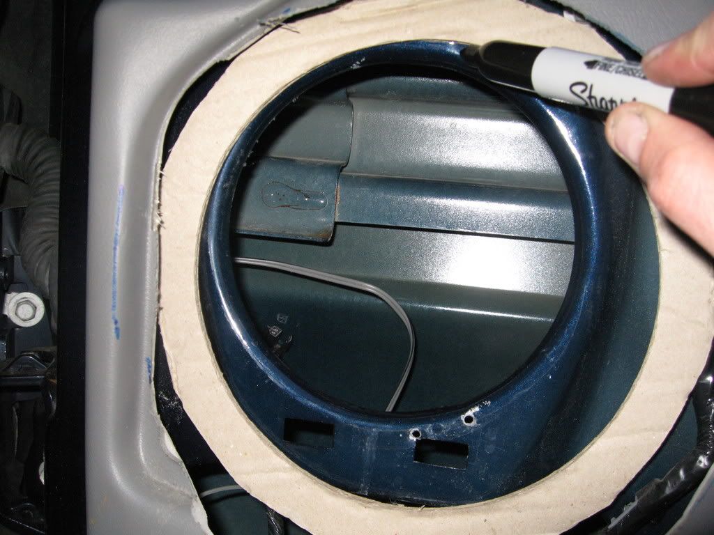

I have to make patterns yet again to seal up a couple of those holes. I have to make the baffles to get the Dayton 8" midbasses in also. I was just bored so I opened it up for now.
I'm gonna try to get some noise going before June for the Michigander meet.
Now I know where I gotta cut the door.
There is more to come out than this but its a good reference for now and I wanna get the body saw out!

You got skills bro.. That amp is complete //content.invisioncic.com/y282845/emoticons/drool.gif.b5e863e893038027711d4402f340dad0.gif//content.invisioncic.com/y282845/emoticons/bowdown.gif.b85b23b82970bd22fb6b549c3392f016.gif
How do you like them components? I was looking at a pair recently but wasn't too sure about them.
Not components. Its all active. Tang Band tweeters. Mixing drivers is fun. But it is one singing front stage for 50 watts a pair. The vocals are sick. I've had people say its like they never heard some of the songs before. They drove into work pissed off at there stock radios the next day...lol
