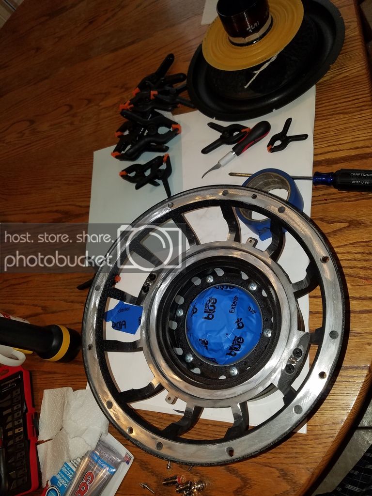

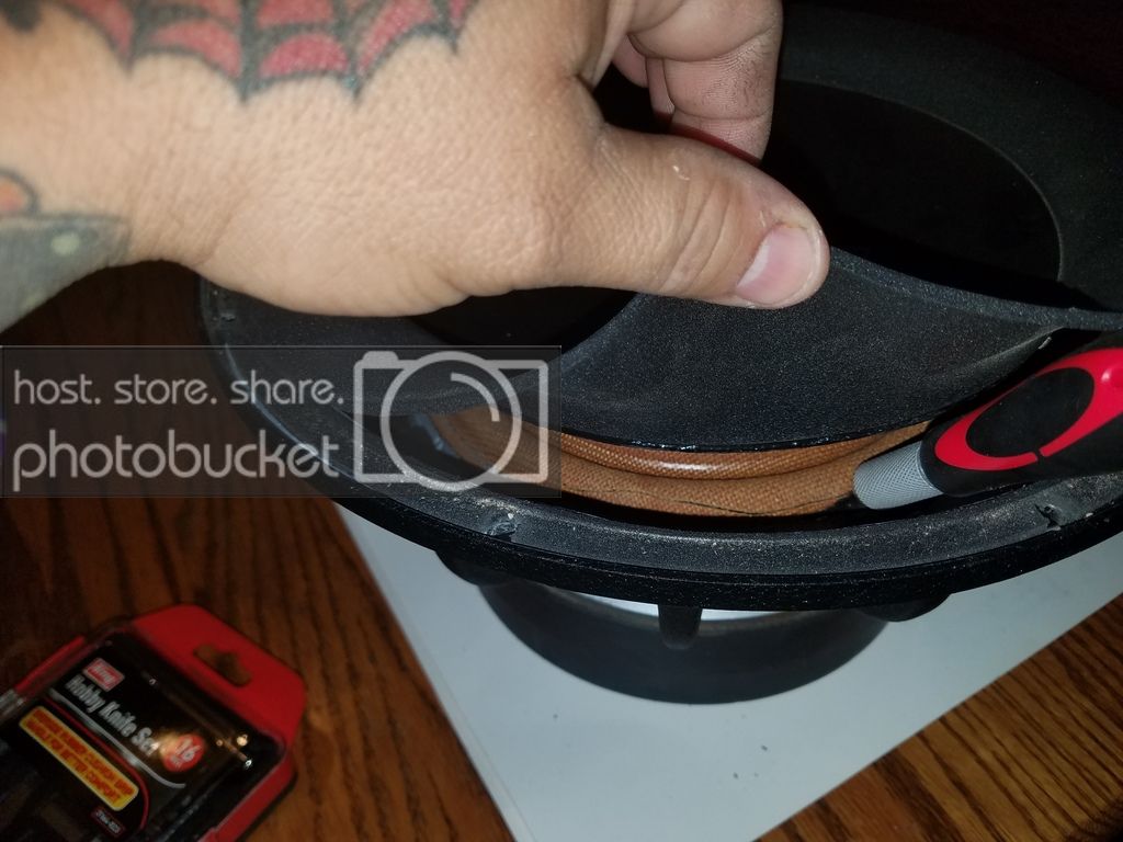

My 1st recone
My63bug
http://i1244.photobucket.com/albums/gg580/jjzickowski1/recone2/20170621_175146_zps6wa8utln.jpg' alt='20170621_175146_zps6wa8utln.jpg'>
i.

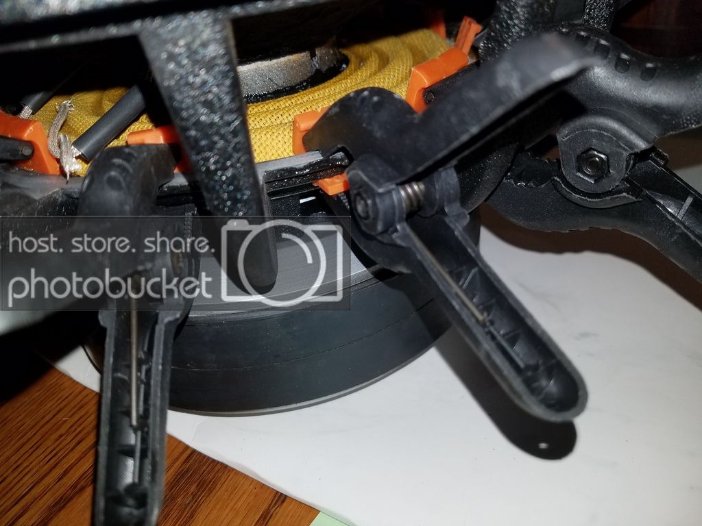

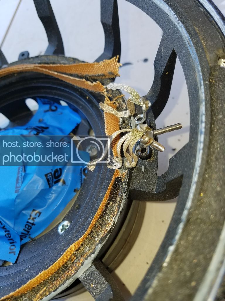

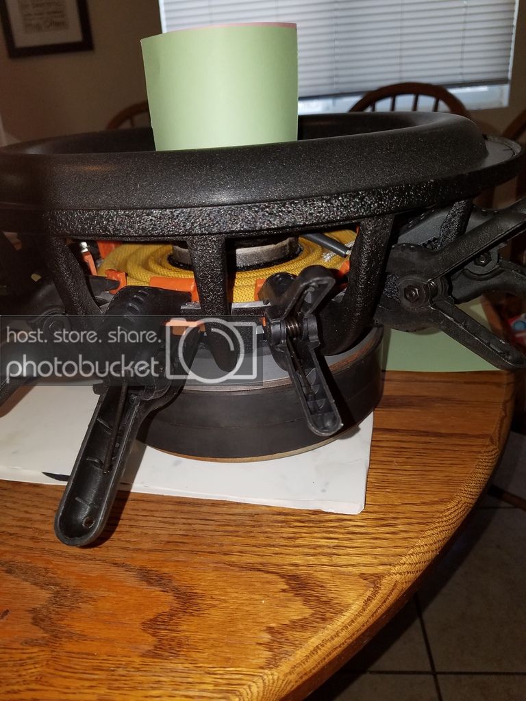

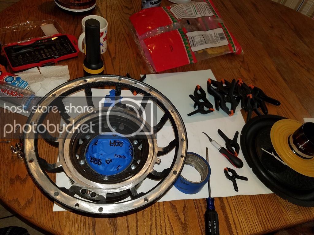

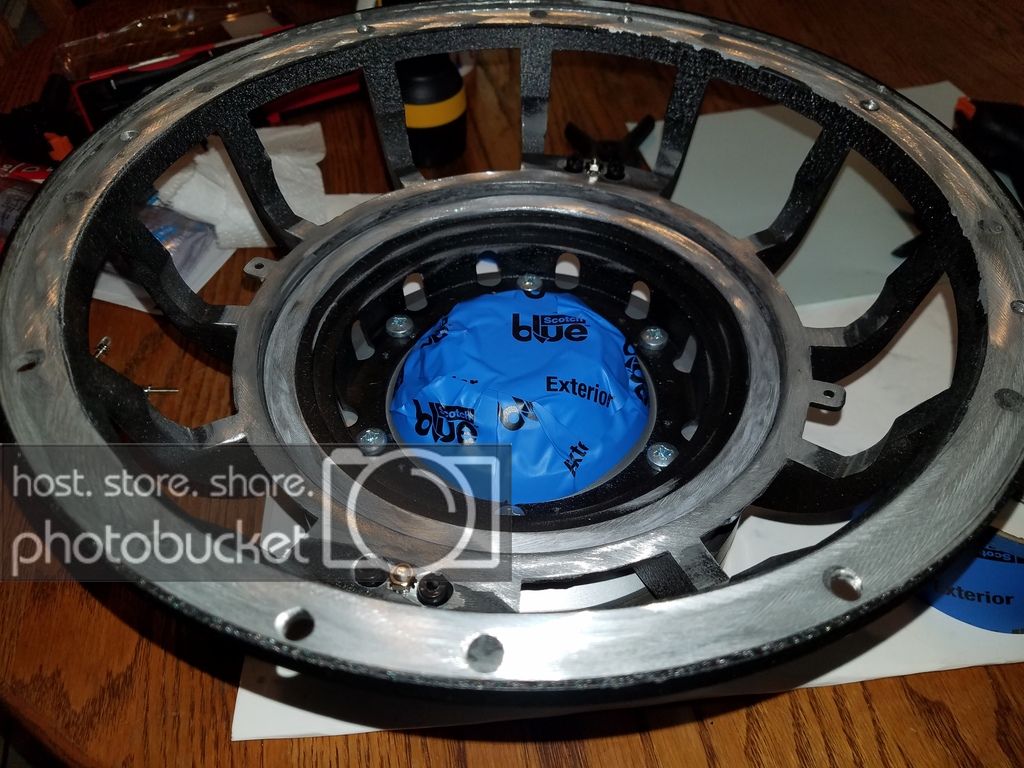

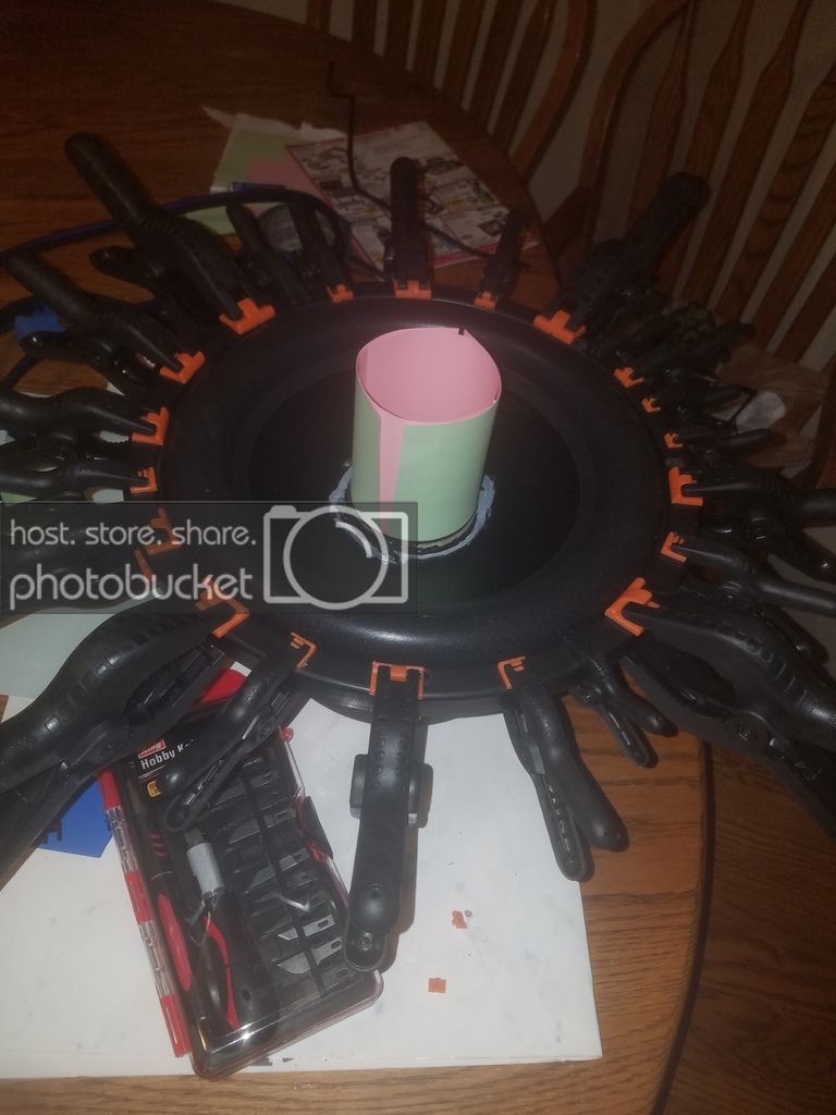

Im bored. Heres my progress
}[/img]
The coil alignment issues you really do not have with large subwoofer because the magnet is so strong everything stays centered and I don't even use shims. If you were reconing a weaker woofer like in a house stereo cabinet you would have to shim and make sure nothing moves.
How did this come out? Coil alignment can be an issue with drop-in kits. I wouldn't touch them with a 10 foot pole myself.
Idk. It sounds like its rubbing a bit somewhere im not in a good mood this morning .. thats just pushing it down with my hand. Dont know what i did wrong
I hooked it up then dropped it in the Box before gluing the dust cap on... there is a slight Buzz at the very lowest of volume. Not noticeable once I turn it up past 1 or 2 I'm sure it's still there just can't hear it. Pulled it out. I don't hear it anymore when I push down with my hands. I guess I'll just glue the dust cap on and expect it not to last long...
False alarm. The noise was coming from the heat shrink tube on the tinsel leads rattling around. I had yet to shrink them lol..pounding azz as usual
