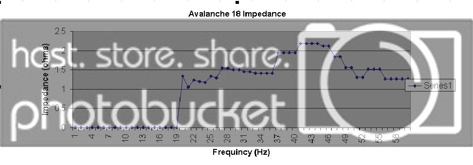

The easiest way to measure Impeadance rise is wit ha Clamp Meter
Here is a short Tutorial:
Matierals:
-Pen
-Paper
-Clamp Meter that measures Volts and Amps
-CD with 0dB Test Tones 20-80 in 1Hz Incraments, 20sec tracks or longer are prefered
1.) Put the CD in and turn the volume up abotu 1/2 way, set the car up like you normally owuld be listening to music, trunck closed and window down or w/e.
2.) Get one of the wires running from the amp to run by an area you can access with the vehicle set up in a normal listening set up
3.) Clamp the meter and read Amps and Volts at every frequincy 20-80 write it down, it helps to make a chart
4.) Do it on a calulator or in Excel, use R= E/A
