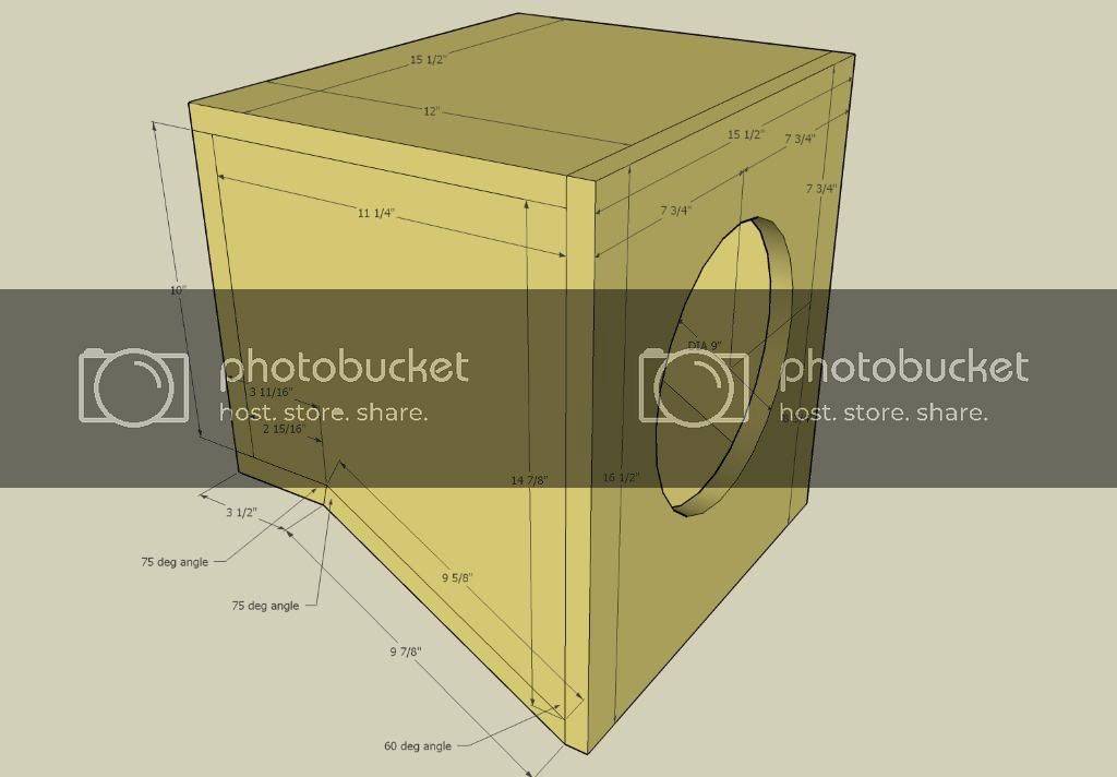

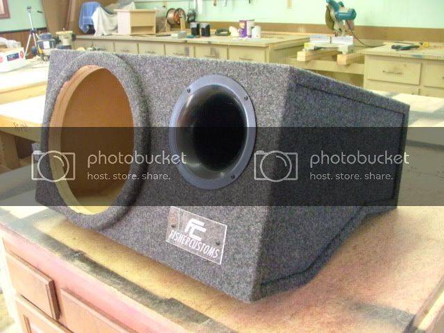

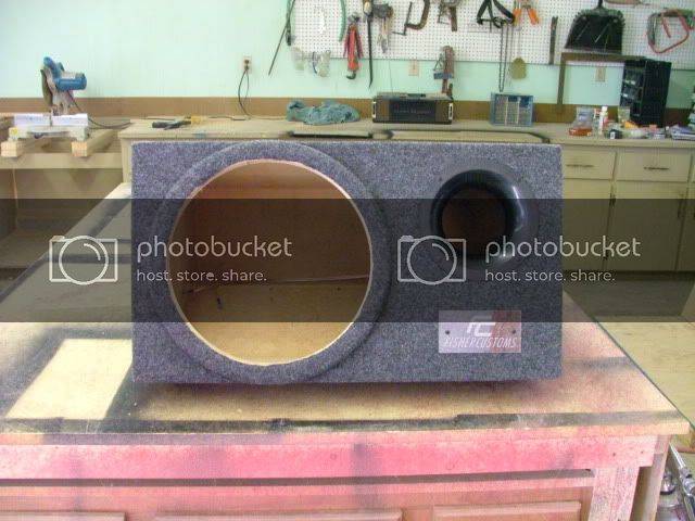

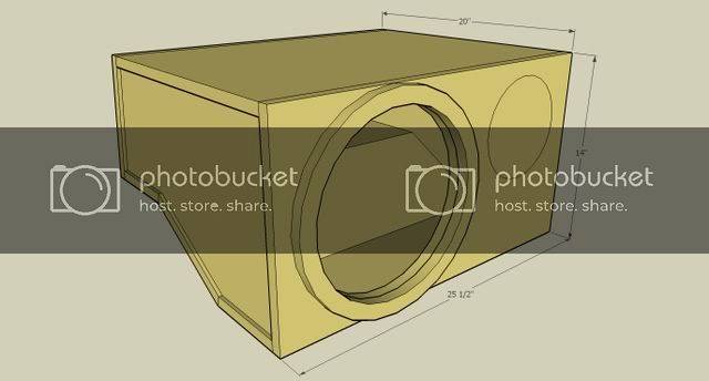

Sorry to bump the old thread, but look what I just came across....

Another fine build! looks good:).
