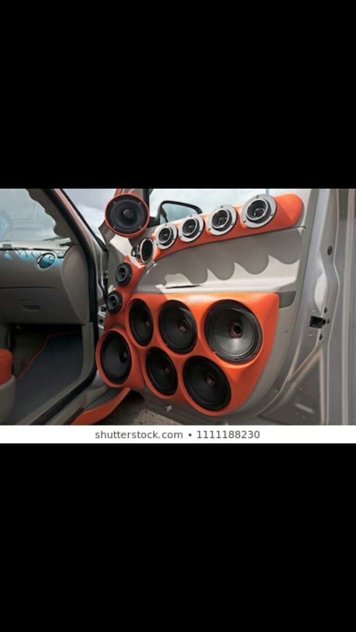

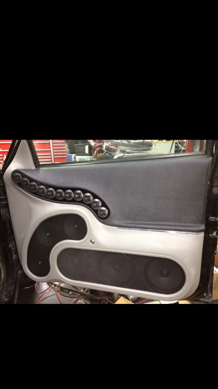

I have in the past tried to do a nicer set of 6.5 inch speakers in the front door while ignoring rear fill. Didn't really work out, wasn't enough output and I always would get to the point to where I was maxing the drivers out. Front speakers I used in my last build was JBL MS-62C (which I hated, was too harsh) followed by Ground Zero Uranium 650q which I loved but wasn't quite enough output)
What is the best approach to get more output in the front ? Should I modify the doors to where I can fit 2 sets of 6.5s ? Should I do a modification to where it's only 1 set but its 6x9 instead ?
Curious to hear from users here who have had loud substages and needed to work hard on the front to keep up.
