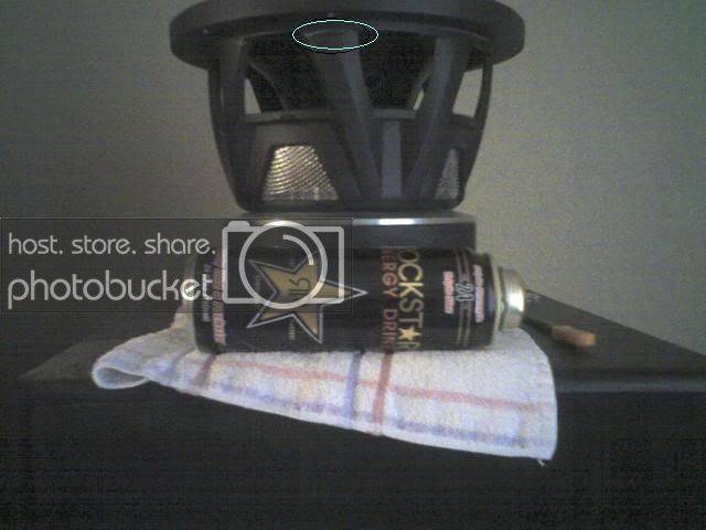

So i picked up a 9510 yesterday works perfectly fine...only problem is the baskets cracked
my question is could i use jb weld on it and the jb weld be able to hole this sub.
would be nice not to pay 140 for a recone from mtx and have a 5 dolla woofa
never seen tite bond
anyhow if anyones curious how it happened im pretty sure it was mounted and the weight of the motor snapped it, they look pretty thin and cheap
Drill 2 holes one above and one below and make a brace. Since welding is out the the question (heat and non metal woofer parts). I do not think globs of any sort of "glue" will be very strong in this situation. I would maybe use some sort of jb weld type stuff in the break to prevent rattle then i would cut a brace and mount it with small bolts...
Use the JB weld stick... it's like a putty... and you can build it up and spread it evenly on all sides.
I've seen some with crack baskets before... but usually around the lip area and vertical.
How will you be mounting it, maybe consider a motor support. But really I think you'll be fine.
