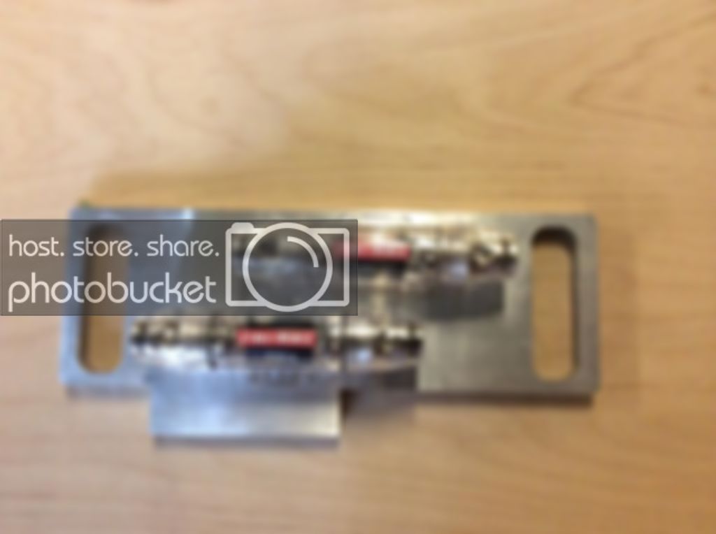

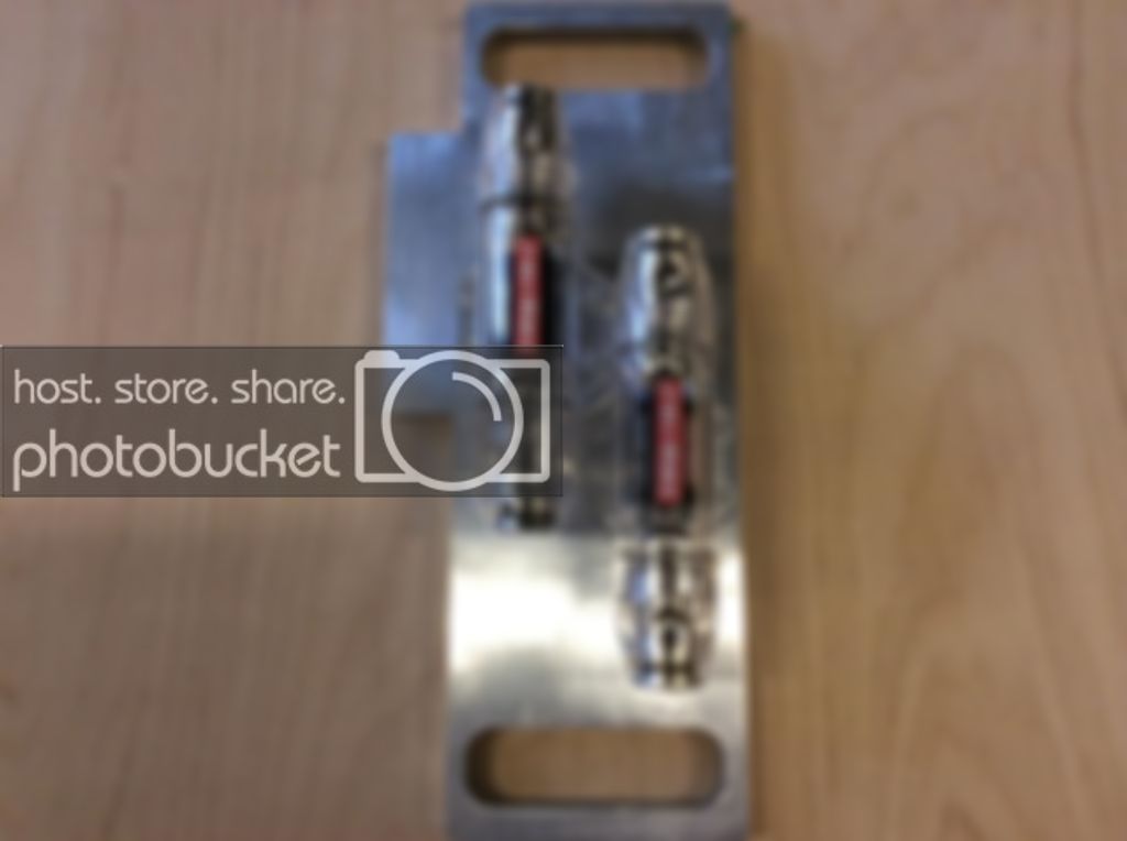

I'm working on a bracket right now to bolt onto my battery tray in my Jeep. I just milled it out of some 1/2 inch aluminum plate. I'll drill a couple of holes in the tab to attach with the existing bolts.
