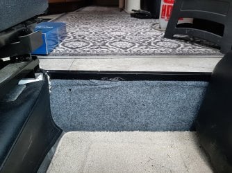

A photo of the area would be helpful.
I have not cut the access hole yet. But I will get a snap for reference. In the meantime, how does Acousta-stu compare to acoustic foam for this application? Thank you.

Thanks. Area for sub mounting is approximately 15" wide and 8" high. There is a 1" vertical stiffener brace half way across.
