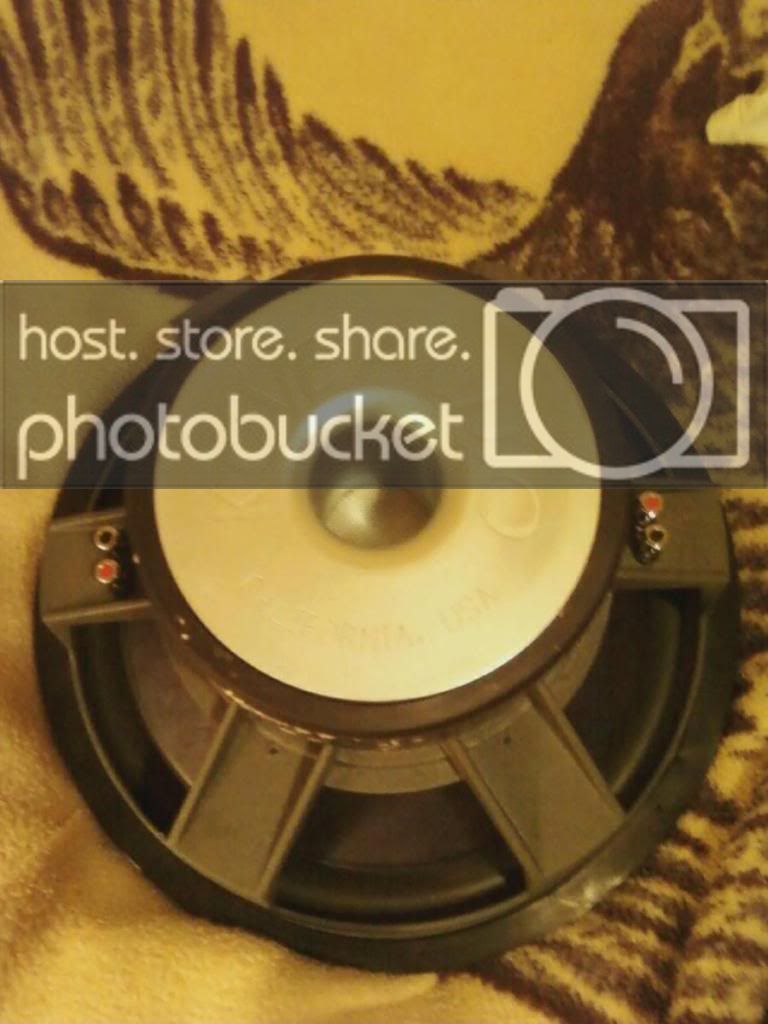

Does that sub have a pole vent?
IIRC, you should leave about 4" behind a pole vent. If it's a solid pole then it shouldn't matter, as long as the box is not flexing and causing the panel to hit the bottom plate, as that would sound terrible.
To be truly honest im not sure what a pole vent is exactly. but this is the back of the Kove
^^ x2
