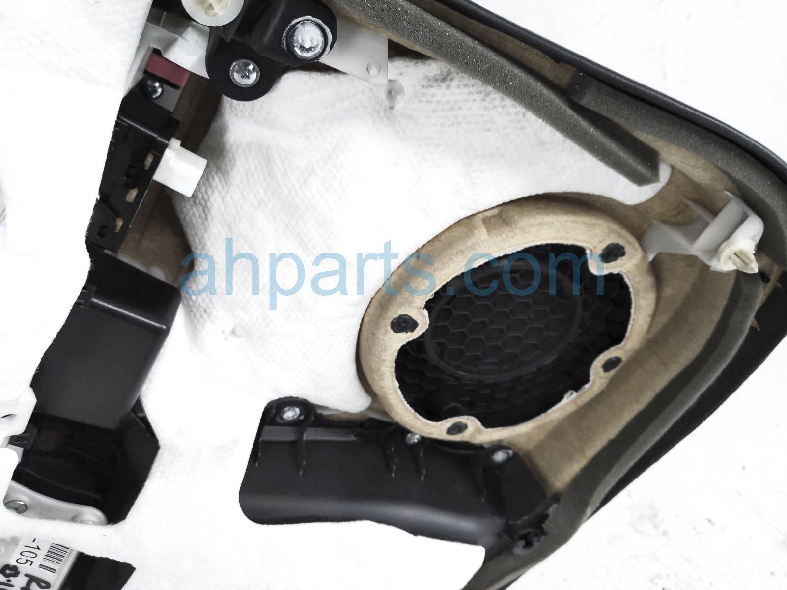

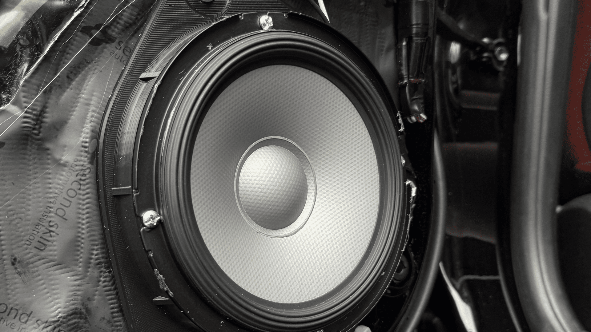

Theres my setup on of the driver rear door, you can see a slight gap between the bracket and the door, but it is sealed with the butyl rubber gasket tape, I tried to smush it down as possible, thats the most it would go, and now, it wont come off no matter how hard I pulled, I almost broke the brackets. (The residue around the speaker is from the old foam ring) The other photo from google shows how the GS door panel looks and how they molded the grill into it.
I'd take a dremel to it, shave down the area on the door panel over the speaker. That's assuming what you think is true - if it happens that the clearance isn't close and you were off, it won't work. I have no idea if you're off, I just put that forward as something you should think about.
No because when the window switch is removed I can see the two contacting, even through the foam rings. Theres not enough material for me to remove though because thats where the grill is held.

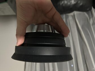

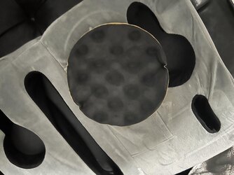

I bought the silicon baffles and they are well made. Maybe once size issue is fixed that would prevent the rattle. Brand was xpaf got em eBay. My 6.5s fit like a glove. I’m assuming they make any size.

I'd probably Dremel that section out and figure another way to attach the speaker grill (glue). Kinda hard to say without being about to see it up close and personal.

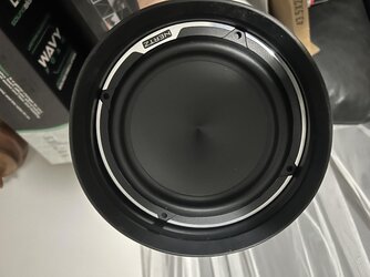

Here is what they look like pre install. To me they seem a lot better than the foam baffles.
