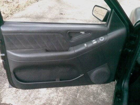

Hope they sound as good as they look! They fit in the factory mounting spot, that's a huge plus. Now I have to figure out what to do with the tweeters. Any suggestions on tweeter placement?
What vehicle? Can you get a better pic of the whole door? Im inclined to say the little sail panel. Drivers side pointing at the passenger right ear. Passenger side pointing at the drivers right ear.
Not my pic but gives you an idea of what Im working with. I've saw alot of tweets flushed mid way between the grill area and the window controls. Not sure that would work well though.
i have my tweets mounted in the area your talking about ,and mine sound good,just make sure you mount them pointing up this was the only pic that i could find showing my tweeter placement
I was waiting for you to chime in. Is your drivers side tweet facing the passengers ear and visa versa? I glassed my pillars for tweets, but they are oversized for the tweeters I have now. And I never completely finished them..so that option is kind of out unless I buy new pillar panels.
how big are the tweeter holes in the pillars.and yes they are pointed at the drivers and passenger.but now i run the es 010 tweets and 2 tweets in each door.one facing up and one down.the ones up are on the tweeter imaging on my xovers.and they get loud as a hell now
