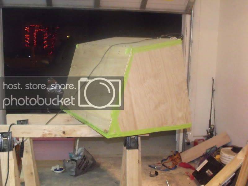

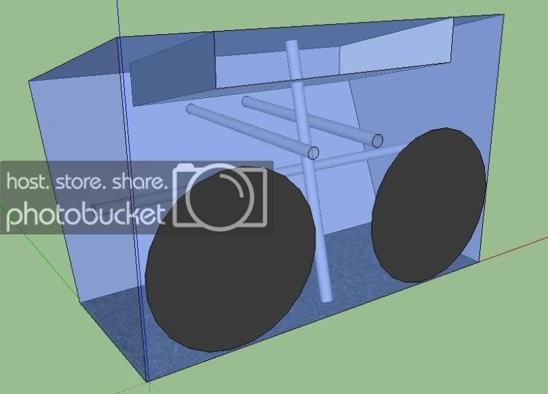

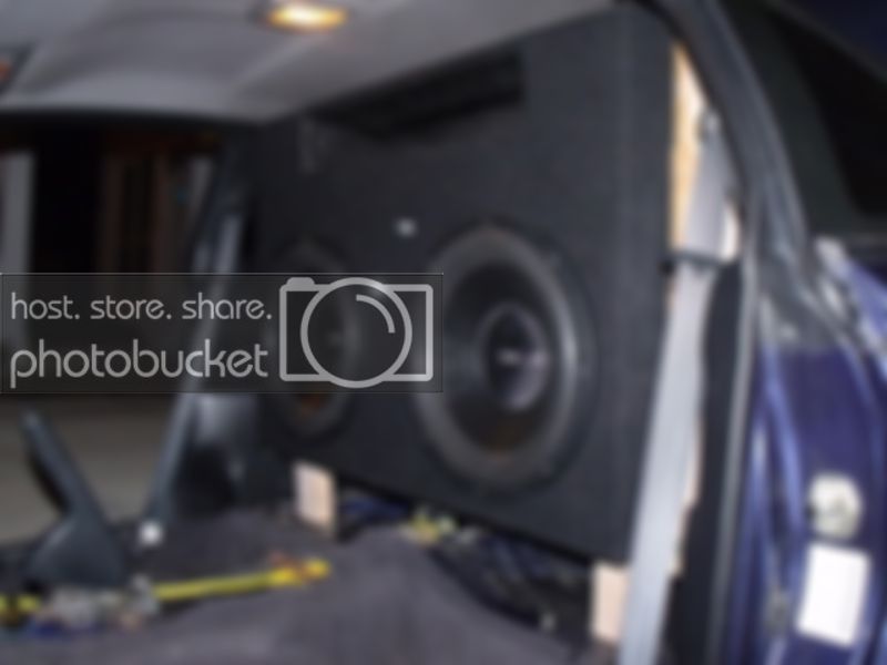

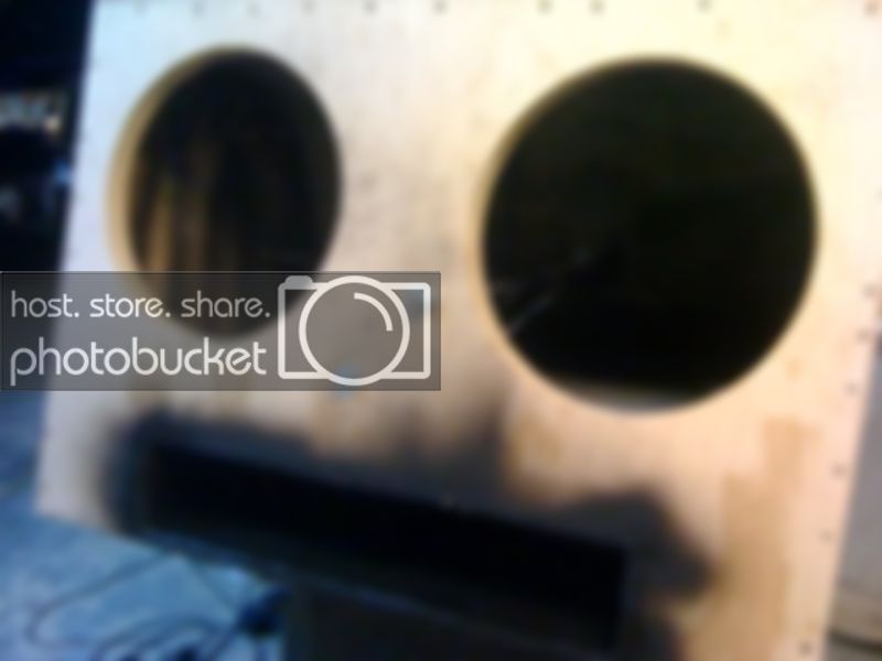

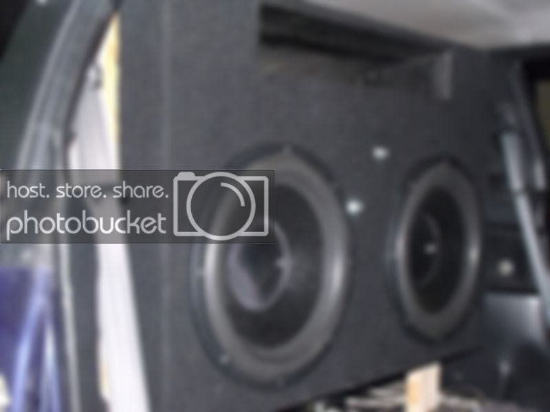

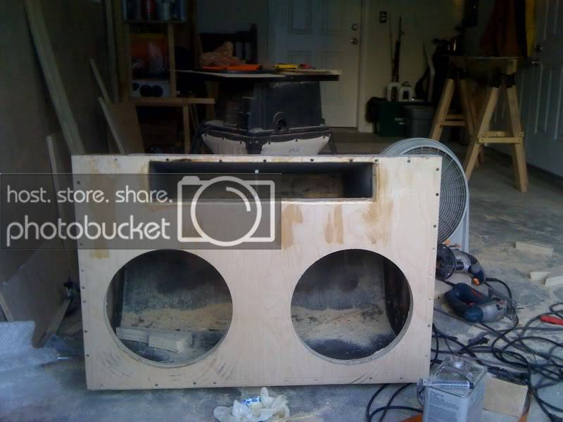

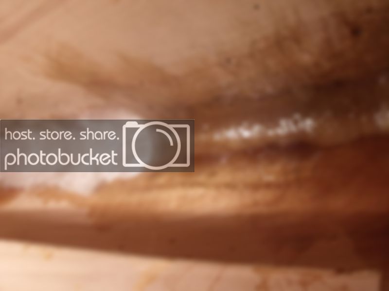

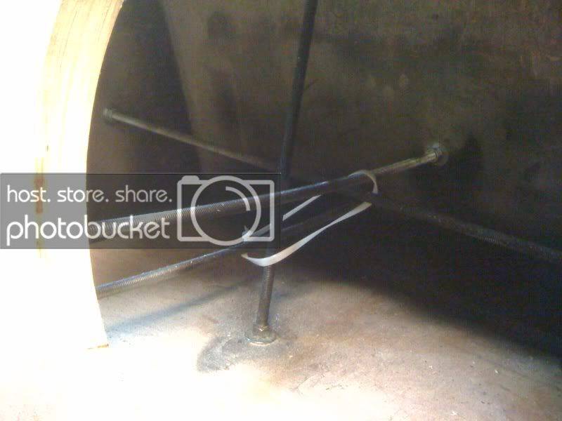

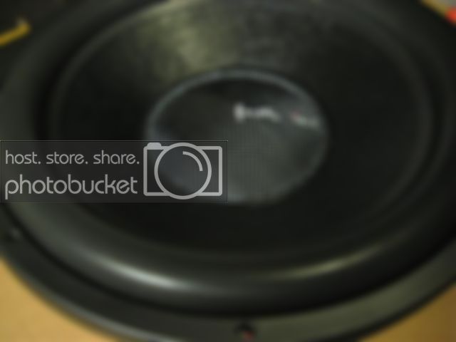

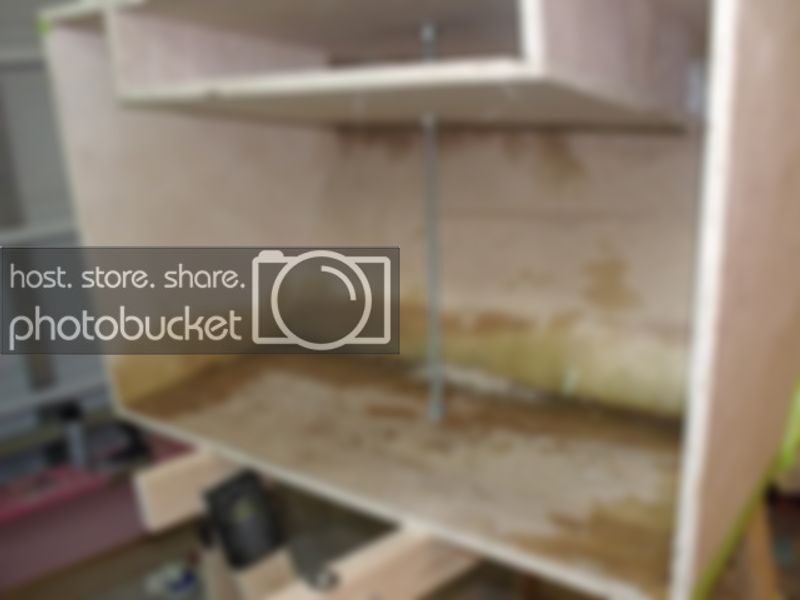

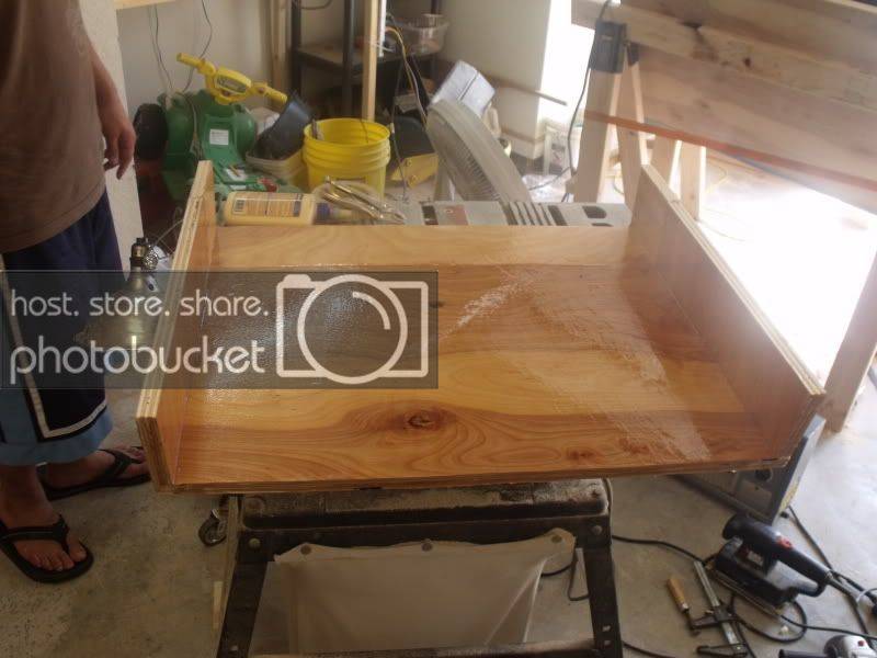

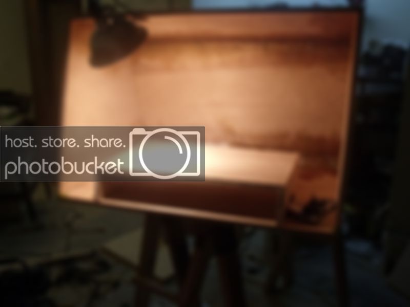

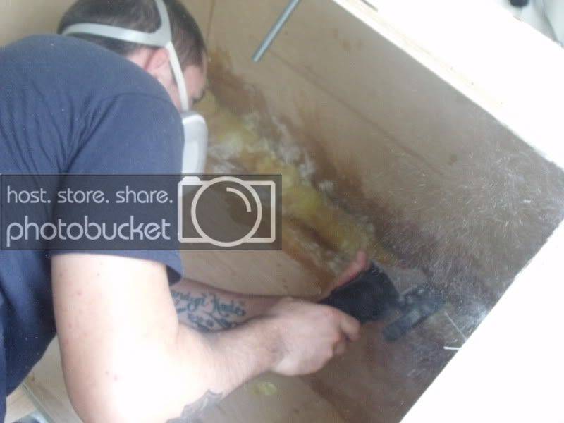

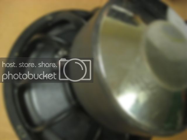

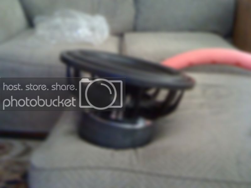

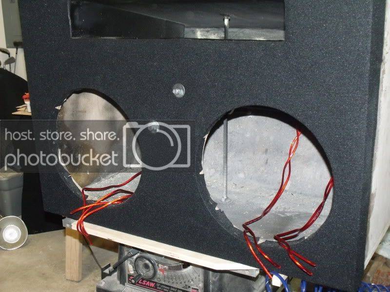

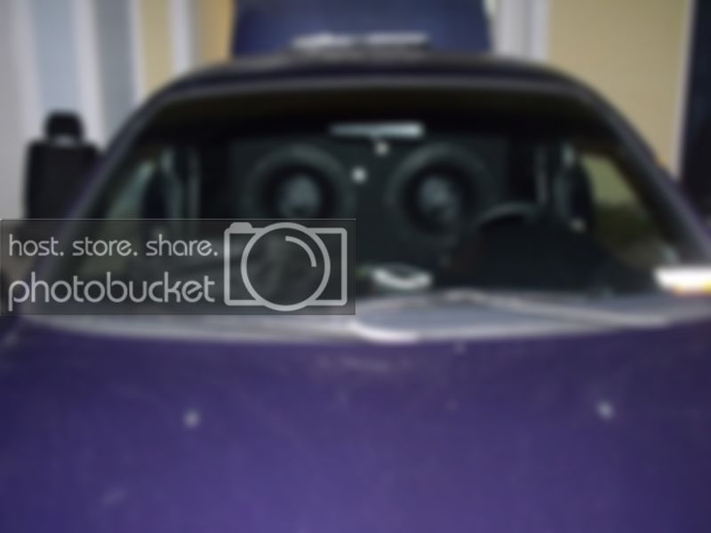

So as a "present" to a friend of mine I decided to do a build for him after a local shop quoted him 4500 bucks for a bogus install //content.invisioncic.com/y282845/emoticons/crazy.gif.c13912c32de98515d3142759a824dae7.gif.Trying to get it done before his deployment the end of next month.He wanted something different and loud. originally he bought two Quantum 15s. those quickly left without ever being installed and changed to a pair or RE/PSI MT 15s. Dual 1.4s //content.invisioncic.com/y282845/emoticons/biggrin.gif.d71a5d36fcbab170f2364c9f2e3946cb.gif.. going on a AP3000d at 1.4 untill cresendo 3ks are back in stock. going with a mechman 220amp alt, two deka 1031 batts. Pioneer component set off a small RF amp. box is 7.62cubes before sub,port and bracing displacement. We did put over 2gallons fiberglass and 3 bags of kitty hair and cloth. turned out pretty good. going to seal up the box tomorrow and pressure check it before installing it in the car. No haters allowed.

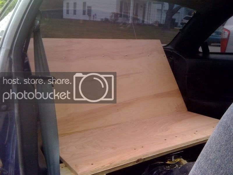

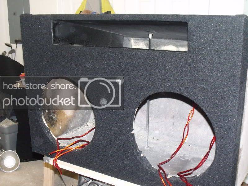

So I am going to mount the subs up tonight to get all the bolt hole locations. Carpet should arrive tomorrow and then the box can go in the car. All I have left then is trim panels, batteries, and hook up the amp
