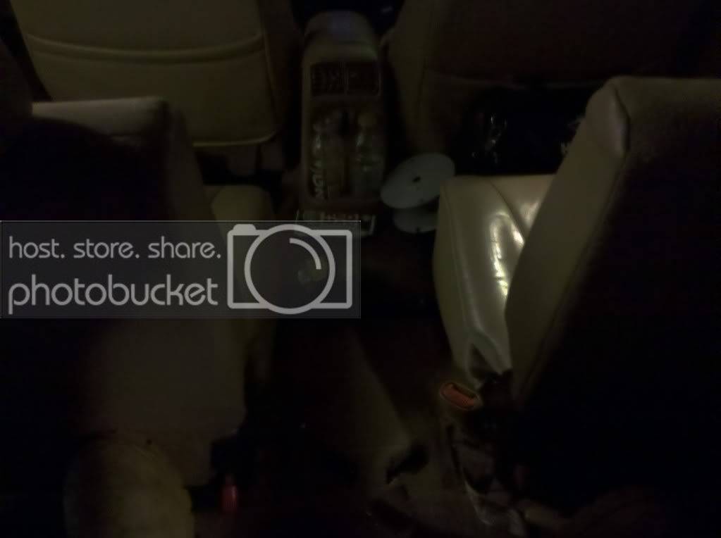

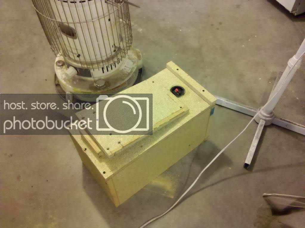

Decided one day the durango would be a little more comfy for passengers if i put a center console in my back seat.
Only tools used are a drill, jigsaw, and circular saw.. So dont criticize too much haha

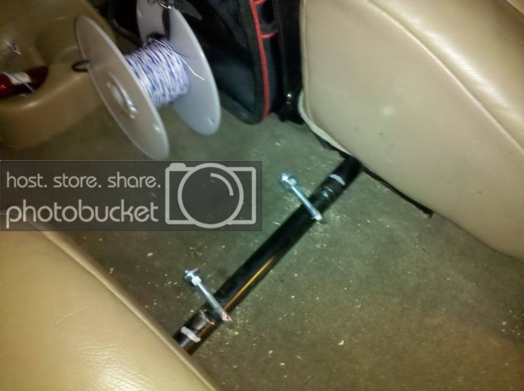

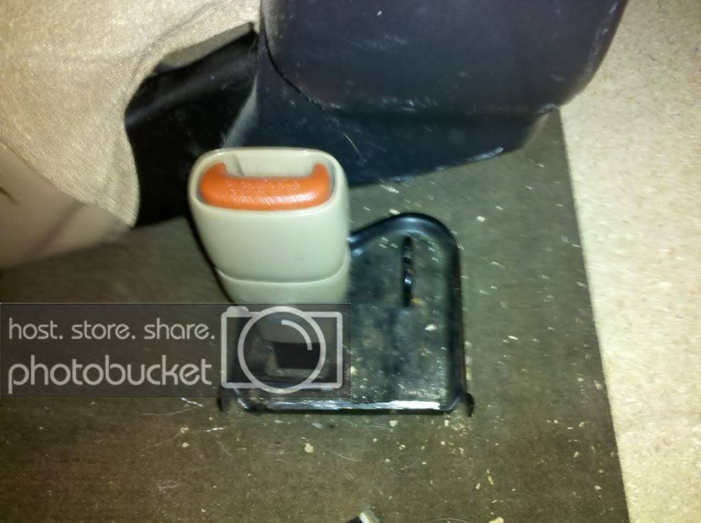

The back of the middle seat bolted to the floor and also had the latch's for the side seats on either side. The front was just welded to a bar that held all three seats down so i just broke it off the front. I cut the back peices off the center seat and bolted them back down so the side seats would latch down.
Front gets held down by U-Bolts

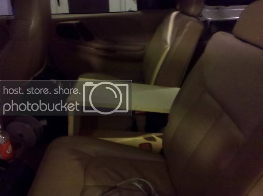

Test fit
Speaker terminal mounted on bottom so all wires are hidden

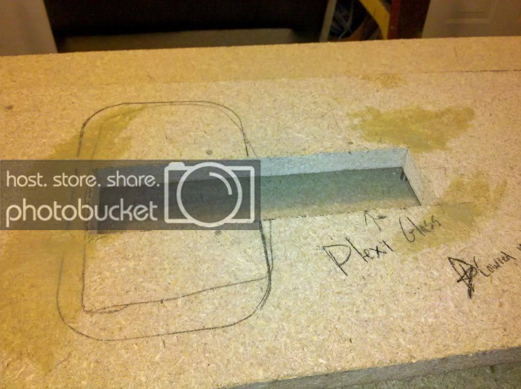

Bolts holding plexiglass in are countersunk and now flat...ish
When all is said and done It will be wrapped with a half in of foam padding, then tan vinyl on top of that. all edges will be covered in 90degree trim painted black so it will match all other interior. Blue LED's inside box to add SQ //content.invisioncic.com/y282845/emoticons/fyi.gif.9f1f679348da7204ce960cfc74bca8e0.gif
