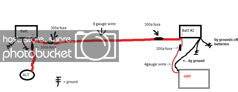

M mlstrass 5,000+ posts Shaggy DOA 10,908 12 Illinois Dec 7, 2012 #31 run 1/0 to batt in back and 4g from rear batt to amp. No reason to run 1/0 to amp since inputs are 4g...

OP Mboyle1145 10+ year member Member 127 0 Houston, Tx Dec 7, 2012 Thread Starter #34 makes sense how about ground ? i might sound dumb but im guessing i will need to ground the second battery to the chasis?
av83 10+ year member CarAudio.com Veteran 3,121 1 Midwest Dec 7, 2012 #35 Click to expand... Yep, or a ground run of 1/0 to the front.
OP Mboyle1145 10+ year member Member 127 0 Houston, Tx Dec 7, 2012 Thread Starter #36 well i did want to do a crazy custom job in my truck for s*#^s and gigs but now im thinking about just going crazy with it and seeing wha happens running another battery to really get the most of the amp.
