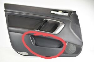

These are my front door panels. The area circled is a door pocket. I believe I could cut that out and glass it. I used to repair all the fiberglass truck body parts for Peterbuilt, so I'm pretty good with glass. I'm not sure if I could fit an 8 there, how is say a 6x9 for midbass? Other size suggestions? And suggestions for 8 inch midbass or 6x9 midbass speakers please in the 50-70 watt RMS range. My amp outputs 50 rms @ 4 ohm and 70 RMS @ 2 ohm. I plan on running the rears off the head unit and using the rear sub channels to power the new midbass drivers.

For your sound stage I would not recommend using different sizes and voices ( brands or models) together. Definitely avoid having them facing different directions ( as in the doors pointing toward each other and in rear deck facing up bouncing off of glass all at same time) as it will distort imaging badly and be out of phase. I would use only the doors for the 6.5s with them turned to where the very center of each cone hits you in a line from both sides, 2is good 4 is better lol . Since you can glass just make the enclosure to SSA specs and aim the MDF rings that you would mount the 6.5's on angled to point them at you directly and not toward each other like factory has them.

horrible idea. Subs are subs, they arent midbass. It'll cause phase cancellation even with crossovers and the midbass will be extremely muddy. Stick with actual midbass drivers.
For your setup. Leave the rears on head unit power. Add the dayton dsp, Get rid of the passive crossovers on your front comps and Run the focals on active with your current 4 channel amp. Add a cheap 4 channel amp and bridge the amp to a pair of crescendo pwx 8s (they'll handle all the power and more and 4 channels bridged is cheaper and more powerful than a big 2 channel amp.) So dsp channels 1/2 is tweeters, channel 3/4 is the 5.25 inch mids, 5/6 is the 8 inch midbass, 7/8 is the subs or you can leave the subs connected to the head unit rca outputs, either way works.

I believe I see what you are saying, though the focal 5 1/4s are in the rear, front are 6.5 jbl gx components. So you say glass the front panels and add 8s with the 6.5's? My only issue with that is the I'm not sure what ohms my tweeters are or the power they can handle, but I have an idea they can't handle what the amp would send them on their own. What is the rule of thumb on amp size vs power wire size? My current amp requires 2 power wires, they are small, likely 10 gauge or so. I ran a fused 4 gauge to the amp and used a block to split that into 2 connections. Trying to figure out if I really need to run another large power wire back to run a second small amp.

oh my bad then you'll be doing what i said with the front JBL comps. Always have more power than you need because if you dont have enough power and you try to get loud, you'll be clipping the signal and blowing up the drivers from a dirty signal. What you think is the driver's limits right now is actually your amp's clean power capability limit. Just for reference my tweeters are 80 rms, i'm using 145 rms to them and they love every bit of it because I never get close to clipping and i get the output/SQ i want.

Those sound excellent, I will keep them in mind if I decide to run 8 inch midbass, or if I blow these jbl 6.5s up. Im sure I could carve the door panel out a little bit to squeeze 8s in there if I tried hard enough. Factory grills would be a limiting factor though. Alright. What amp would you suggest to run these 6.5 comps, keeping in mine that down the road I may upgrade to those 8s. Also, how do I setup my comps with the additional power? Going by the rms rating of 70 watts, its easy to pair a 70 watt rms amp to them and call it good. Basically, how do I ensure I don't overpower them too much? Next question. Since these are my midbass drivers, do I leave the full range? My head unit and amp only have options for a high pass filter on the front lines, but running that dsp I could limit the upper frequencies and let the tweeters fill those in, or I could do a bandpass I guess and cut out the low bass and the high frequencies. Whats your suggestion there? And finally. New amp to the 6.5s, current amp will power the sub on the 300 rms channel, and the tweeters on one of the 50-70 rms channels, but that leaves 2 amp outputs open. Do I power the rears or what would you suggest I do with those?
