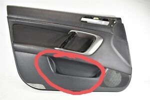

These are my front door panels. The area circled is a door pocket. I believe I could cut that out and glass it. I used to repair all the fiberglass truck body parts for Peterbuilt, so I'm pretty good with glass. I'm not sure if I could fit an 8 there, how is say a 6x9 for midbass? Other size suggestions? And suggestions for 8 inch midbass or 6x9 midbass speakers please in the 50-70 watt RMS range. My amp outputs 50 rms @ 4 ohm and 70 RMS @ 2 ohm. I plan on running the rears off the head unit and using the rear sub channels to power the new midbass drivers.

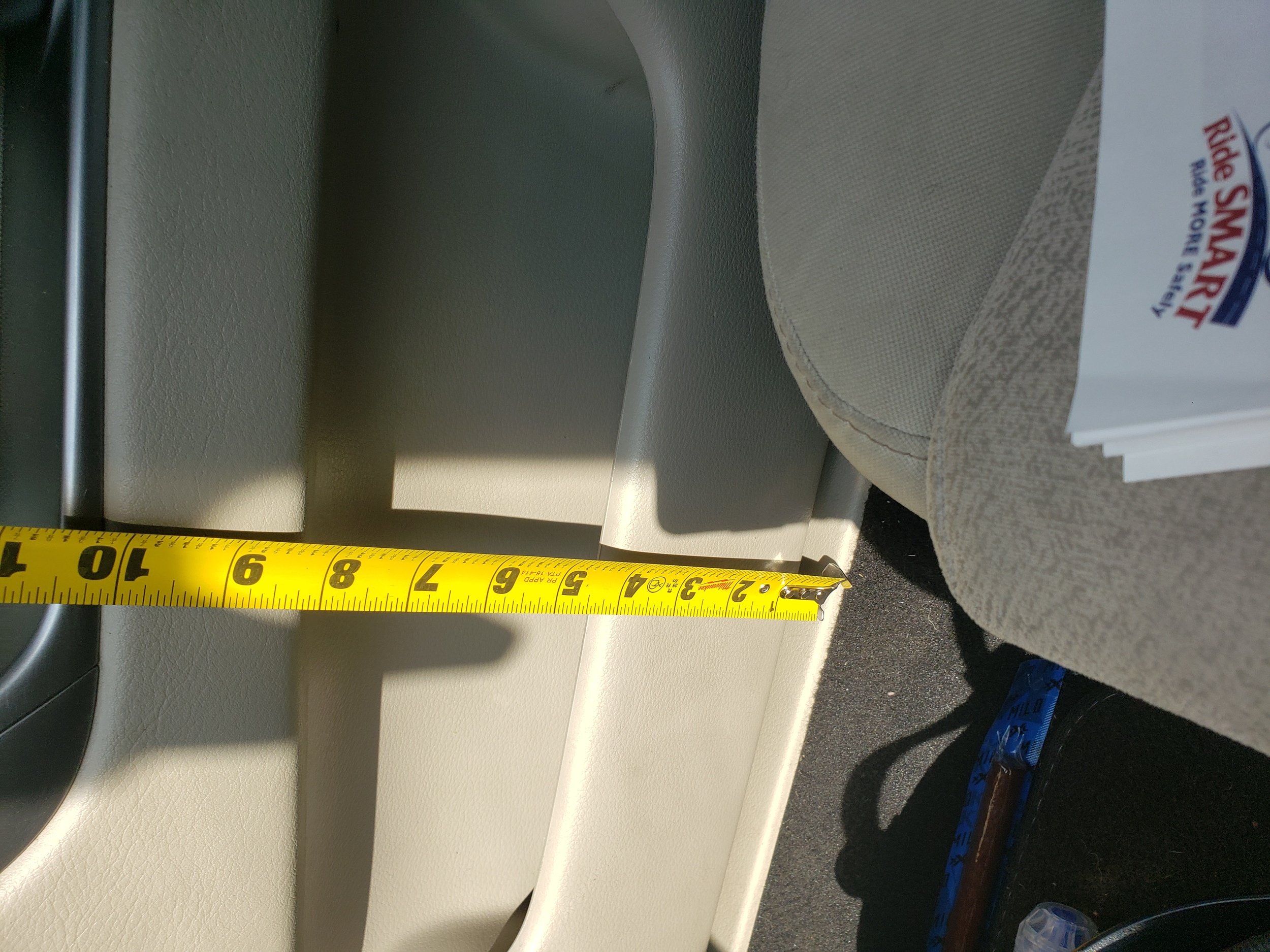

After measuring an 8 would be extremely tight. The bottom of the panel to the part that sits under the door handle is just a hair over 8 inches. I think it could be done, but it would be close.
