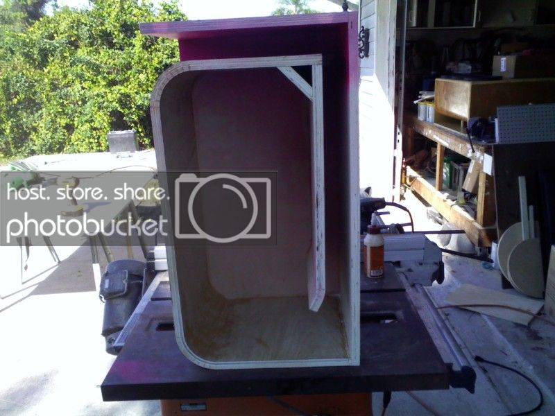

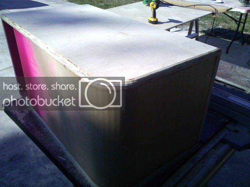

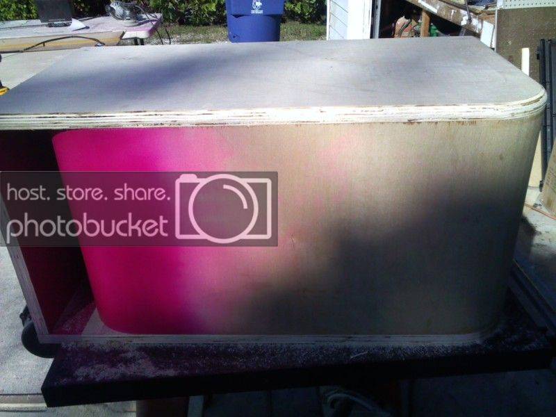

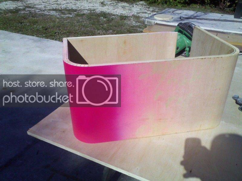

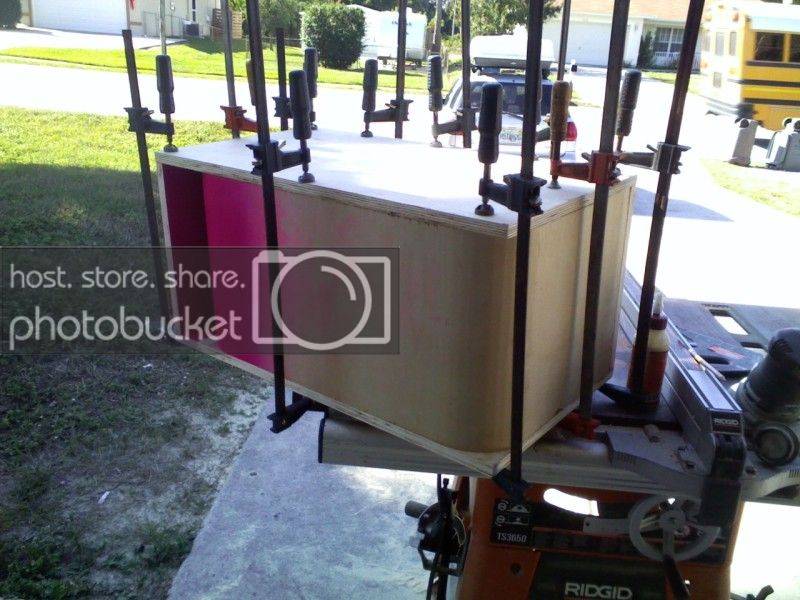

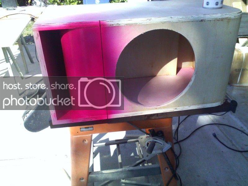

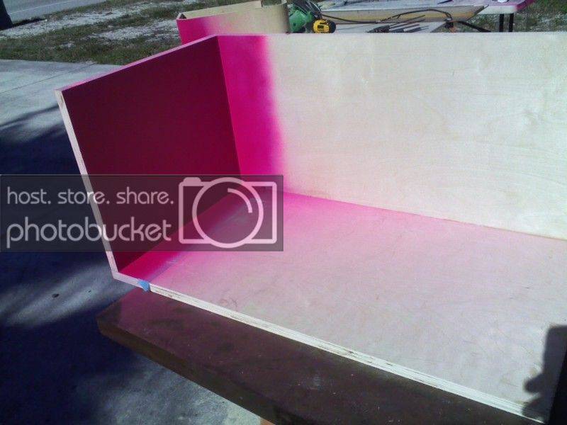

My boy Donnie is putting together a small system for his wife for xmas and she's been bugging him for a pink kerfed port box:
how well does that birch take a kerf? i just built a kerf box with that panel being mdf, i wasnt really sure how well birch would do with it.
looks really good by the way.
it's not too bad to work with for kerfing. mdf is much easier though
Looks awesome.. but is the top part of the port wider than the right side after the turn? Looks like it unless its the angle playing tricks. lol
thanks man, and it's even, I measured twice lol
Looking good. If anyone's having trouble with curffing the birch face tip that I've found helpful is cut it like normal and get it wet. The water won't ruin the wood as long as you dot soak it for a long tune. I've even done it would out cutting in the curfs but putting a brick in the center while in water
