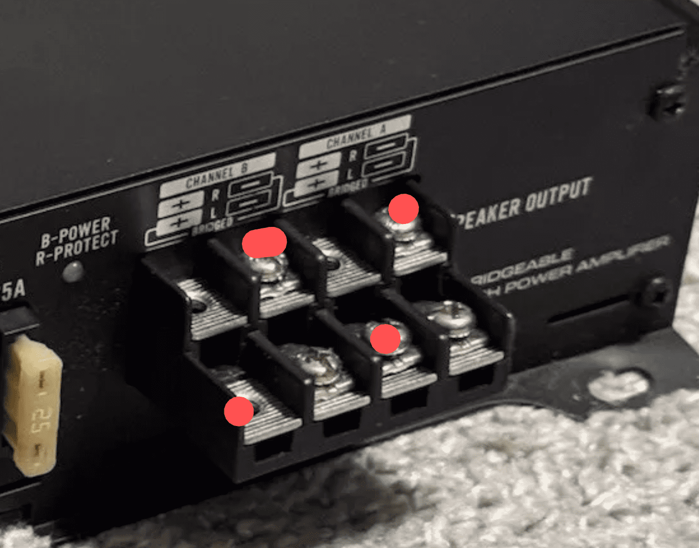

You will have to set your subs to 4 Ohms. The red dots are where to wire the subs. The amp is marked with the polarity.

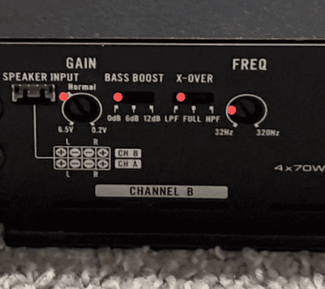

These are the x-over settings. You will do this for the other side as well.
Yea I had the woofers on 2 ohms and I had a tied into the amp on the top four I didn't Bridget so I had it all wrong I really appreciate the help mani hope to get on it today and let you know I make out
