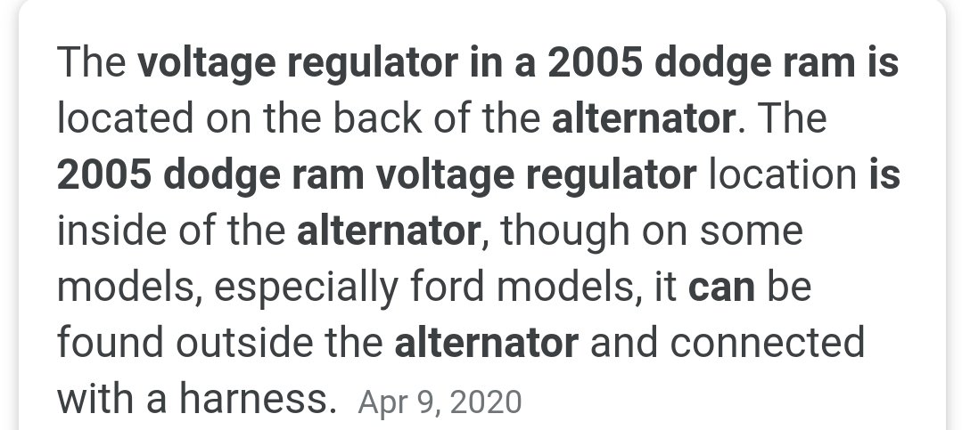

Yes, the voltage regulator is internal on my stock alternator.
