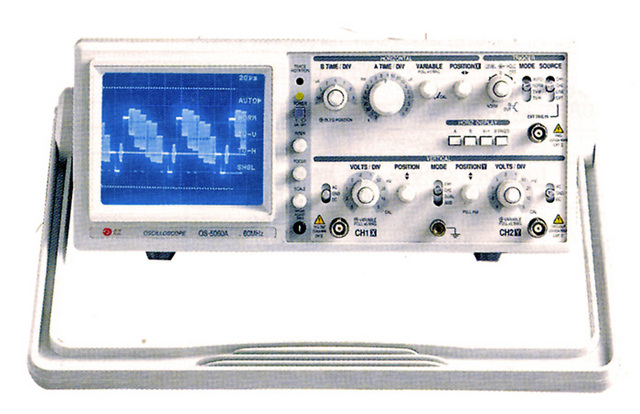

nah mines analog, its not ancient, not brand new check it out
