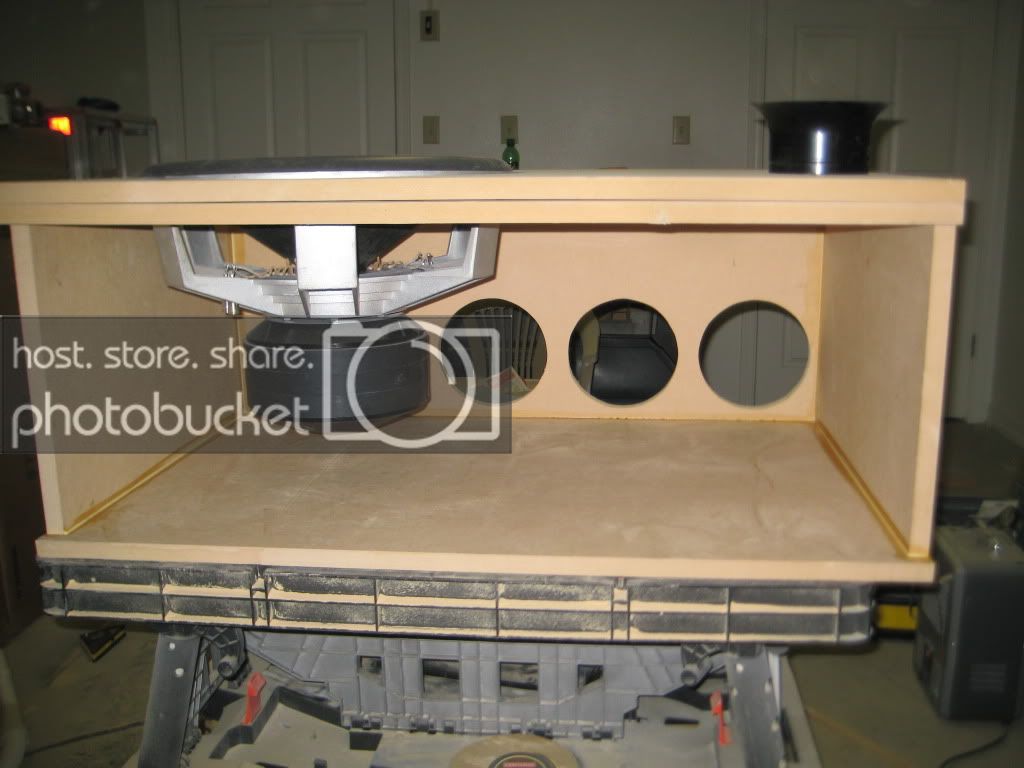

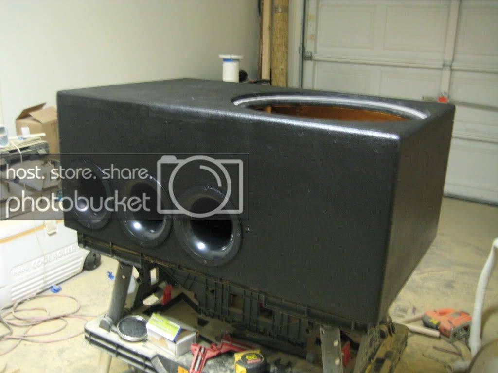

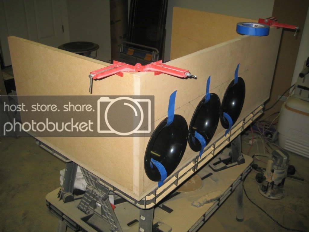

right hurrr.....few updates....got all the wood cut...probably going to start gluing tonight....here's a mock up pic:

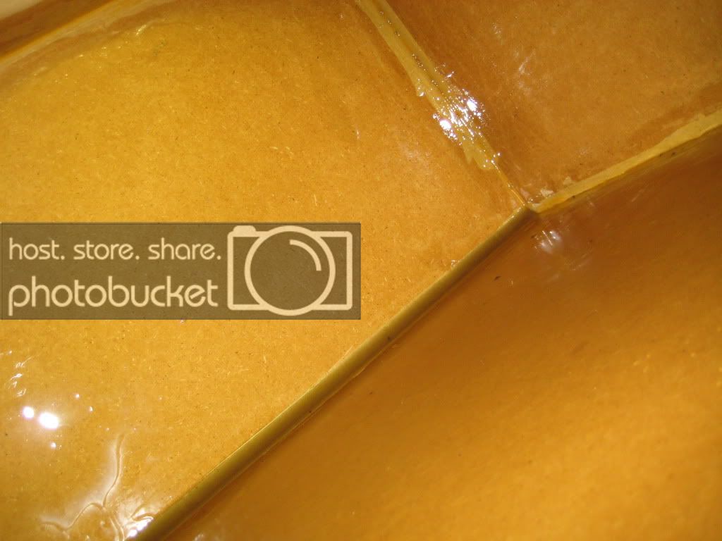

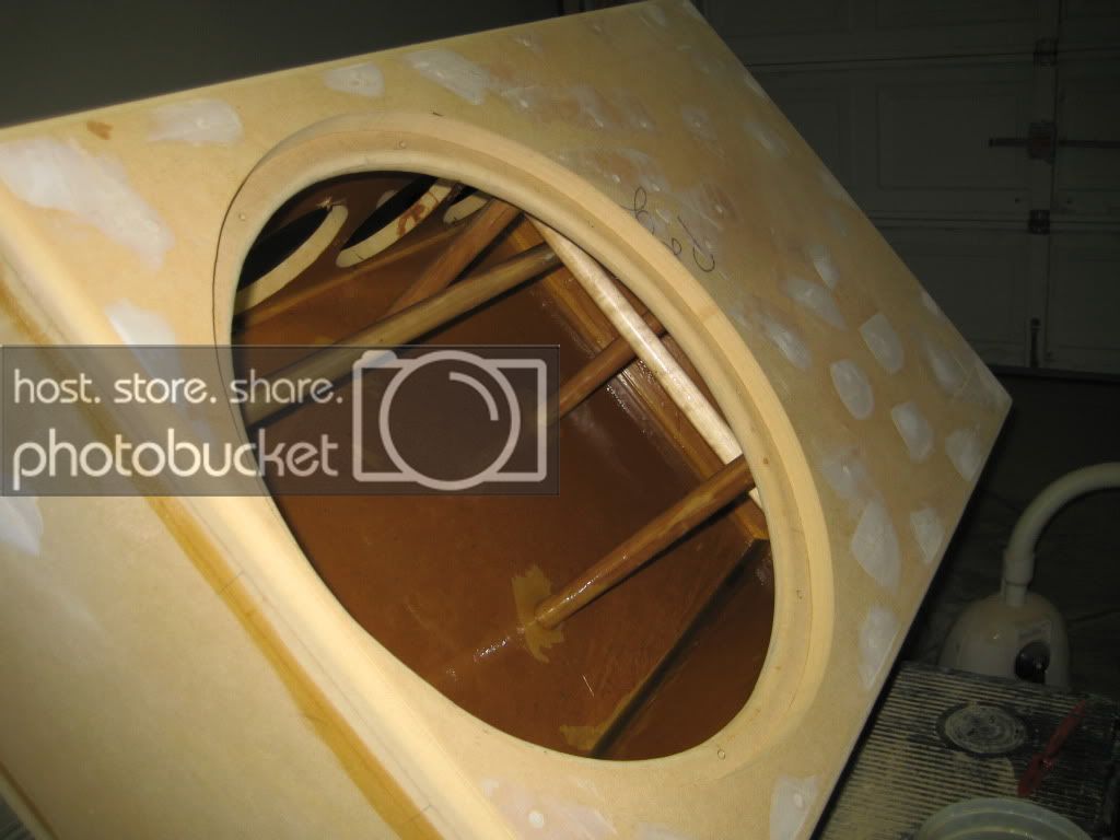

I really like the door panels, I would like to make some for my van. I see that you have resin inside the sub box, what is the main purpose for that?
Nice build, keep the pics coming

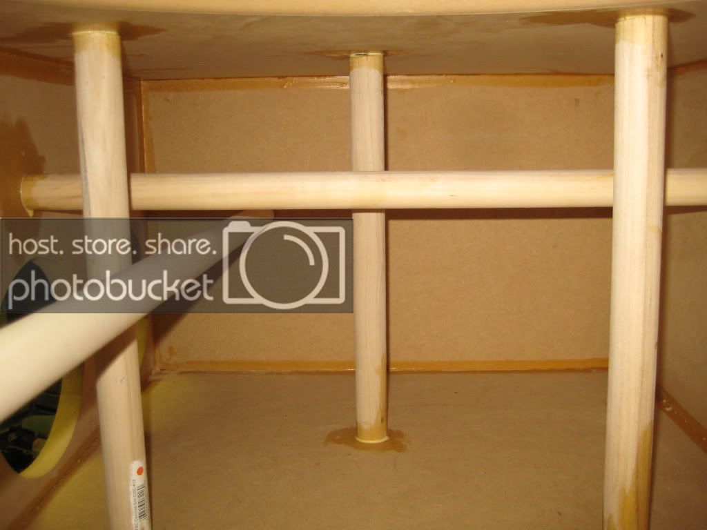

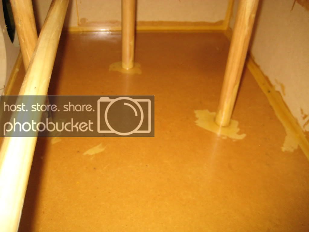

Thanks man. I resined the inside of the box to seal it up real good and add a little more structure/strength. Thing is like a brick now..lol
