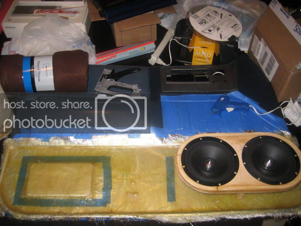

Finally starting a build log on here. Haven't taken many pictures but i've pretty much ran all my speaker wiring for my front stage and all my rca's and 2 runs of 1/0. Right now i'm working on my door pods so i'll post up my progress so far. This is my first time at doing door pods so it's a learning process, but i'm pretty happy on how they turned out:

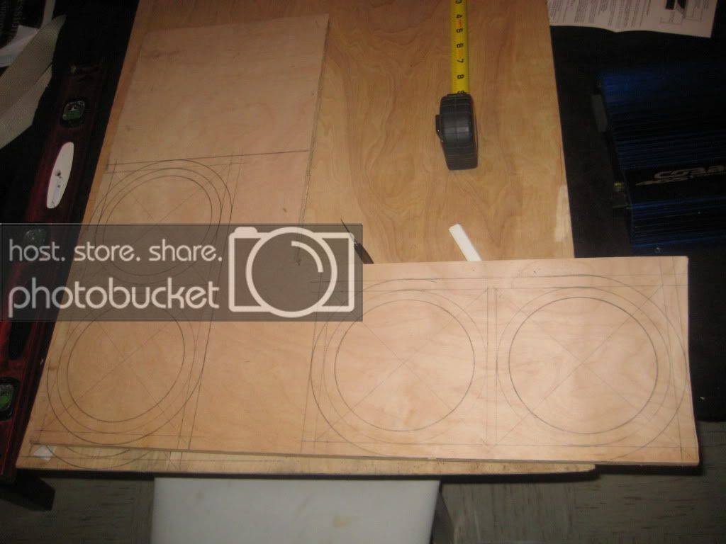

template drawn up:

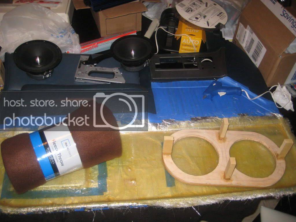

getting the doors ready for some glassin:

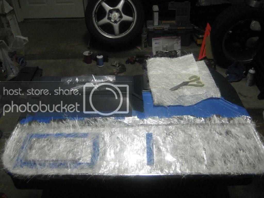

fleeced :
(put a couple layers of resin and some mat on the outside and cloth on the inside but forgot to take pics)

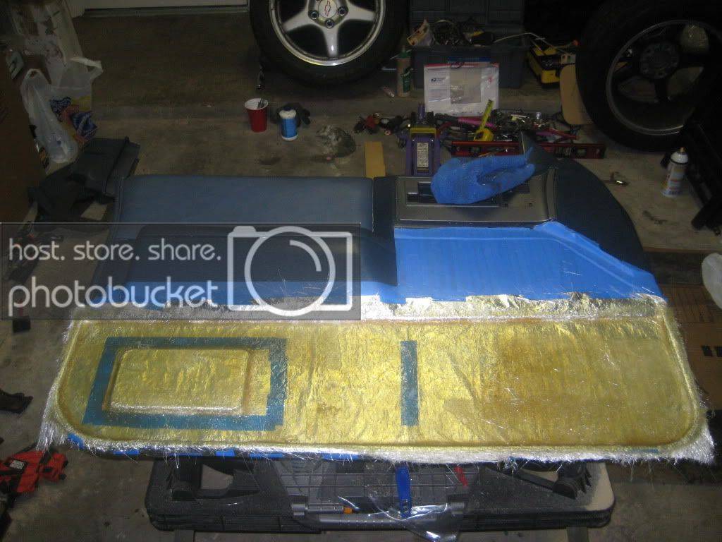

then put body filler on top of that...

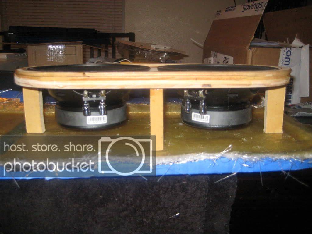

got tha hookah ready and sanding down the body filler:

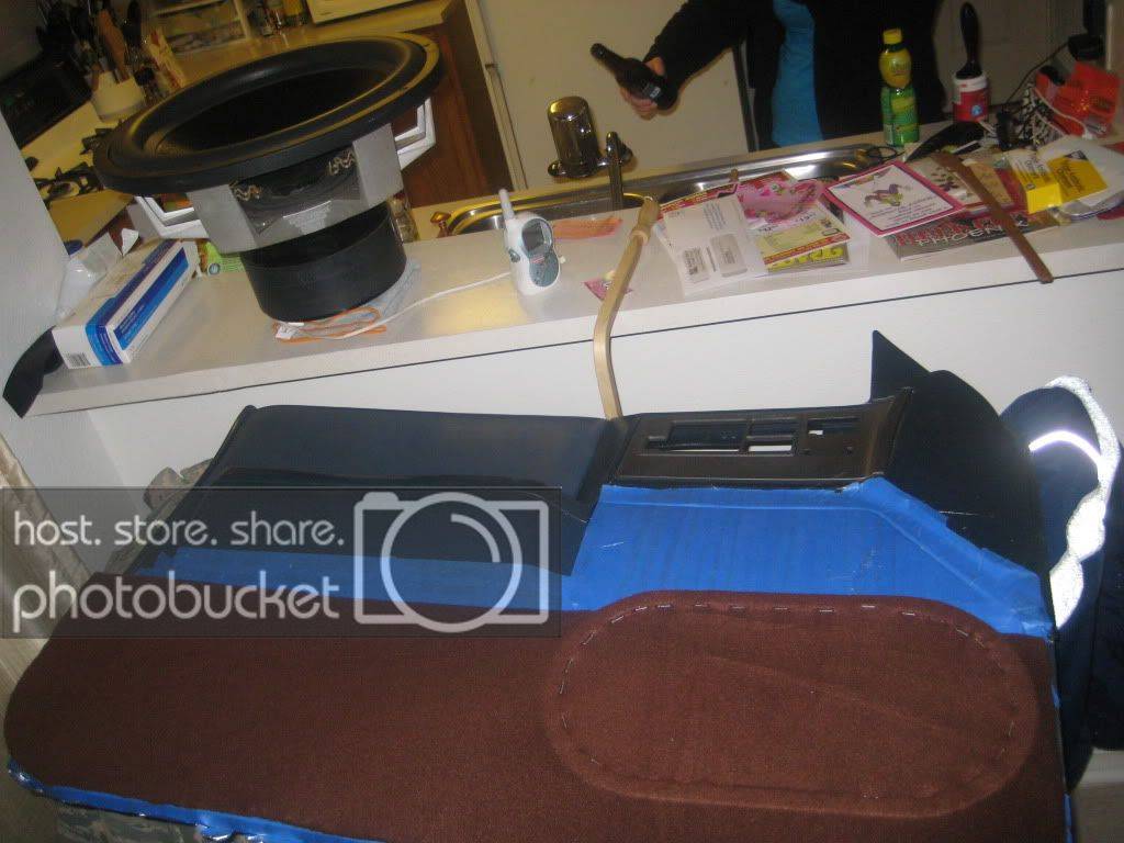

some milkshake on it:
sanding...putting my gas mask to use..haha:

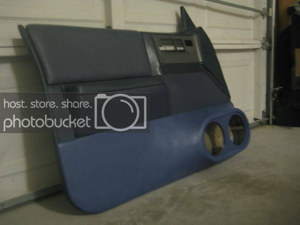

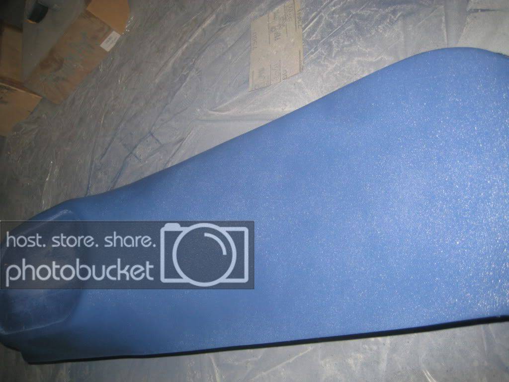

then sprayed with primer...couple coats of texture...then blue on top:

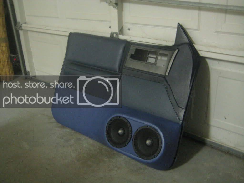

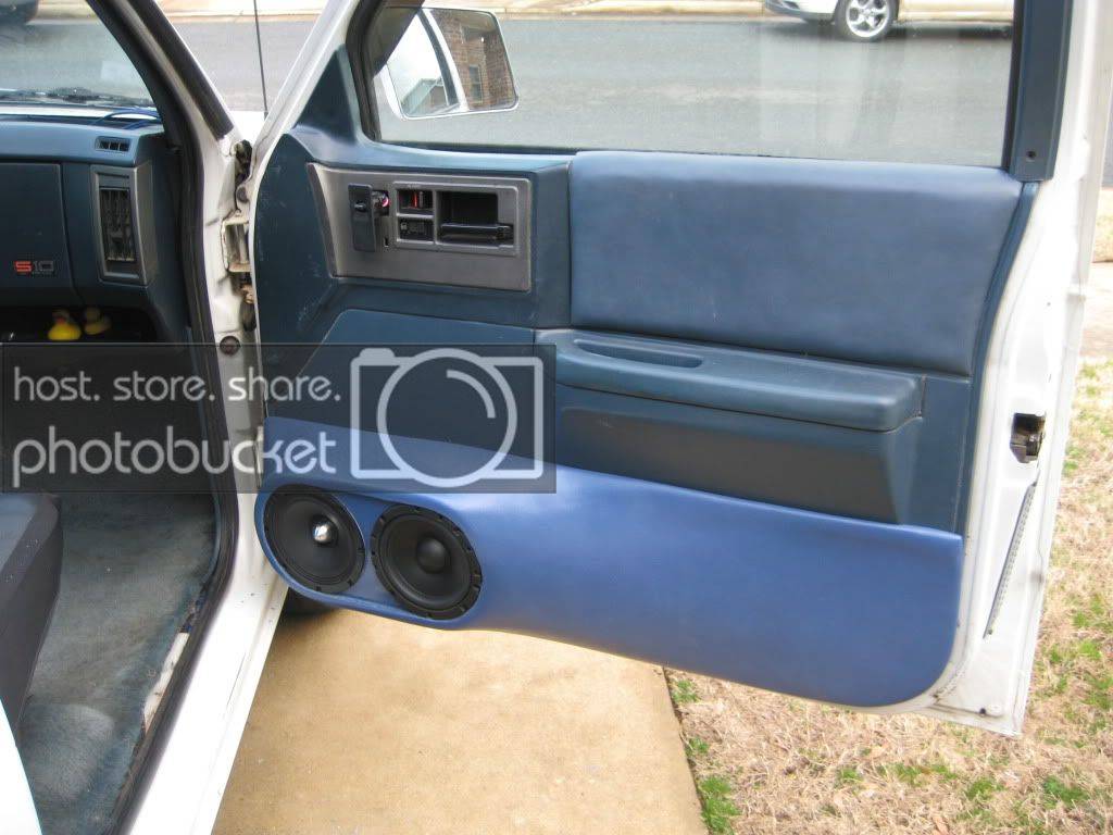

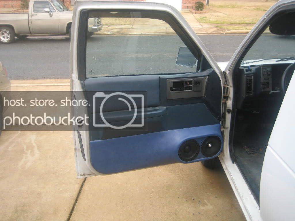

test fitted on the door panels(the blue came out a little brighter than i liked but oh well):
those are big as shit. lookin good tho.
yeah i had to build em this way because of how they were before...wish i took before pics so you could see but the door pocket that was there before extended all the way across as one piece
and thanks! //content.invisioncic.com/y282845/emoticons/smile.gif.1ebc41e1811405b213edfc4622c41e27.gif
i know how it looked, i have near the same door panel //content.invisioncic.com/y282845/emoticons/smile.gif.1ebc41e1811405b213edfc4622c41e27.gif They looked a lot bigger off the door then on!
Those do look nice. Are you planning on making grills or leave em open?
leaving them open for now....hopefully they don't get in the way or get kicked...we'll see

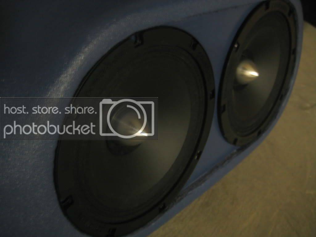

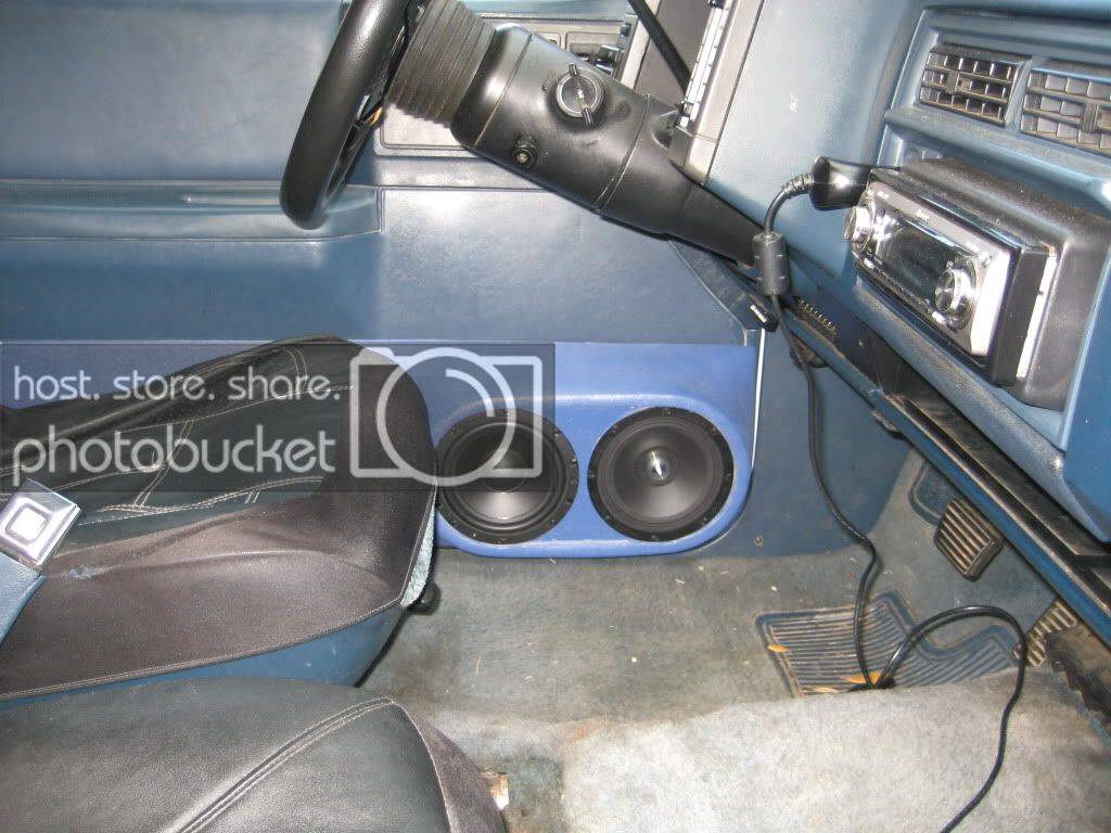

just picked up these today...digital design 6.5's(thanks dave!) (component set...you'll see the tweets when i get glassin the pillar pods). thinking of running em like this:
got em installed:

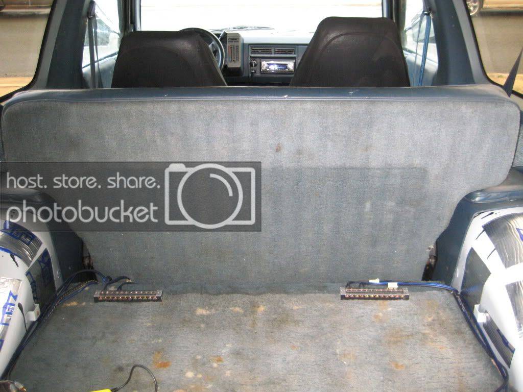

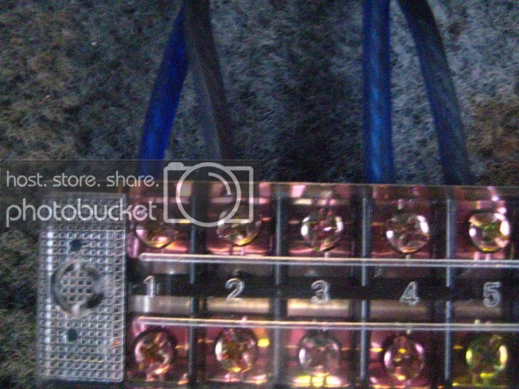

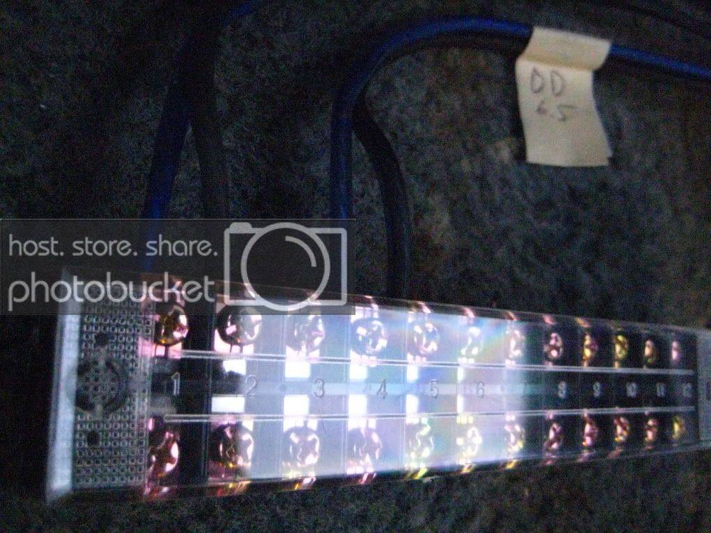

wired up to my distro boxes in the back (got em off ebay)

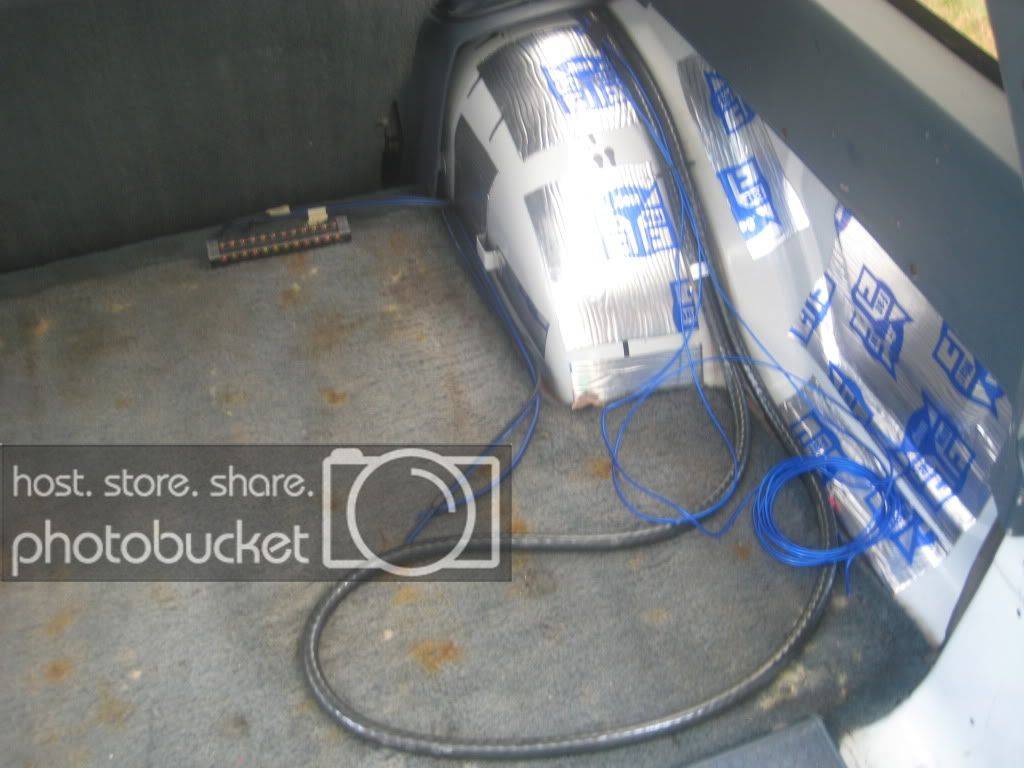

2 runs of 1/0 and remote wires (haven't cut em yet...still wondering where to put my batts)

How do you mount the fiberglass onto the door panel?
i almost took pics of how I did it cuz I knew someone would ask..lol but I drilled pilot holes through the backs of the door panels and into the fiberglass pods and screwed them together from the rear.....hehe
